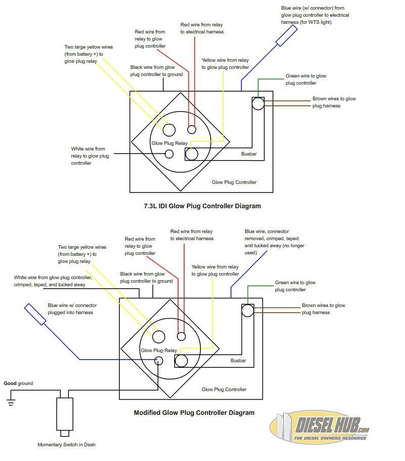

I just mounted mine next to the starter Relay on my 93... I use manual control, I don't even have the OEM controller installed anymore.

IF you are trying to use it with the controller then you will find it easier to remove the controller first and then do mods to make the Stancor bolt to the controller and you will have to bend the Shunt Bar as required.
this shows OEM wiring and modded for manual control.

the buss bar has to be there for the controller to function it is for current sensing for the controller... if current is not sensed between the Green and yellow wires the controller will not function properly.
it's been at least 20 years since I have repaired any of these controllers But IF I remember right .... what generally happens when the Grn and Yellow wire are disconnected is that the controller fires the relay and when current is not detected it disables the relay.. this happens real fast, and also the correct plugs must be installed because they are used as a PTC sensor for After Glow and if the resistance in the GP Circuit is incorrect you get stupid stuff like constant cycling of the Relay.... The Controller also has Thermal sensor inside of it too... one day I'll dig up my old schematics from where I Reversed engineered these controllers and maybe post a schematic, because I don't think there are any floating around the Internet.
So to answer the question... it's possible the controller could be damaged by not being connected correctly ... try hook it up as it should be.... also I'm not sure what the coil Resistance is on the OEM relay and if the Stancor which is 21 Ohm is compatible with the Controller ..... this is why I went the Manual route when I did mine and that was at least 15 years ago.

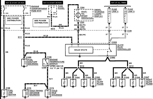

figure 17 from the run switch terminal... it passes thru the firewall connector to the engine harness
I've seen the wires fry at that Engine connector a few times in the past.

here is another schematic of the system ...
now IF this is on your 1984 IDI that is in your profile then it's hard to say how someone Wired your truck

Fuse link C and D are on the starter Relay Battery terminal... I don't think that is your problem as you have Fire on the Glow Plug Relay Large terminal... the problem seems to be from the Ignition switch the Red/LtGRN wires that go to the small Rectangle Engine connector ... I know the Van wiring is a bit different... but not so much for the GP system.
