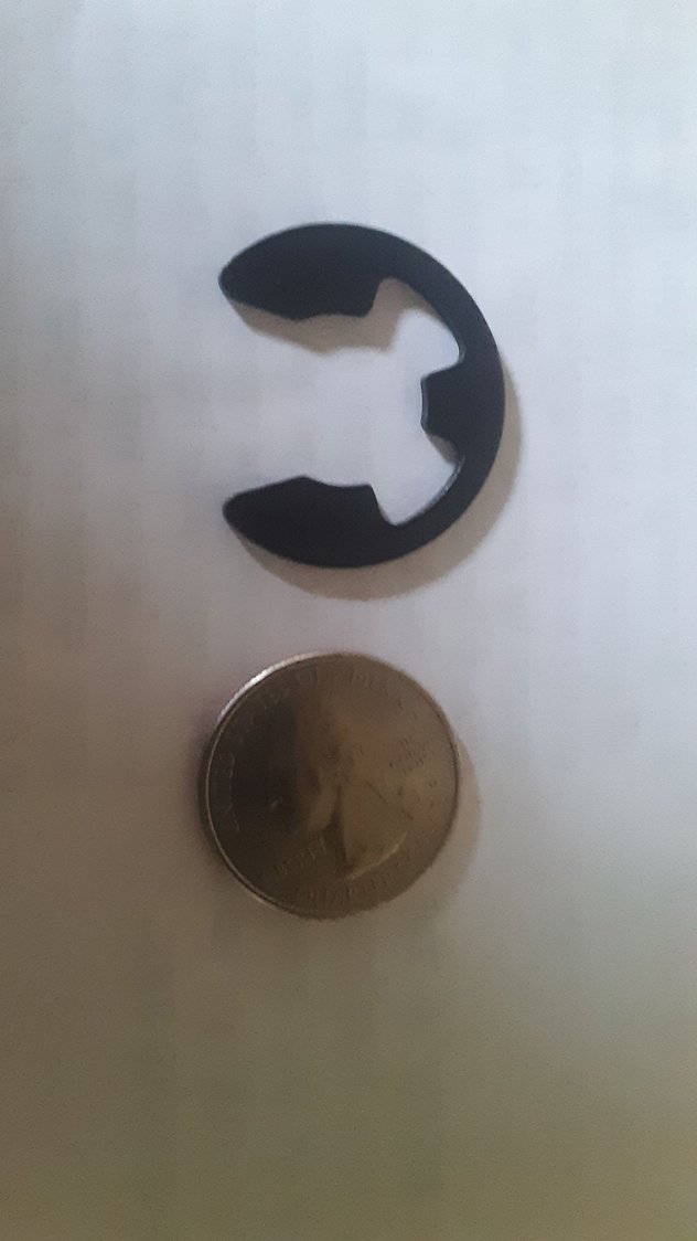

I found this under where I park my truck. Anyone know what it is? I recently had ball joints done by a mechanic and have a very long list of items I have done myself on the truck over the last several months.

Looks like a retaining clip from a door hinge pin maybe?

isn't that the retainer for the kick-down linkage? I recognize it, but I can't recall from what part it comes.

Check where Genscripter suggested. It's a C clip and they retain throttle linkage, cruise control linkage and the like. Whatever they retain is usually important. Of course maybe a mechanic dropped it somewhere around the engine, couldn't fine it and went and got another and it finally fell on the ground, been known to do the same thing myself.

Ok, my truck has a manual T-19 transmission, so it probably isn't kickdown. I'll check the mechanical linkages though and see if I can find anywhere it might be retained. I checked the doors and don't see any evidence of anywhere that clip could fit.

not a door hinge pin part, but it may be from the key cylinder. some use a clip like that to hold the rod clip on the back of the key cylinder. throttle cable clip, or cruise control cable clip is my guess
