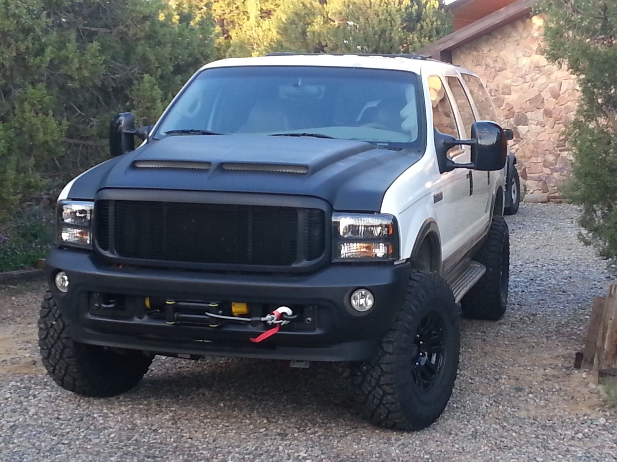

I second the OK... I have had 2" spacers all around to allow 35" tires with a 2" leveling for five years / 50k miles now. No problems. Buy quality units. The rear was NOT able to take hubcentric due to the floater hubs.
There are too many urban legends about these things. Nobody's gonna run an X as hard as a 'vette. Although I did have mine to a c-note one time. I didn't know we had rev limiters on these. -
