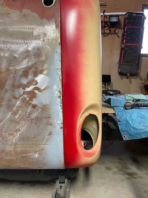

I've been working on the body of my 54 to prep for paint. When I bought my truck it came with an extra driver side door. The original door is in bad shape with dents and rust. None of the doors were on the truck. Following advise I got from some of you here, I'm test fitting everything before body work and paint. Today I found that the replacement door is too wide. About a foot of the front edge and a greater amount of the rear edge will need to be trimmed and then weld/grind the exposed edges. Has anyone done this? Any advise on the best method to weld? My welding skills are not the greatest on thin metal.

The truck was in pieces when I bought it. The PO had a body shop work on the cab. It was in primer accept the interior, firewall, and door & window frames are finish painted. As best I can tell, they replaced the rockers and patched or replaced the lower cab corners front and back. The door pillar with the hinge pocket seems to be original. The interior cab body mount brackets were new. I had to drill the mounting hole when mounting the cab. Floor seems to be original.
When the door is placed in the opening (with hinge bolts loose), it can't seat inward where it belongs because portions of the front and rear door edges are wider than the opening. On the front edge a section about 12" long will need to be trimmed. It's about mid way between the hinges. The same is needed along the rear edge but at a lower level. Once the trimming is done the metal skin will be split at the fold as you described Steve.

The picture you posted is very deceiving to me, how much needs to be removed from the door front and rear edges for it to fit in place ?

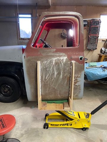

Made some progress. Started by rigging a hanger method to hold the door in place so I could actually see what was happening. Made some tapered wood wedges to slide on the hanger so the door can be raised/lowered slightly. Then removed the hinges (thanks 52 Merc) and hung it in place. Right away it looked better than before when I was trying to fit it with multiple hinge adjustments. I was able to get the door in place accept for the lower rear edge. Previously it had also been hinge binding on the cowl post. The front edge gap isn't as bad as first thought. Between the hinges the gap still needs to be widened about a heavy 1/16th.
I made 1/8" thick steel shims for each of the door side hinge faces. This positioned the door outward a bit. It eliminated the binding at the cowl post and aligned the door with the plane of the cowl post.
With the hinges back on loose and the door supported on the hanger I was able to pry it around to get a reasonably good fit. Then tightened the hinges. It took several attempts before it held the right position. Despite replaced hinge pins, the weight of the door causes some sagging.
The edge of the door at the bottom rear will need to be trimmed and welded. Now at least I will be able to grind/trim a little at a time while testing the progress by easily hanging the door in place during the process. I found this "how to" article on the Hot Rod network. https://www.hotrod.com/articles/one-...s-1969-camaro/ I'm going to give it a shot.

Good progress....my guess is the PO replaced the rocker panel without properly supporting the existing opening and then when they welded in the new rocker panel the opening shifted and pulled in.
You'd have to trim both sides if you go this route since looking at your last pick it appears that the bottom of the door is lower than the cab since your assuming the hinge post is positioned correctly and that is where you shimmed. My guess is the hinge post and the striker post are both pulled in equally.
