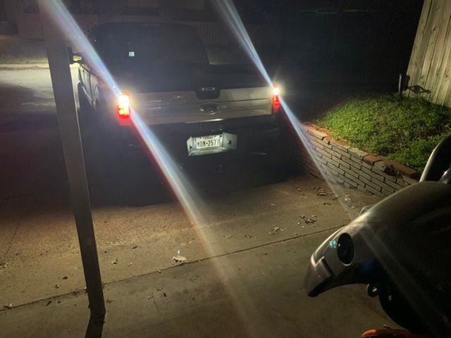

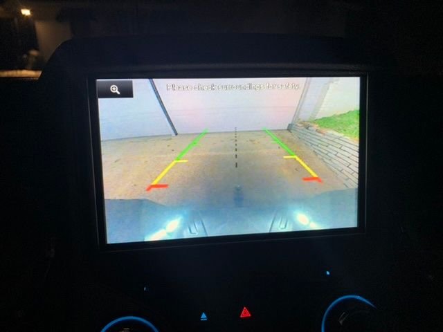

Haha! I truly do understand. I will snap a couple of pics here in a little bit once it gets dark to show you how bright they are.

I completely forgot to take these pics the other night! Here ya go!
