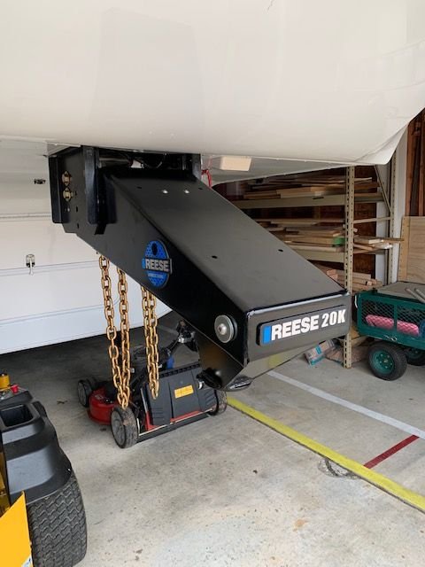

This is my new hitch to utilize with the fifth wheel prep package. I didn't get a goose neck ball with it but I did get the ball and safety chain hook kit with my previous truck, which did not come with my new truck as the kit is a separate option for a 350.
Glad I kept it as it came in handy with the Goose Box. Now all I have to do is take out a 5 pound ball and I've got my truck bed back.
