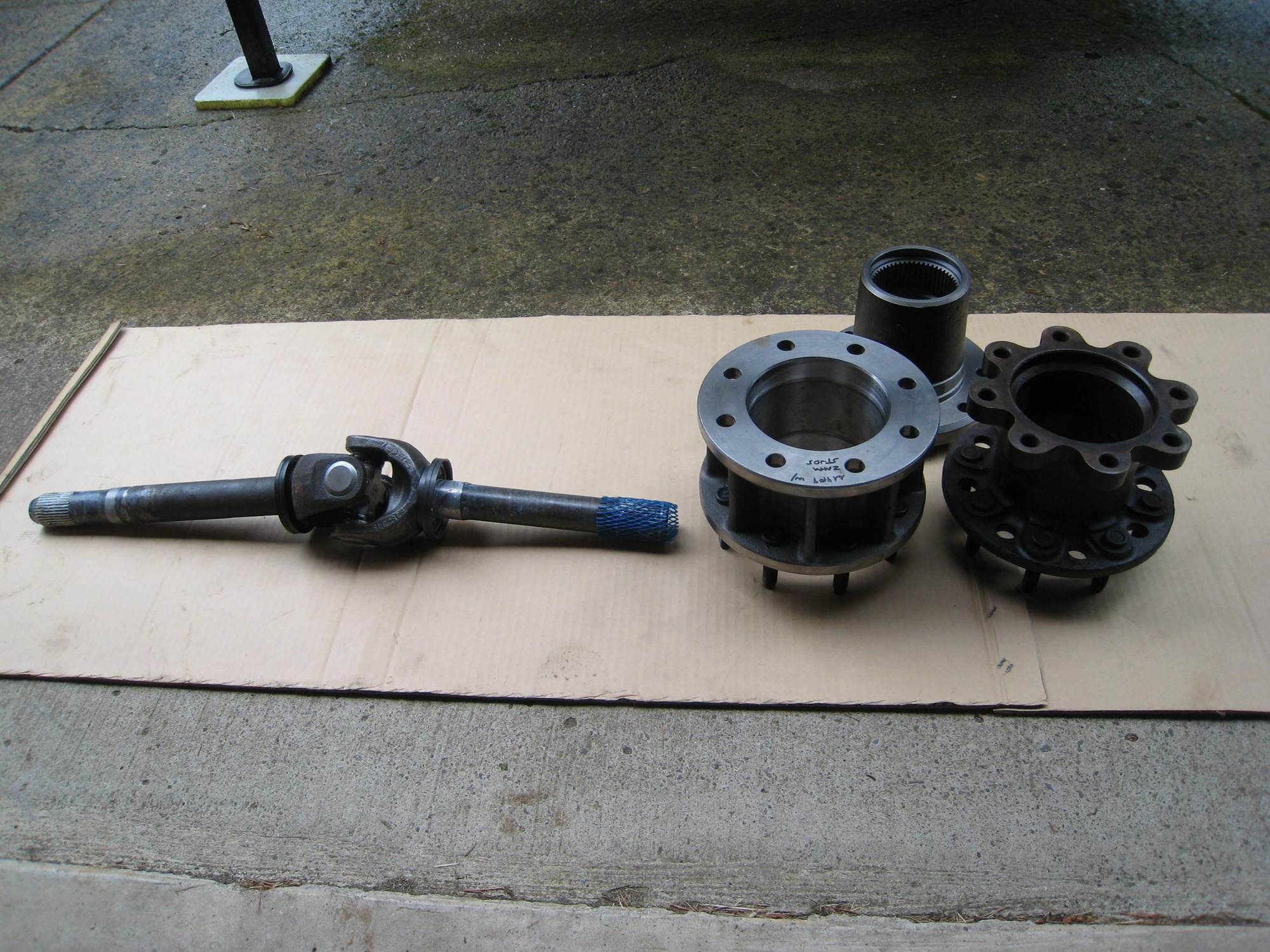

Slide-in camper on a dually F350 is the reason I converted at around 215,000 miles few years ago.
The front Dana 60 has factory "hub extensions" - see the photo below.
The one on the right is the original factory extension which was not compatible with the new hubs. Ended up switching to Arrowcraft version (on the left) which is compatible.
I was not comfortable with the combination of unit bearings & extensions.
Maybe it's fine when everything is relatively new but after thousands and thousands of miles and 4500 lbs slide in camper in the bed it was not for me.
