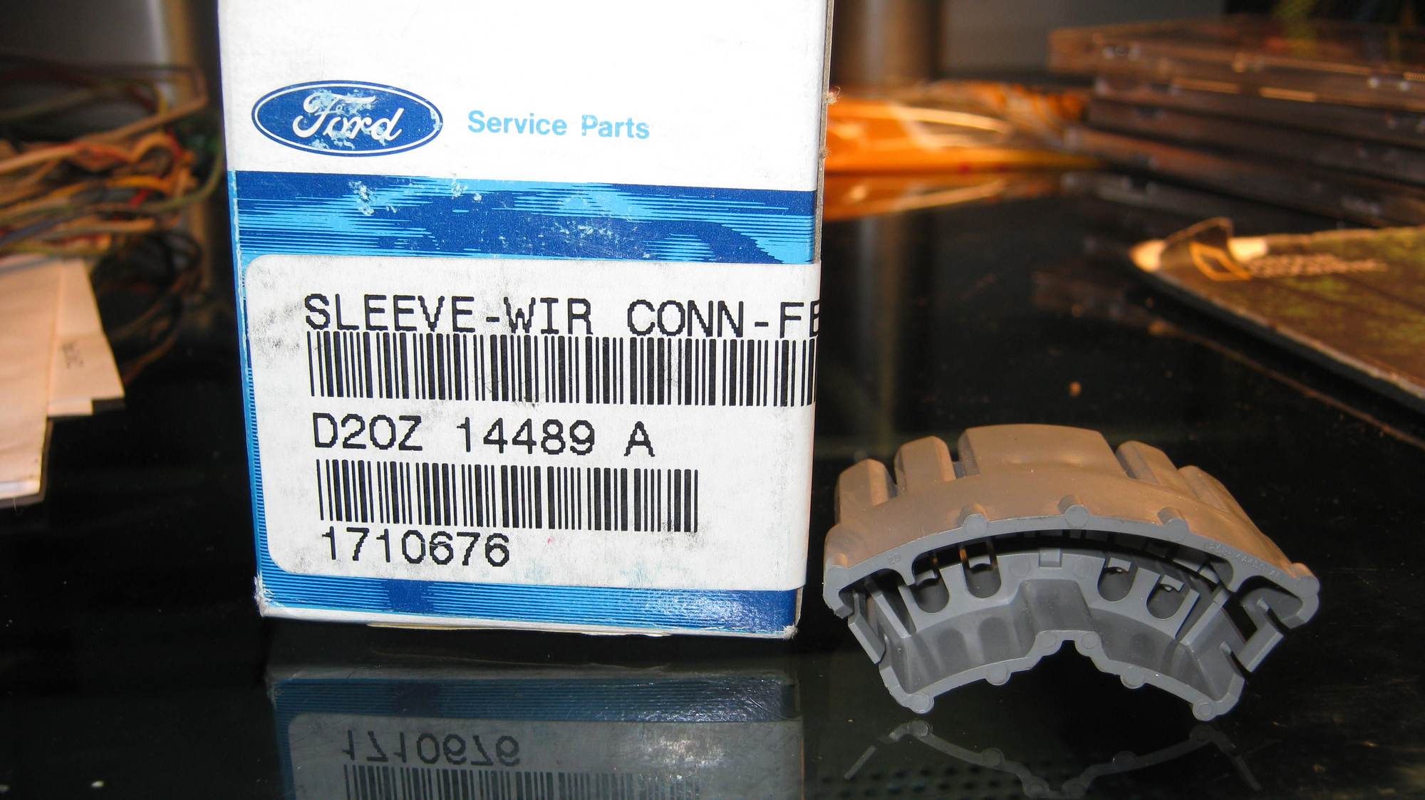

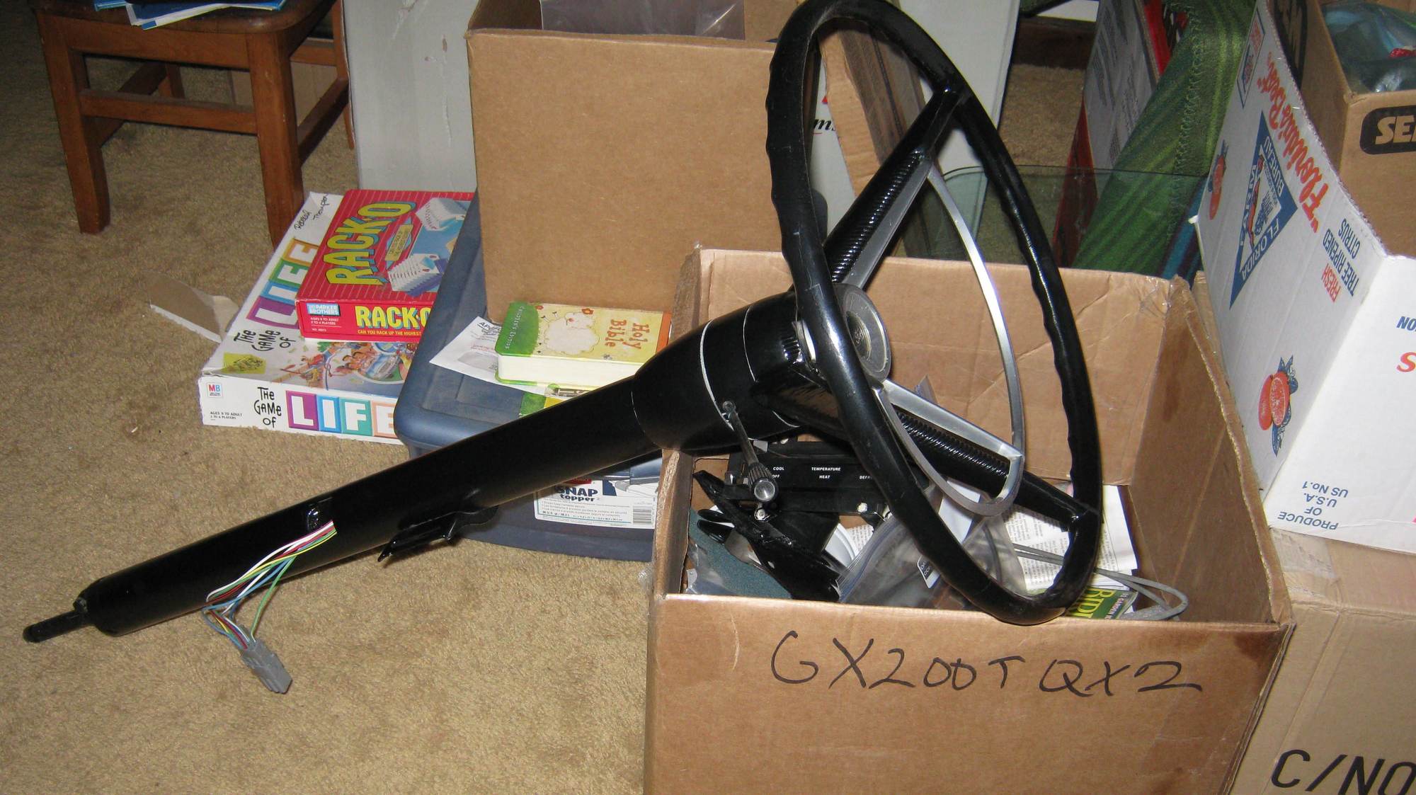

Hey guys, I've separated my large plug that connects the column to the harness several times. It is a bear to separate. I also took it apart and cleaned and lubed the contacts, but the plugs remains tough. The old plastic and broken a few times and now I'd like to replace it. Does anyone have a good alternative?? or know a source for the oem plug new?

This is what I used on my 75 manual column,,,,,,

D2OZ-14489-A Sleeve. Mating connector D2OZ-14489-B
Dennis Carpenter in Concord, NC has 4 of the -A (704) 786-8139
Green Sales in Cincinnati, OH has 4 of the -B (800) 543-4959
