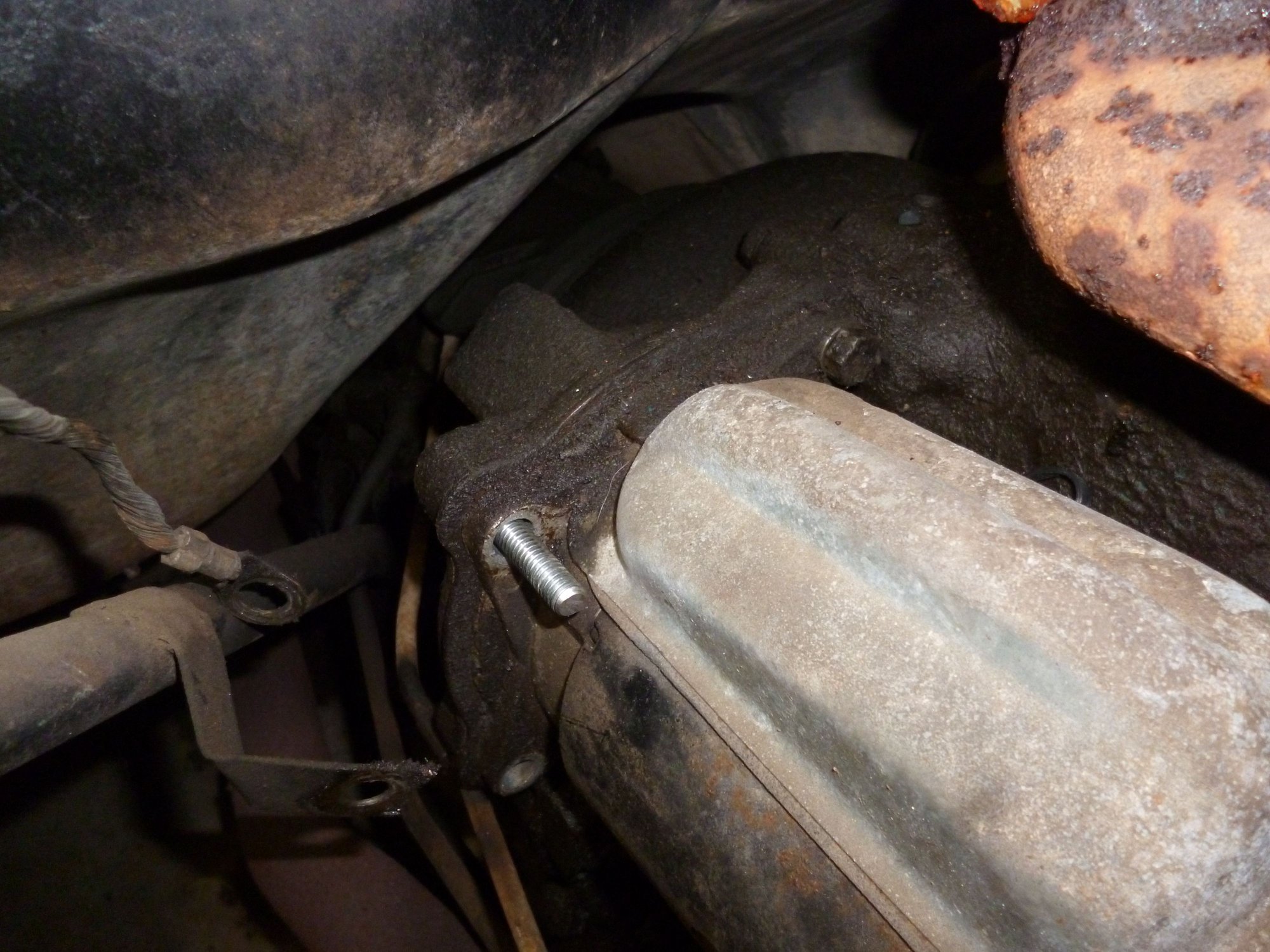

Before removing all of the starter bolts, insert a piece of threaded rod into one of the mounting holes. The threaded rod will allow the starter to hang in place and permit the removal of the rest of the bolts. Hanging the starter allows you to remove and install the starter from above.
More importantly, if working from below, hanging the starter keeps the starter from falling and hitting you in the face.

Good idea. You could just Locktite it there for re-installation and use a Nylock nut to secure. Or put a screwdriver saw slot on the end to make installation/removal easy.

If you look closely enough, you can see the red Loctite.

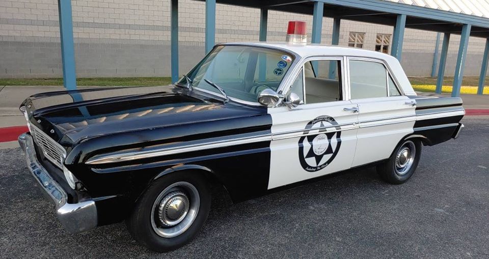

It's an old car, used for yucks, see my avatar.

Texas has a law that you cannot simulate a police car, so this will not be driven on the road. Used almost exclusively for parking lot security at Falcon Club car shows.
