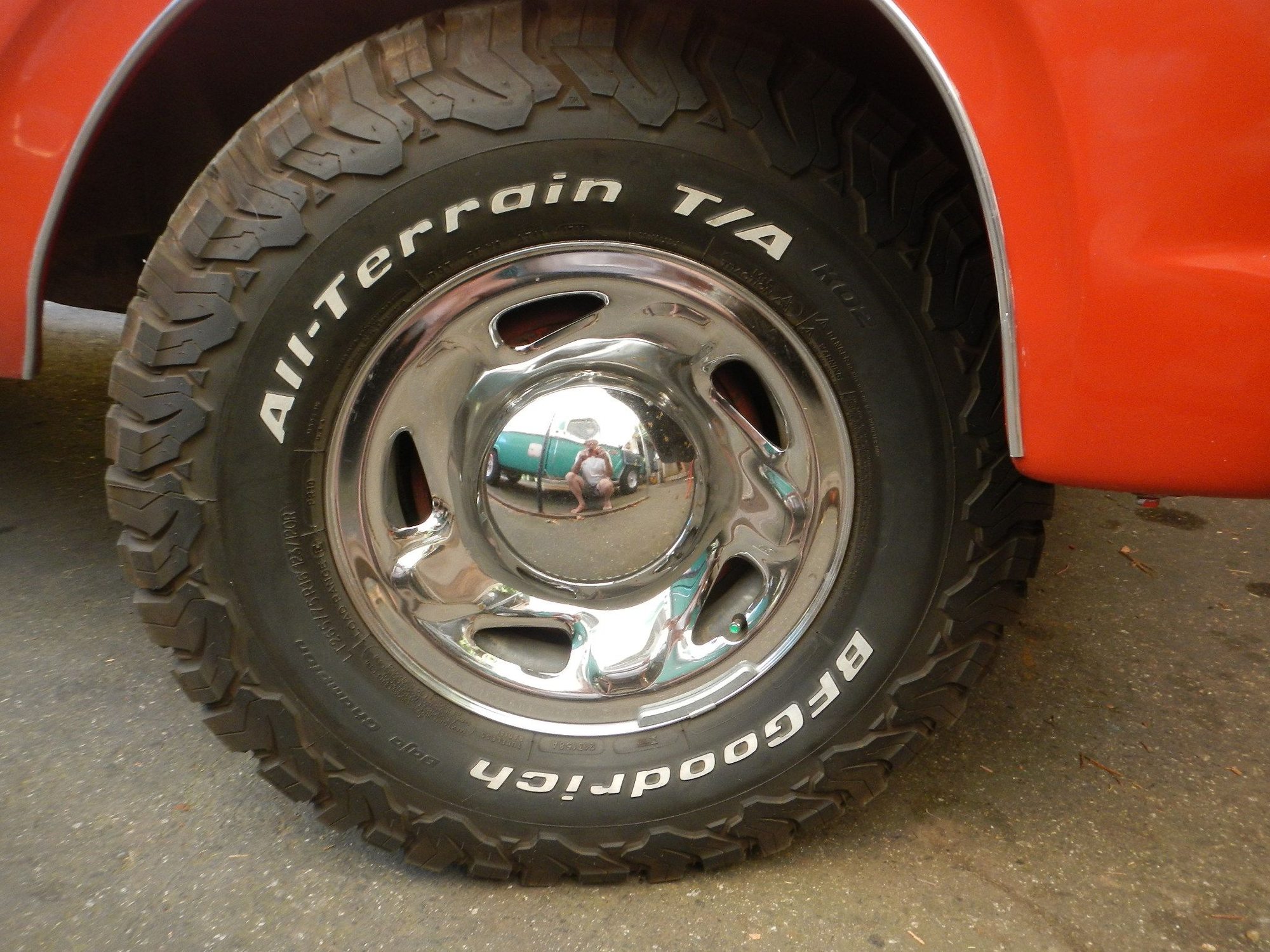

265 75R/16 on 98 dodge wheels. No rubbing whatsoever.

Those BFG's are on a F250
Nice selfie in the center cap
