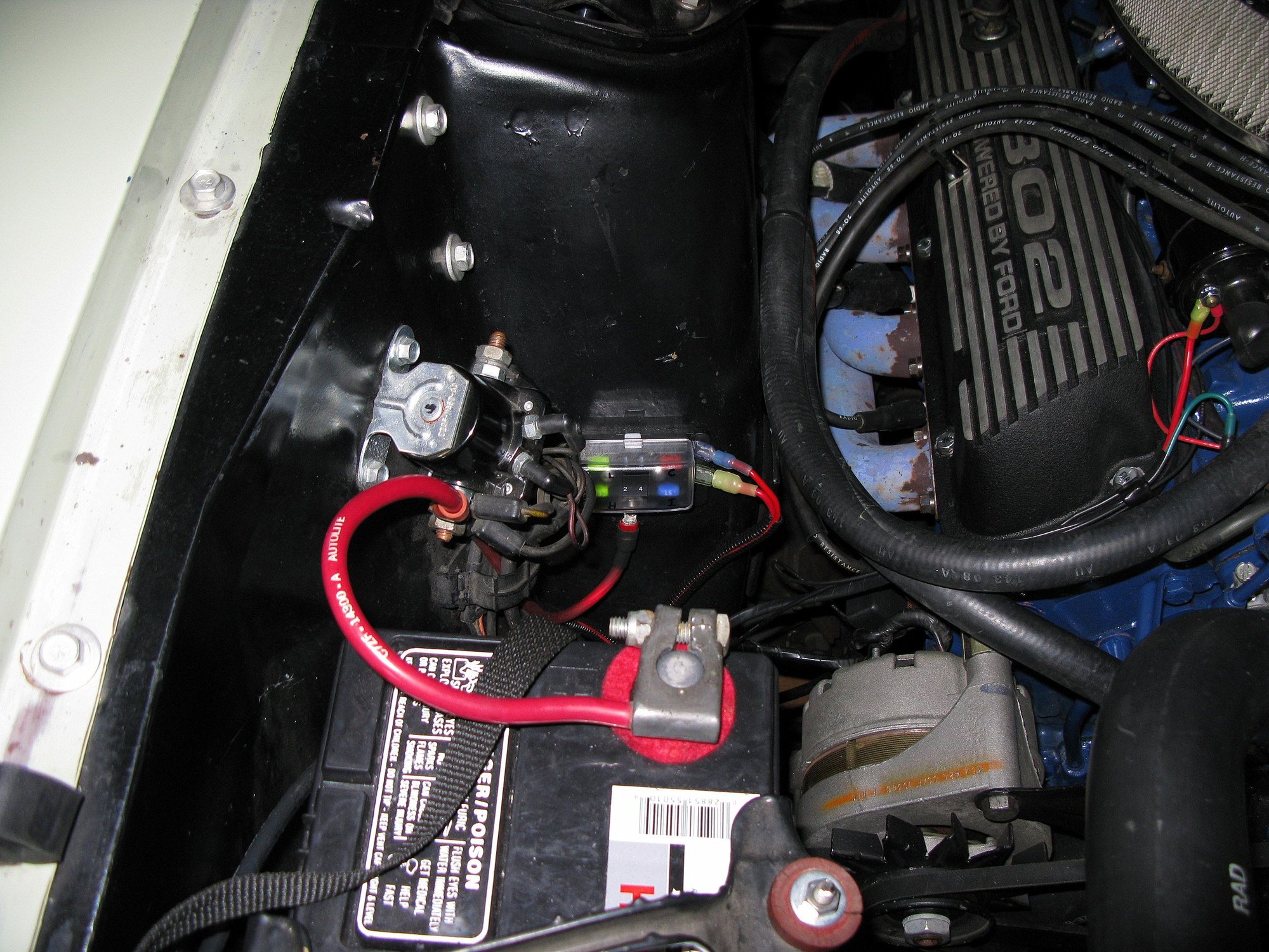

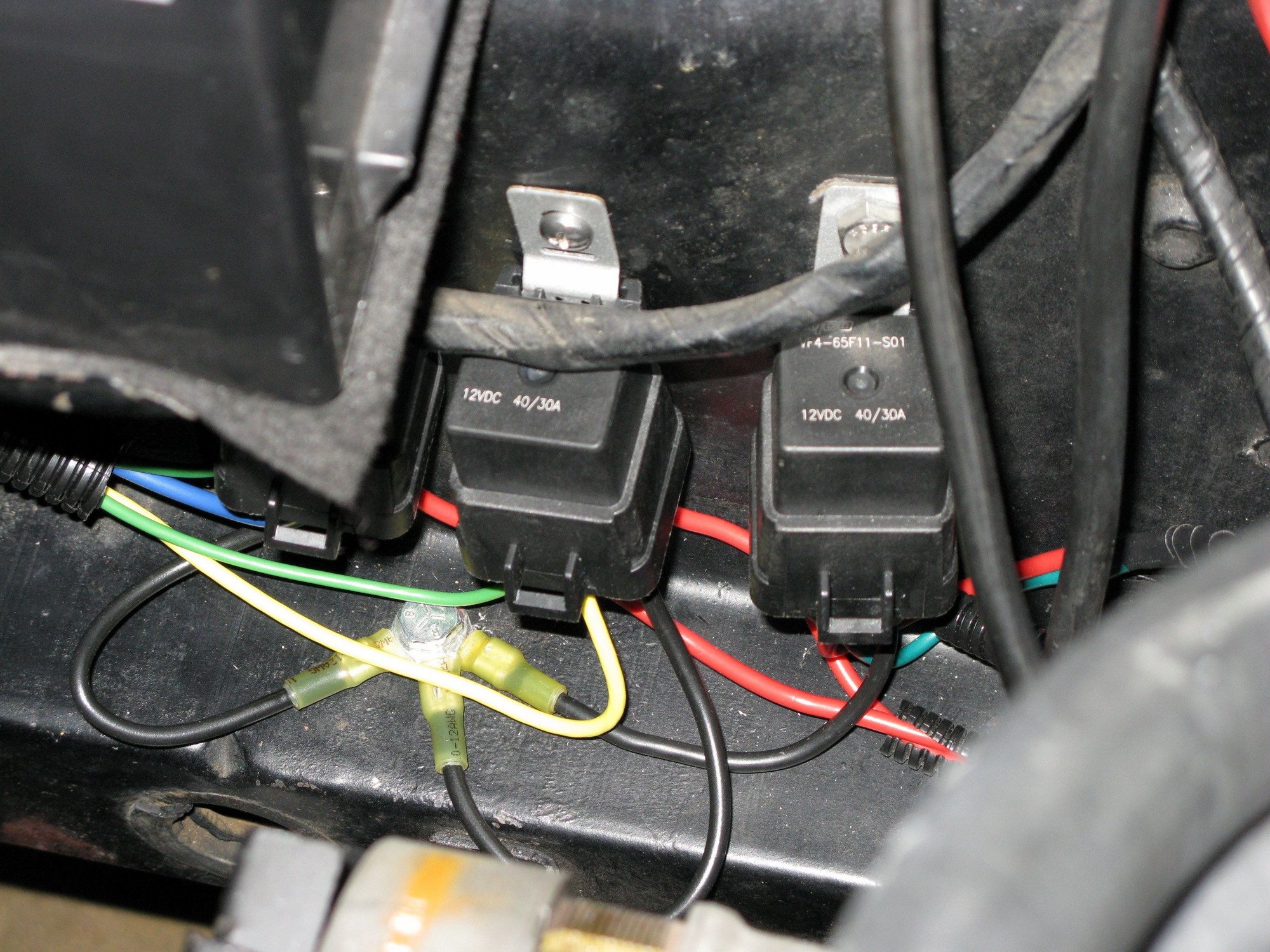

Below the relay system in the Cougar. Two for headlights and one for ignition. A fuse box is mounted above with blade fuses. This setup is in the Cougar, Mustang, and Park Lane. The truck will be next to add the ignition relay. The Polara has relays forward for the headlights only. Ignition runs the other way from the starter relay so I use a wire with an inline glass fuse to power the relay which sends 13+V to the HEI ignition now in the Dodge. All Pertronix II, 1.5 ohm coils and Autolite copper plugs at 0.40". Timing at 12 degrees ( 289, 390, 410, 360) for all except Cougar (302) at 15 degrees with a total of 36 degrees all in by 3000 rpm max. Cougar came from factory set at 10L on the distributor plate unbeknownst to everyone when tuning back in the 70s and 80s at 6 degrees initial.
