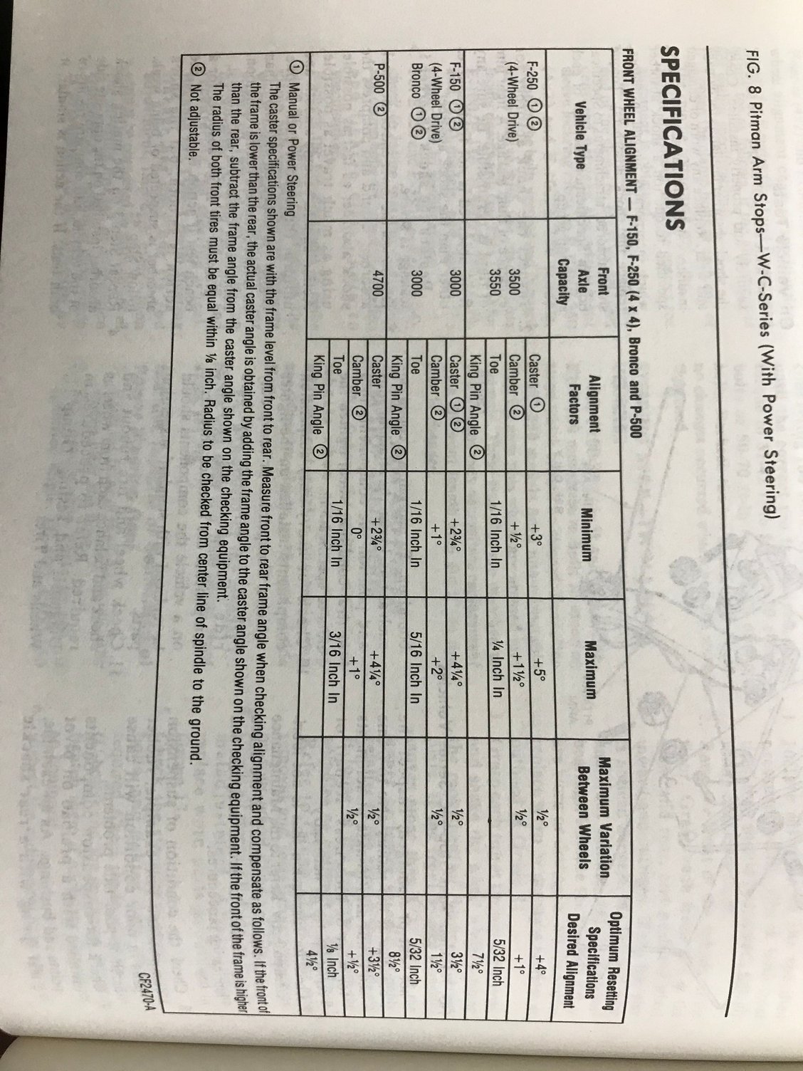

Does anyone have the alignment spec for a 1979 ford f-150 4x4. caster camber and toe

There ya go brother
