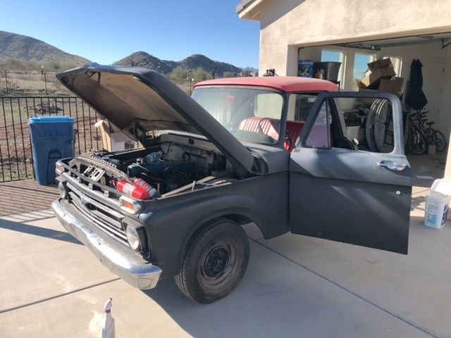

I’ve been posting and asking questions. Figured I’d document the journey.

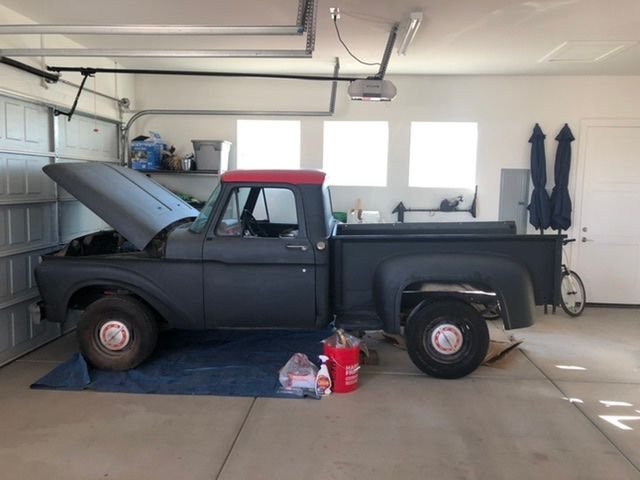

Son’s truck that we bought back in November. We’ve had to do some work to get it safe to just drive down our dirt road.
So far we’ve done the following:
- installed a Hurst floor shifter to convert from 3OTT
- replaced all wheel cylinders and brake springs and other hardware
- new fuel pump
- new starter and solenoid
- new carb
- rebuilt clutch linkages
Getting the truck to fire up today was a big deal. We were having a bunch of trouble and we tracked it down to a broken wire on the ignition coil. The engine would fire up when we brought it home but I think I snagged the wire when I pulled the steering column out to get at the brake and clutch column. Had a friend over helping and he spied the broken wire. Fired right up after that.

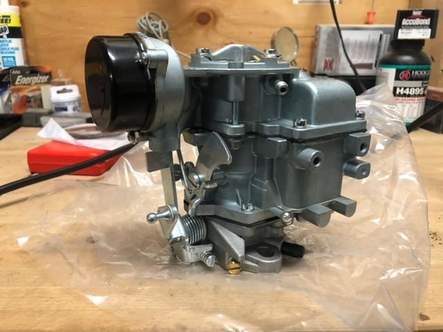

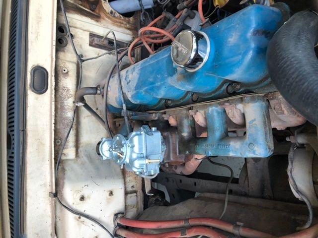

we had also replaced the carb with a $60 Chinese knockoff of the Carter YFA. It bolted right up and was easy to install. I haven’t hooked up the heat stove yet (will do that when we pull the motor) The motor runs very smooth and is quiet. I was amazed.

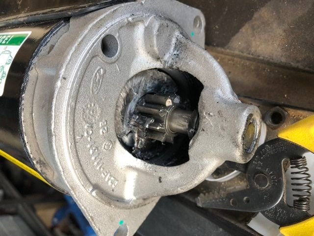

3rd starter. We were trying to install starters for automatic transmissions on a manual. Some photos of the carnage that ensued as well.
Chinese Carter YFA style carb. Amazed how well it runs.

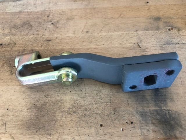

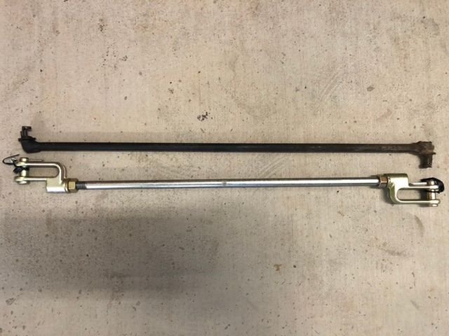

I really like the gangster color. That new clutch rod looks like the hot setup. Another thing to do is bronze bushing those pivot points.

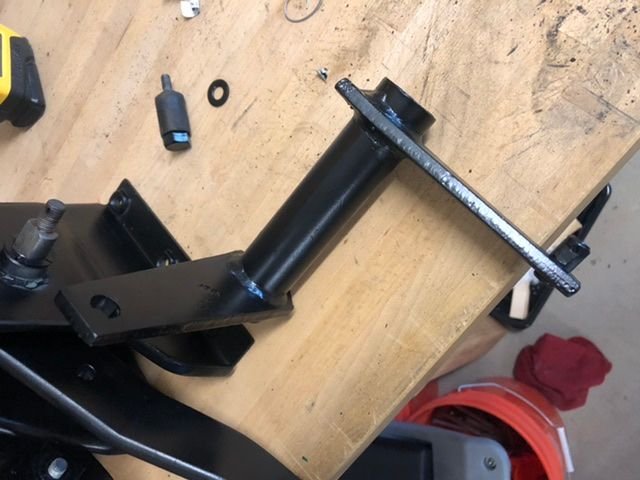

i got that idea from the Bronco guys. It cost about $25 to make and is pretty stout. I used plastic bushings that I believe I got from LMC. They’re not in the photo.

Did the clutch linkage come w/the shifter you bought?

no I made the clutch linkage. the hurst install kit included linkages from the shifter to the transmission
