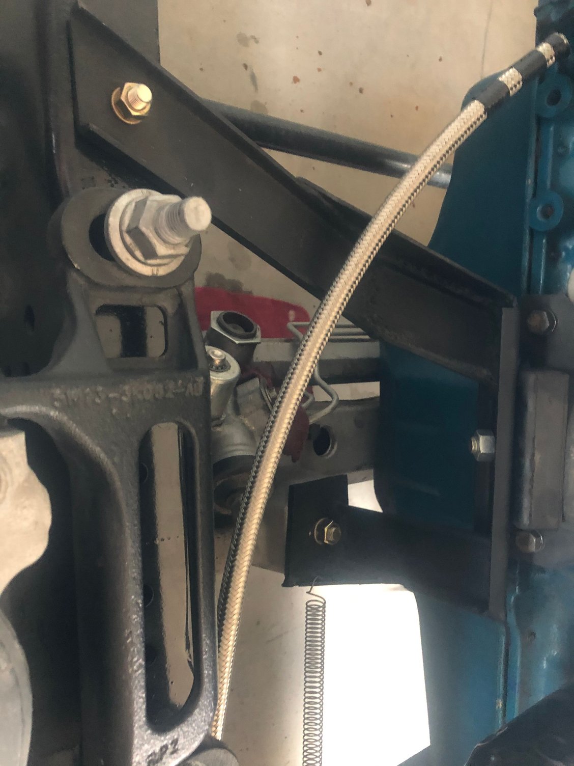

Fuel and brake line photos
Making sure I had these photos.

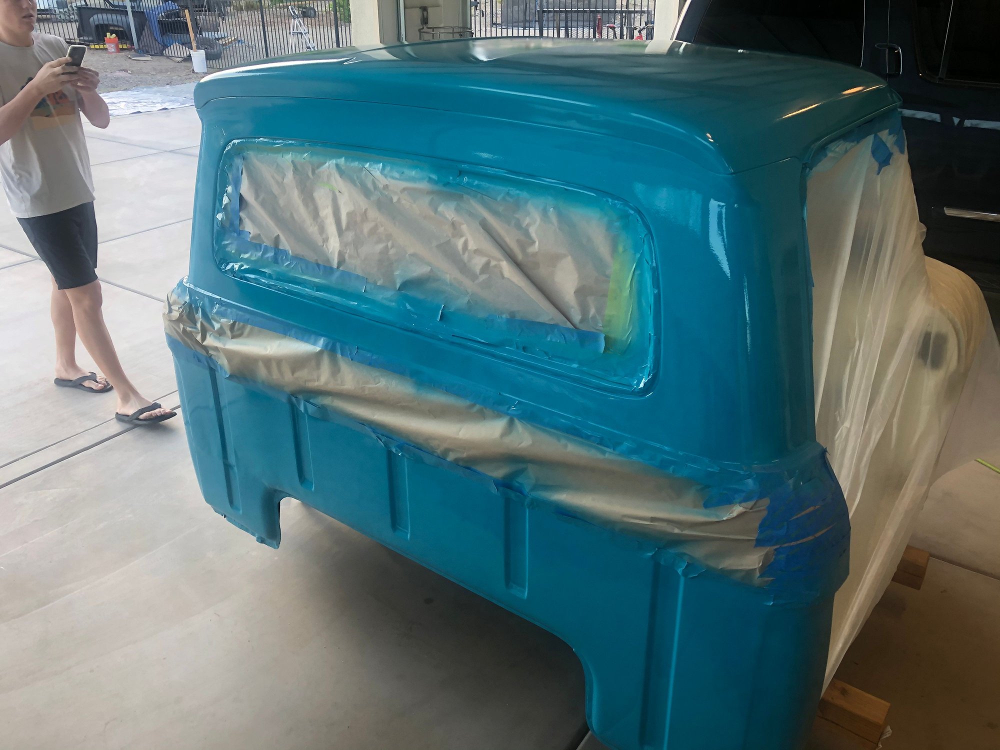

Paint!
Summit single stage. Wimbledon white and coastal ble. Sprayed with my HF 21 gallon compressor, a 5 gal aux tank with a oil separator to act as a trap, and a spray it lvlp gun.

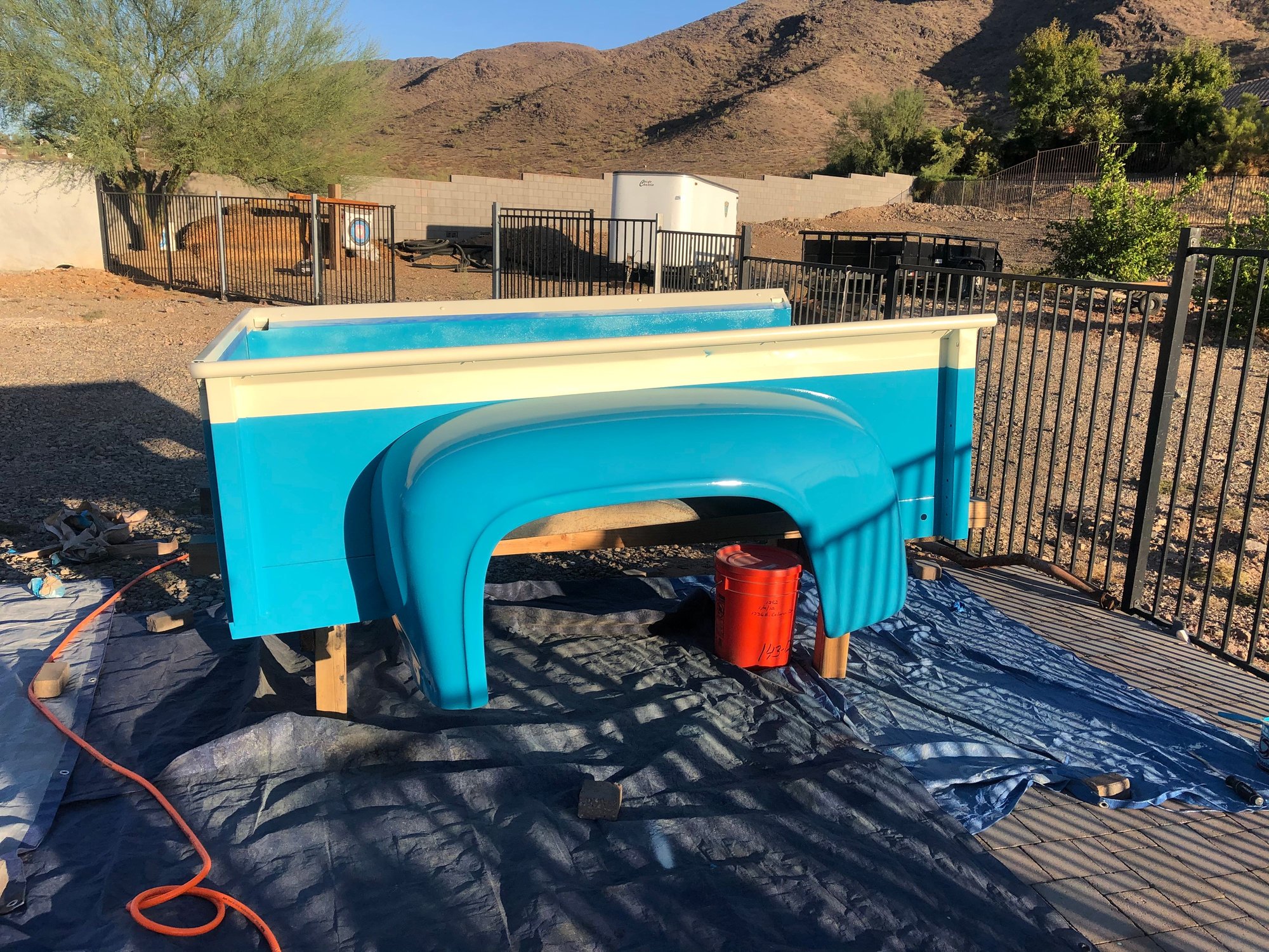

Bed painted
Wind died down. Got the bed painted yesterday. Hoping to mount it up this week. Gotta have my son grab his fellow football players.
Little touch up needed where masking ripped.

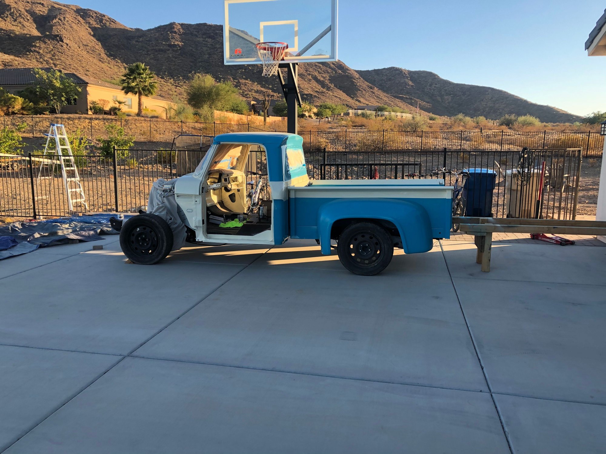

Test fit the bed... will need a little work.
We also test fit the bed... the inside of the wheels are a little close to the bed. Probably less than 1/4 inch. I can’t get my fingers in there. Might need some wider adapter/spacers for the CV wheels.
