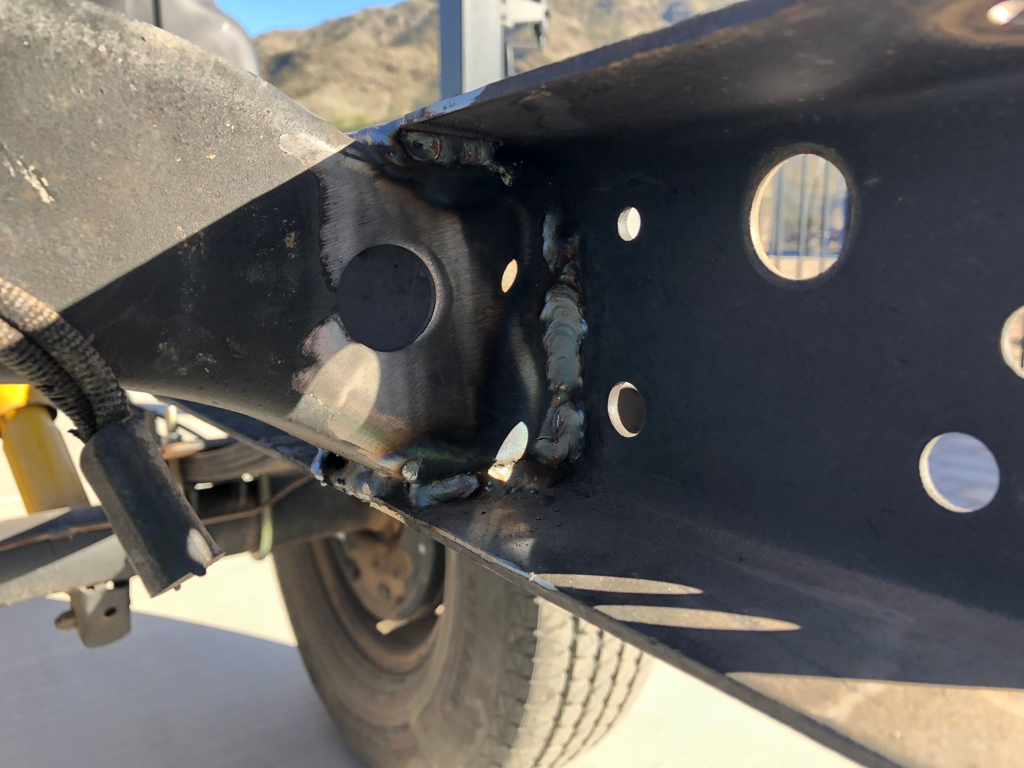

Drove over to a friends house down the street, welded up the rear cross member and a brace in the front.

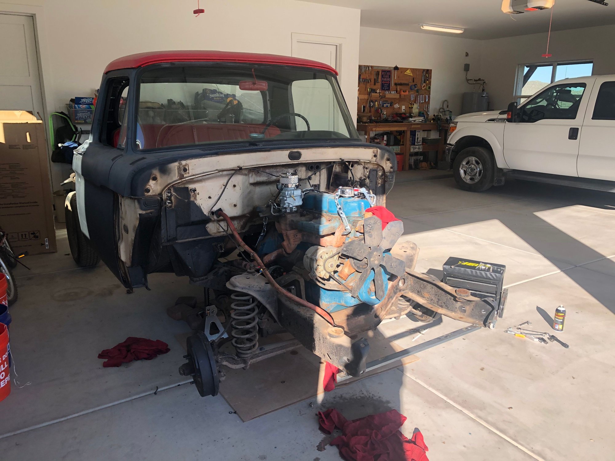

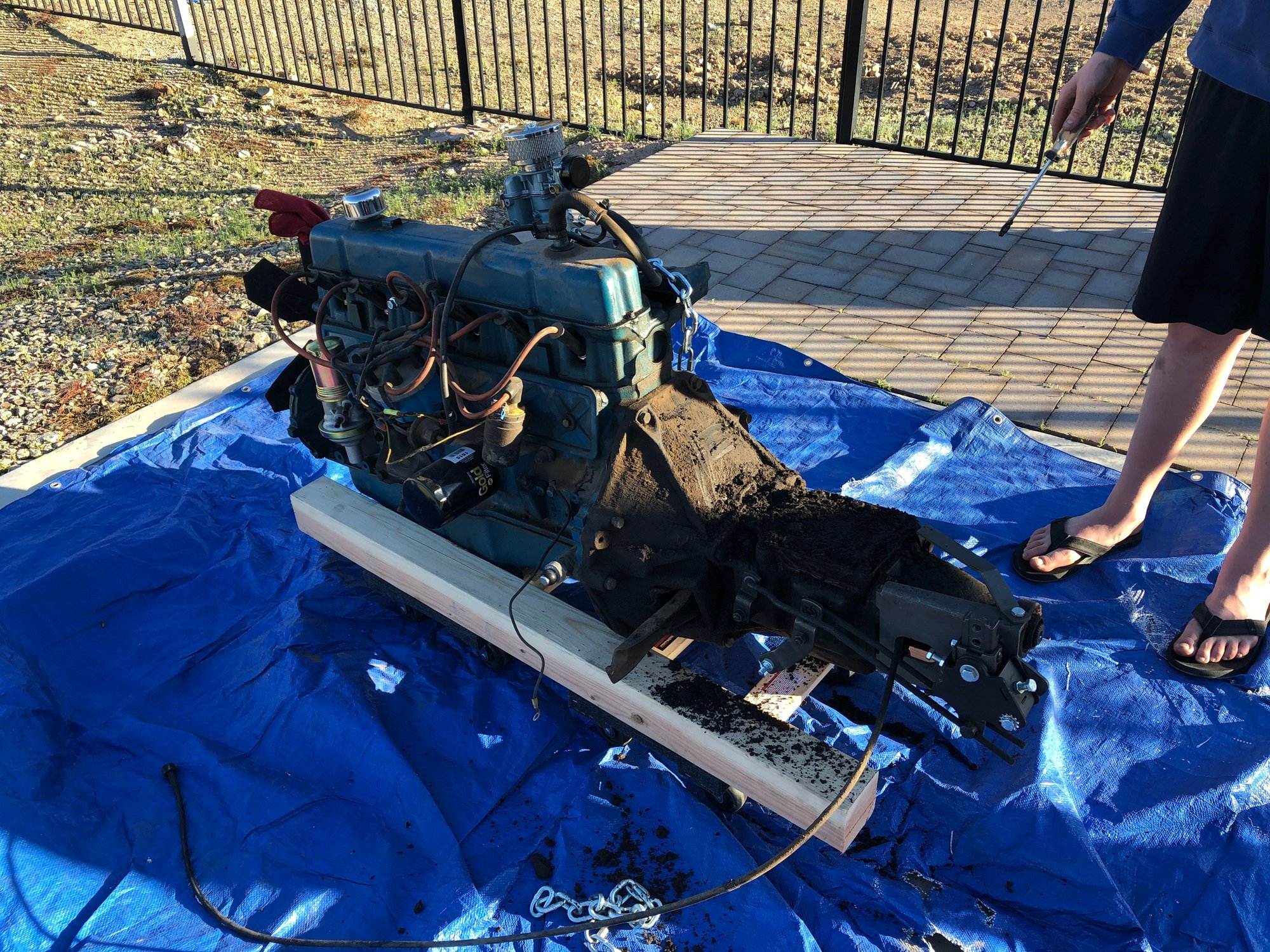

We got all of the front fenders removed, took off the passenger motor mount, pulled the motor, and started cleaning up a ragged chop job on a cross member by one of the POs.
Front fenders off
Inline 6 coming out
Original color.... some kind of white
Eyes.... check, ears....check, osha compliant shoes..... Nope. Gotta talk with him about that.
54 years of nastiness.

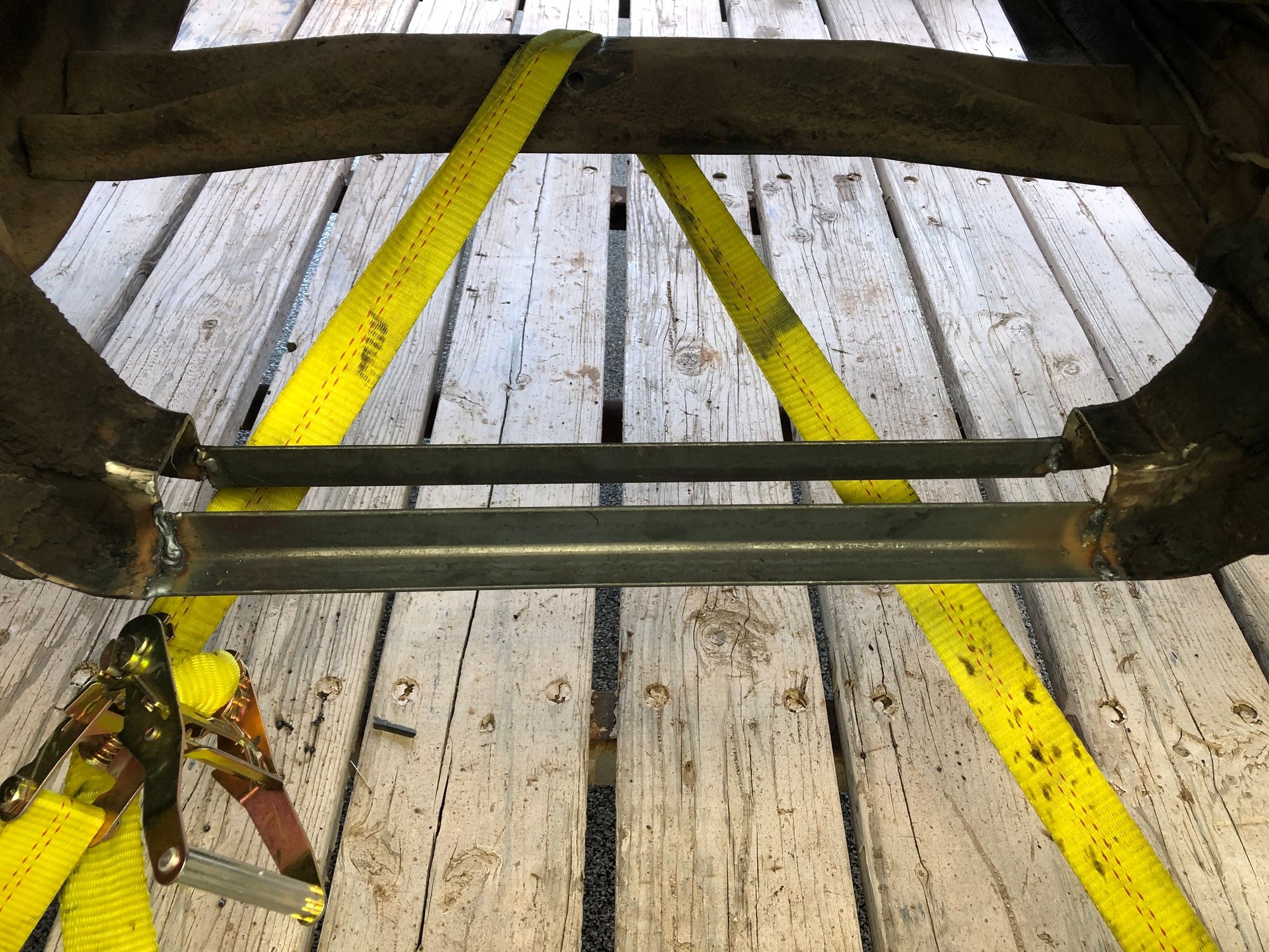

Today’s activities will be removing the driver side motor mount, removing the front inner fenders from the front grill, and loading the truck onto the trailer to head over to a friends for some welding. We purchased some angle iron and flat bar to repair the chopped up cross member.

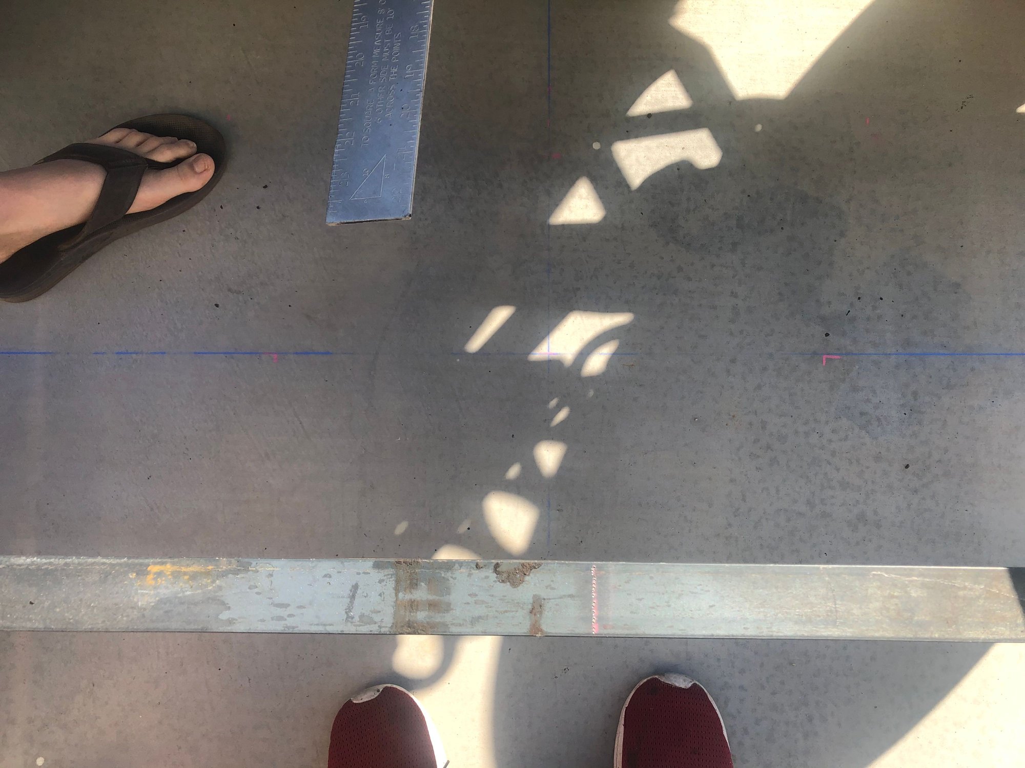

Well today was interesting.... had a date with a friends welder. That fell through, so we decided to measure some reference points that we will need later and pull some parts off earlier than we had intended.
Reference lines set on ground with plumb bob and chalk line. Measured the center line between the frame rails.
Measuring the centerline of the front “axle”
Center line and perpendicular line to transfer to frame. Will be used for reference measurements.
Used a punch to simple the frame. Plumb Bob was used to transfer the location from ground to frame. Checked with squares and straight edges.

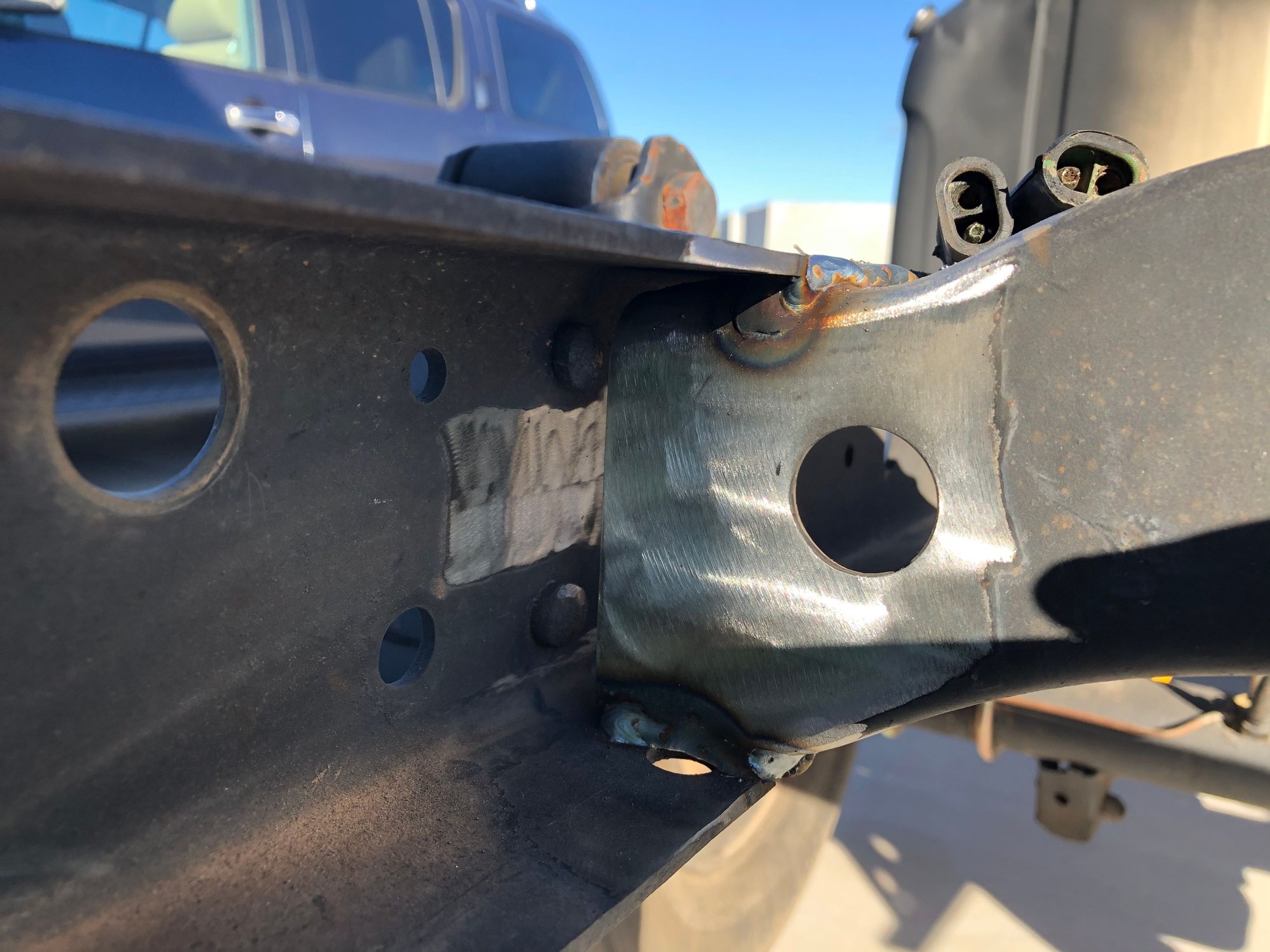

Was able to spend an hour at a friends place on Thursday fixing a cut out section of the cross member beneath the bell housing. Still needs a top added to it, but it should be good enough to hold things together while we work on removing the twin I front.

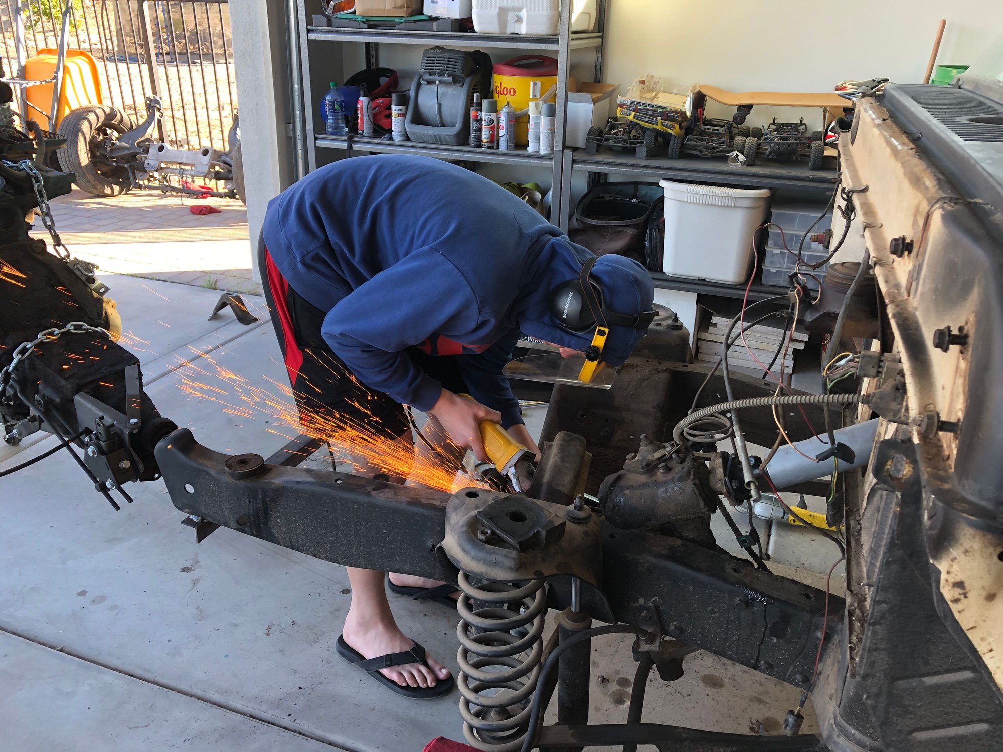

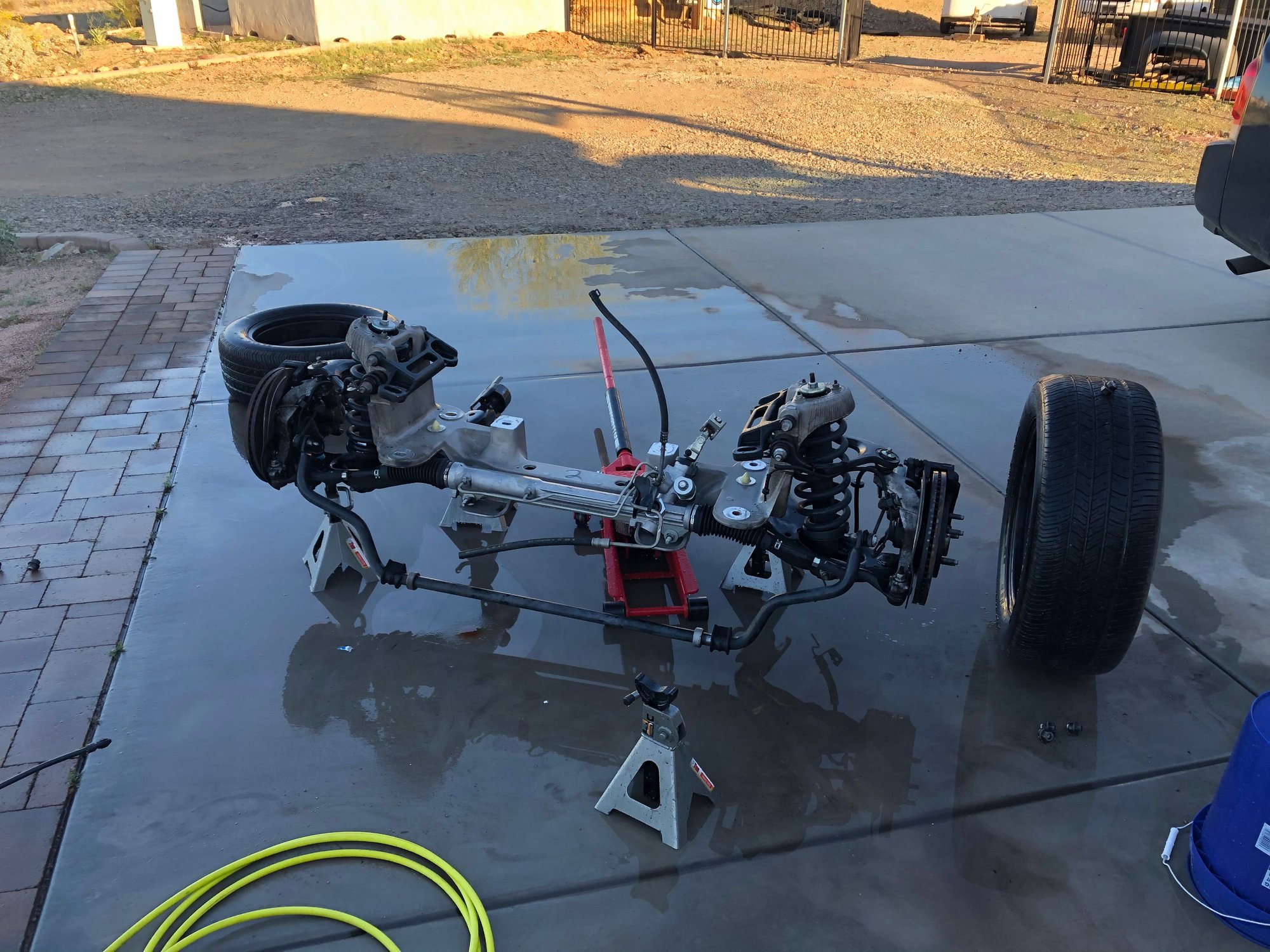

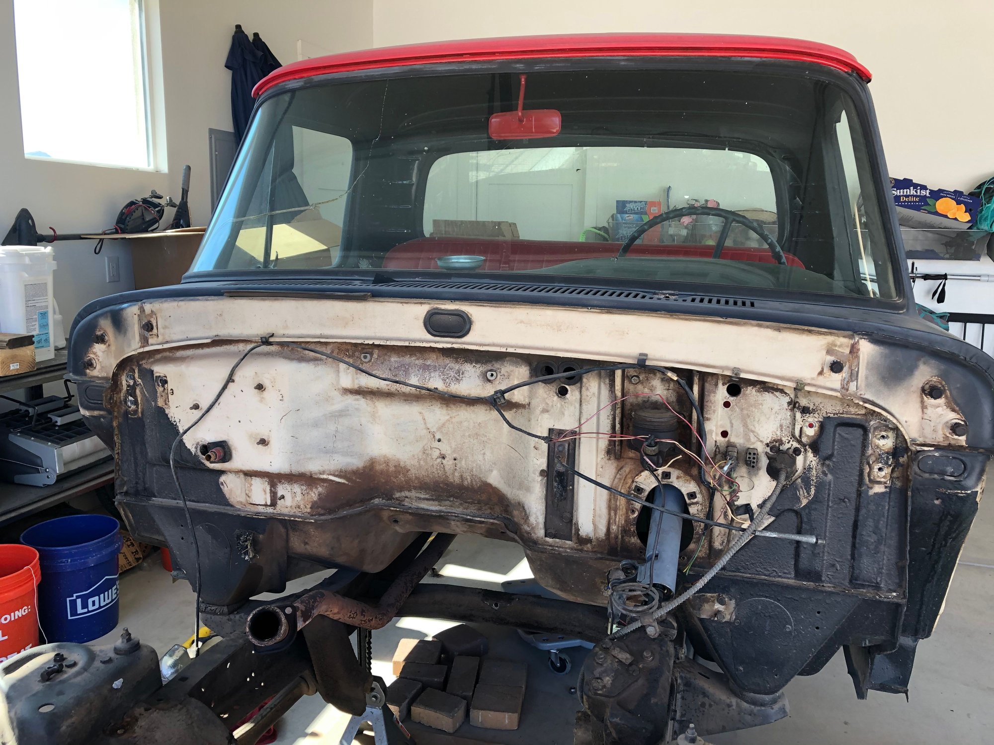

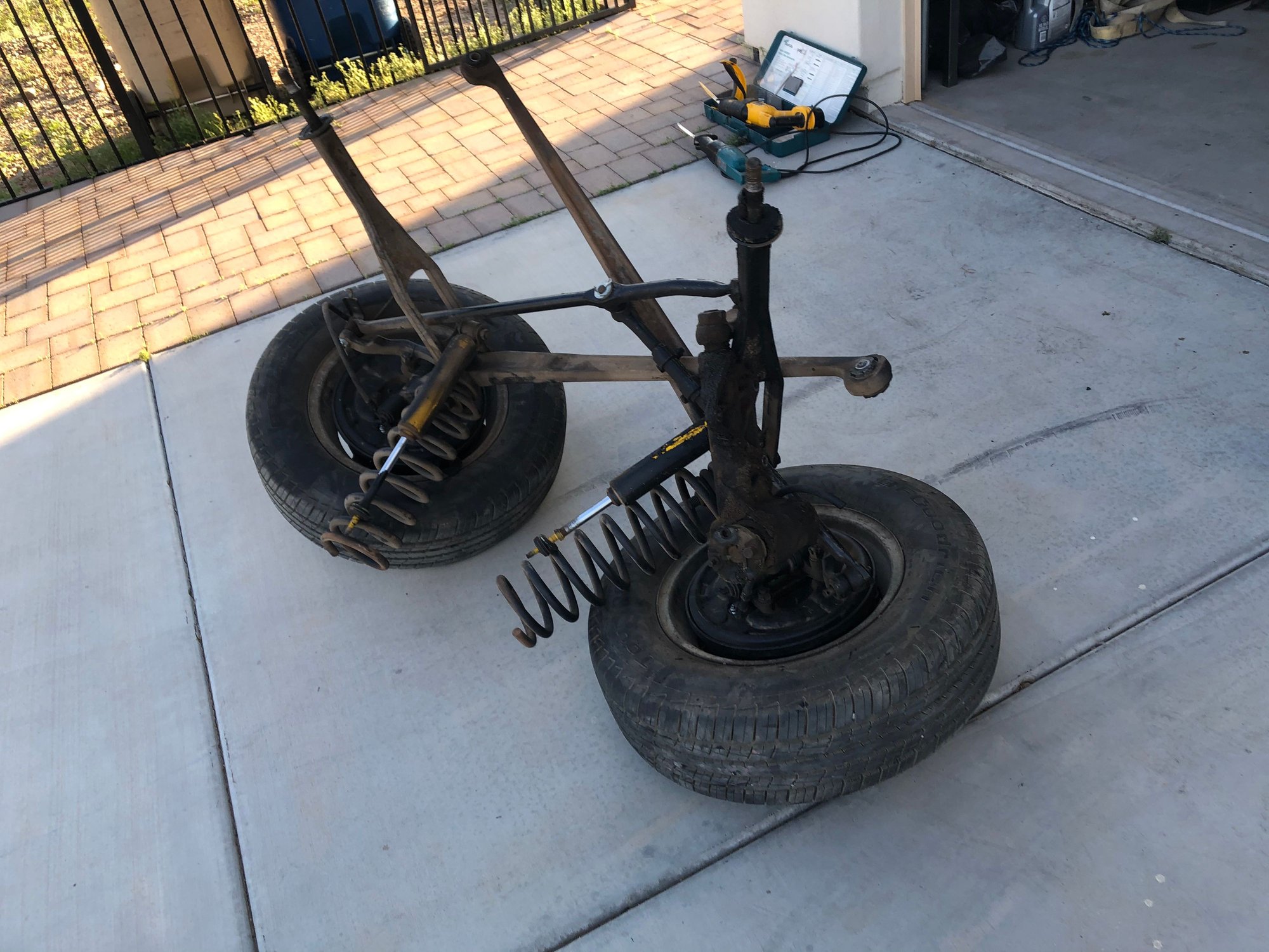

Another good weekend. Got the twin beams and steering components out, also cut out the front cross member. Couple more sessions grinding and cutting and we should have the front spring perches off and the frame ready for the CV front end.
here’s a few pics. If anyone sees any parts they might need, PM and we can work something out.
