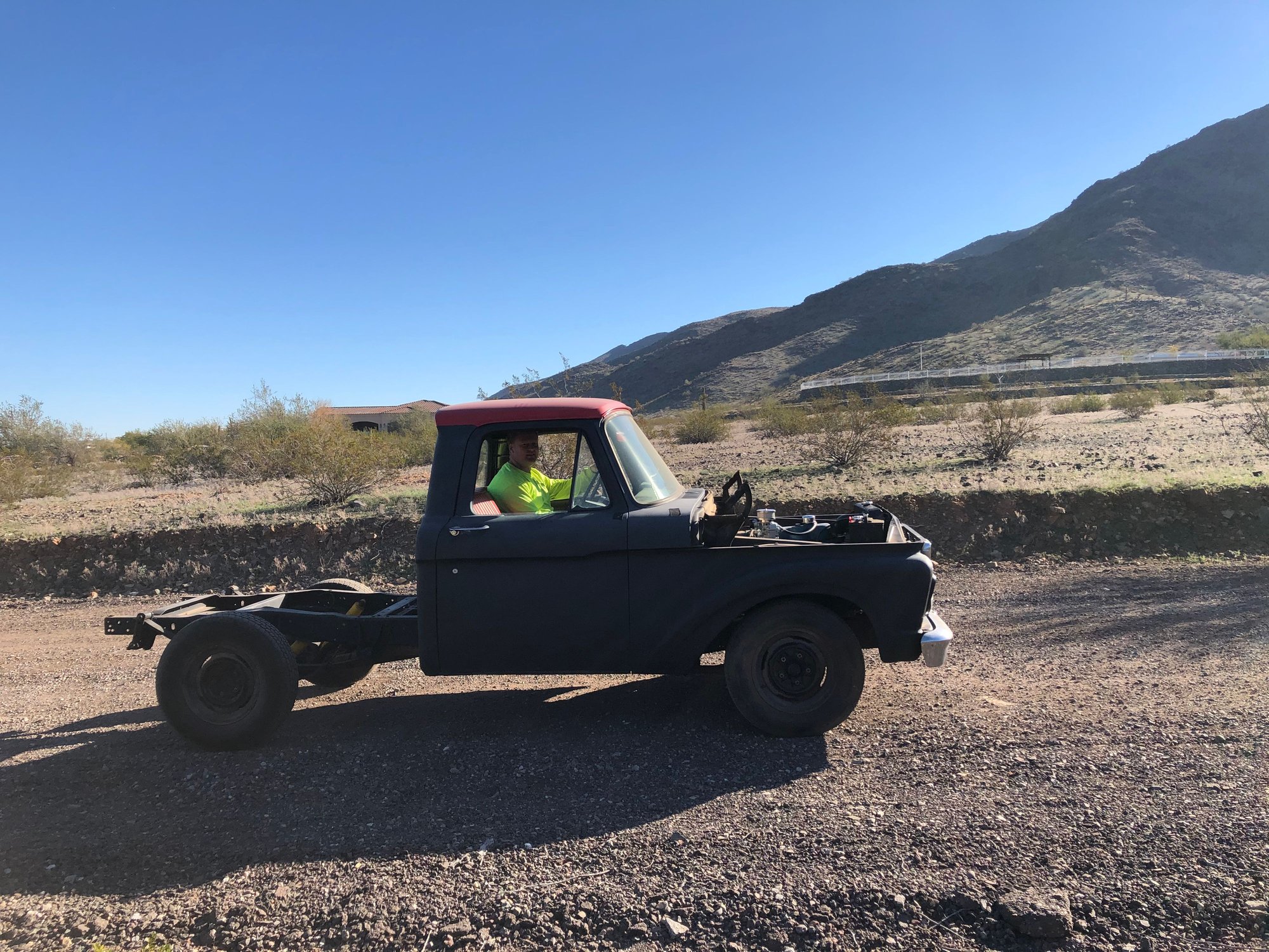

Got the shifter adjusted, found some misalignment with the equalizer bar, and adjusted the clutch linkages a bit. Shifting real nice now.
We did a bit of work squaring up the rear axle. Doesn’t dog track as bad now. Not perfect, but good enough for now seeing as we are gonna take things apart and paint frame and do some other work involving the suspension.
after that we had some fun. I took each family member up and down that street and did some gravel road burn outs. My son got to drive his truck (and a manual) for the first time ever. It launches real nice with no gas needed. He only stalled once when he tried to stop with it in first. I think he gets it now that the clutch needs to be pressed or he needs to slide it into N when coming to a stop.

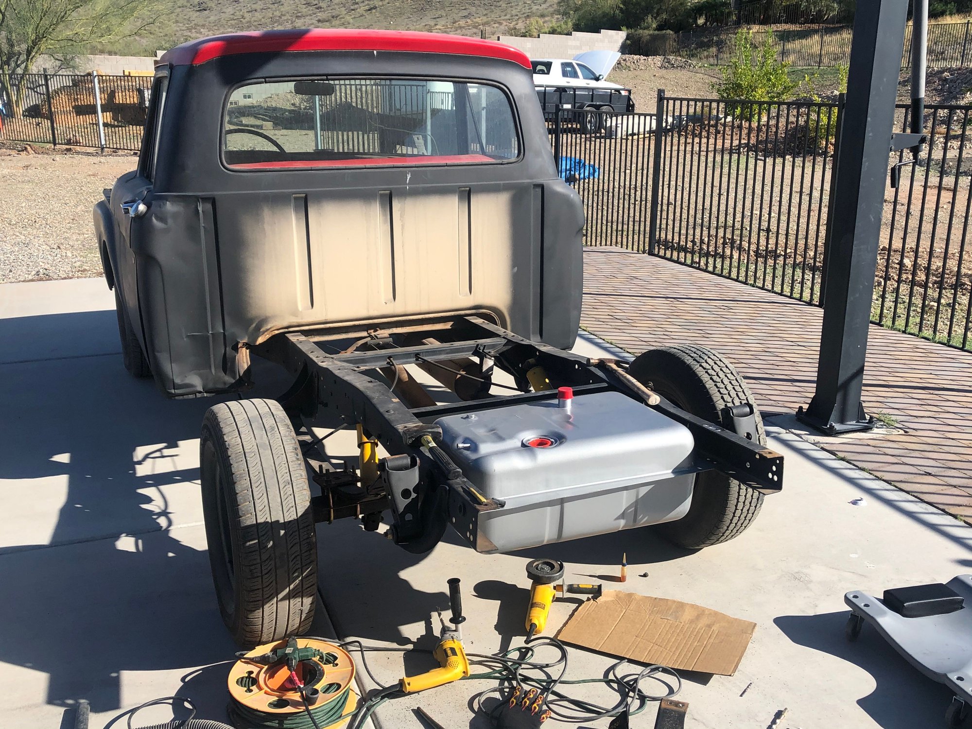

We made a dump run, cleaned off my high side trailer, the loaded the CV up on it. You can see it in the background. Had planned on removing the front end while it was loaded to be able to deliver the carcass the the scrapyard. Not enough room though so it’s coming down and we will work on it in the dirt.
after that, my son got to work grinding rivets. I helped him drill and punch them after the heads were off, and I worked on installing a shop sink in the garage. Nice be washing our hands like civilized people rather than using the hose.
Last item of business was to make sure the new gas tank fit in there. Next up on Sunday will be figuring out how much clearance need on the top side and seeing how exactly we want to hang it in the back.
