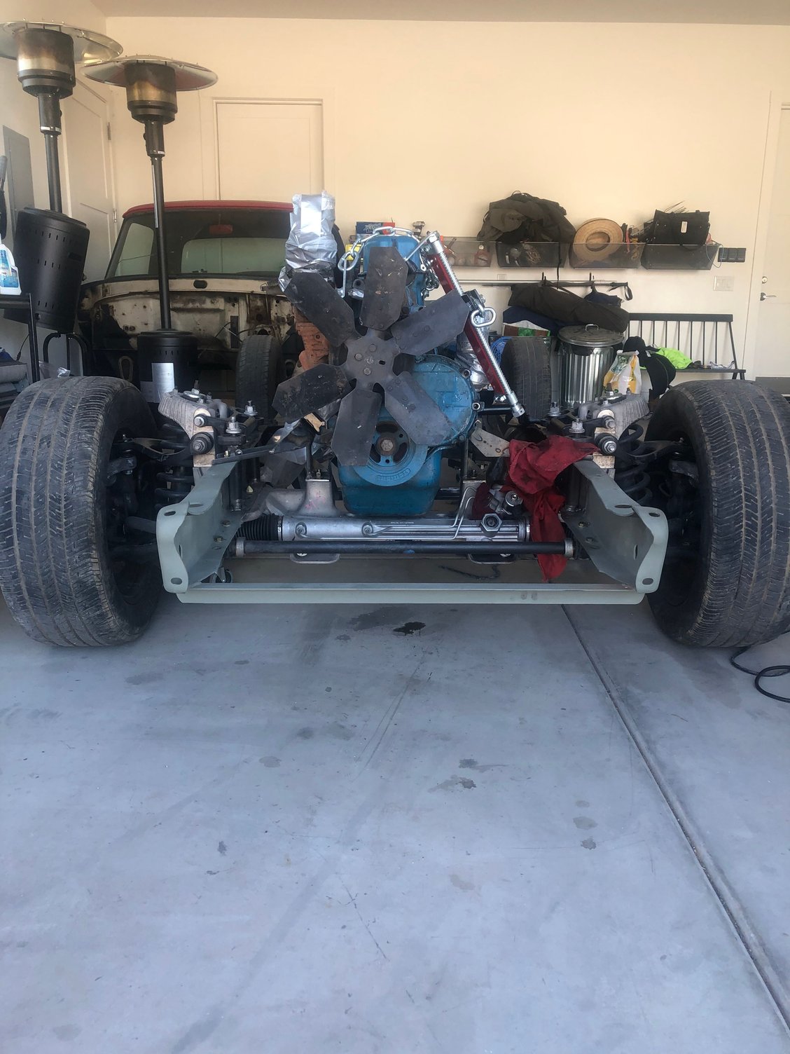

Motor mounts
Finally was able to borrow a welder and start figuring out the motor mounts.
Drivers side
Passenger side
Listing very slightly to the passenger side
Oil pan clearance. Slightly skewed side angle. There’s an inch and a half easy on the passenger side
No crane support!
Slight pressure on the torpedo to level things out. Close enough for these amateurs.
The next step is to flip the rear axle (above the leafs) and ensure that the centerline of the axle and driveshaft are all as should be.
