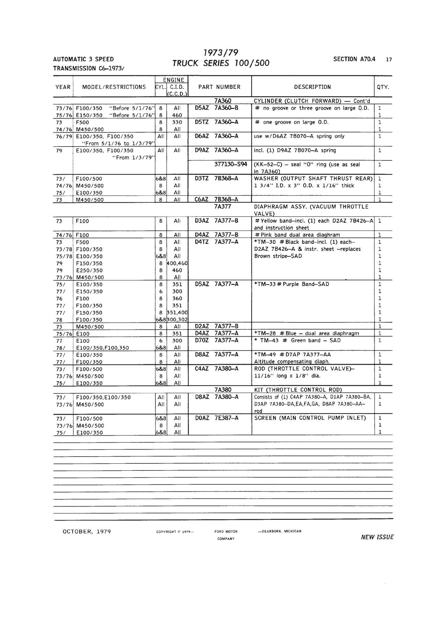

Maybe this will help?

Ford ID's the modulator by the color of the band on them. Pretty much the "go to" modulator is either the black or green band, either will work. Avoid the pink or blue band. Those are a dual diaphragm versions and takes two vacuum lines.
Are you missing the pin? If not, you can just reuse the one you have.

oddly, literally just watched a video where the guy was replacing his vacuum modulator and he measured the pin length at 1 5/8"... seems like a handy dimension to know.
