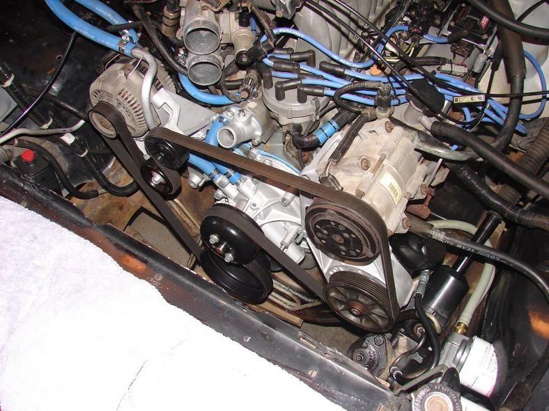

This is my early model sag conversion with the original .700 size shaft:
I like to carve on aluminum.
