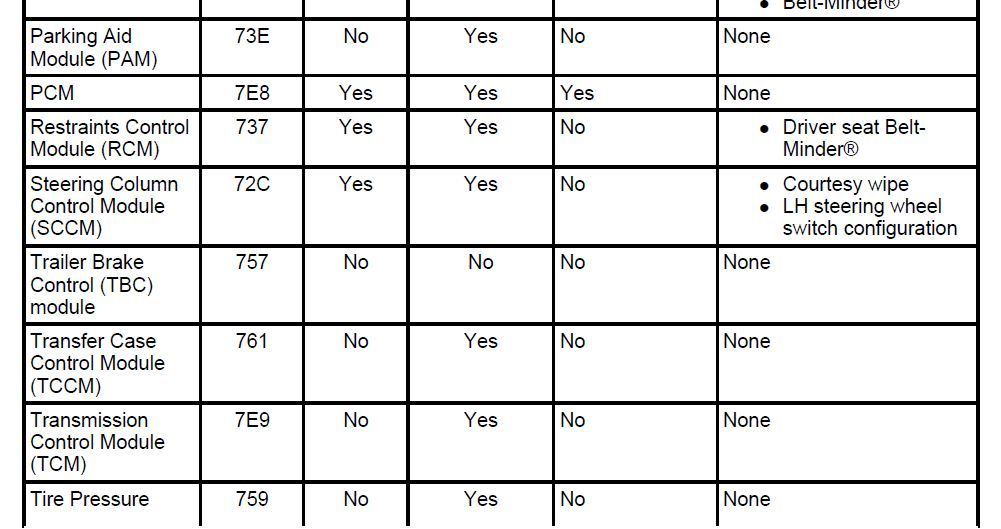

Yes, I am sure. This is not your 2006 but a 2013 truck.
From the 2014 Ford Workshop DVD...If any of the columns were Yes, you need to use the As Built data or save the data (settings) from the old module. Also, the left most column tells you the parameters that can be programmed...
