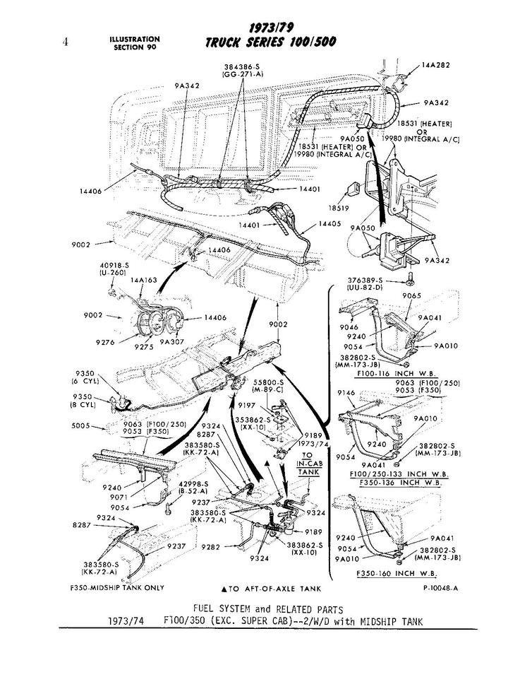

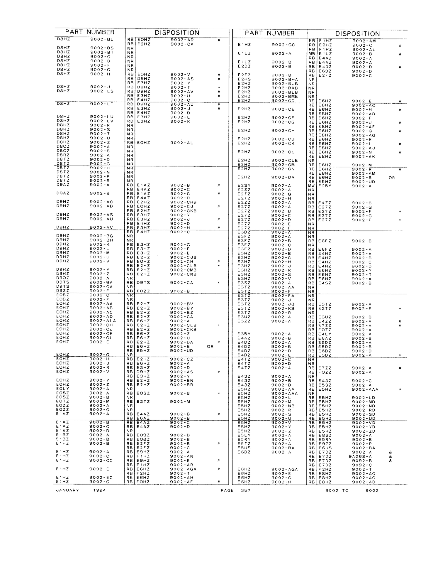

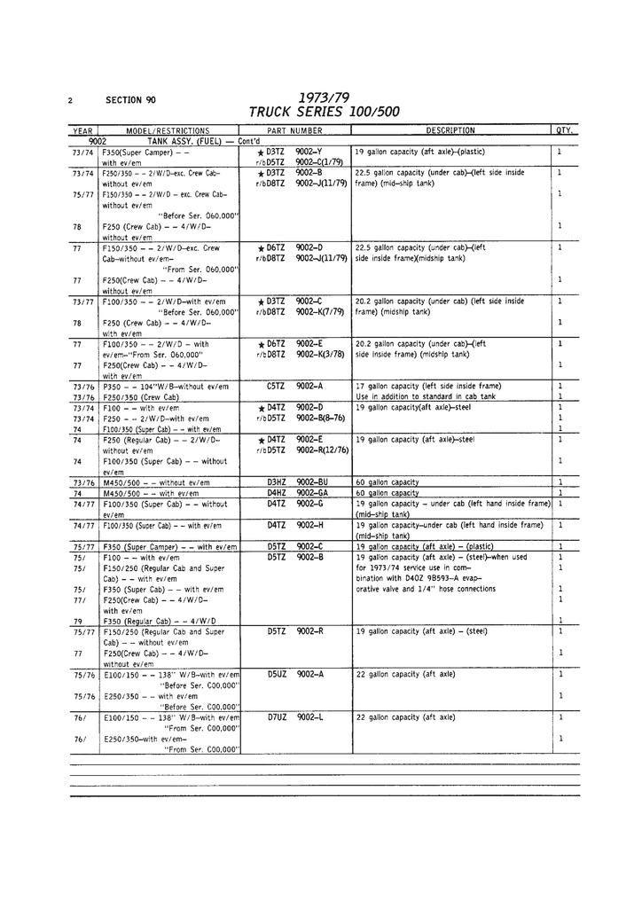

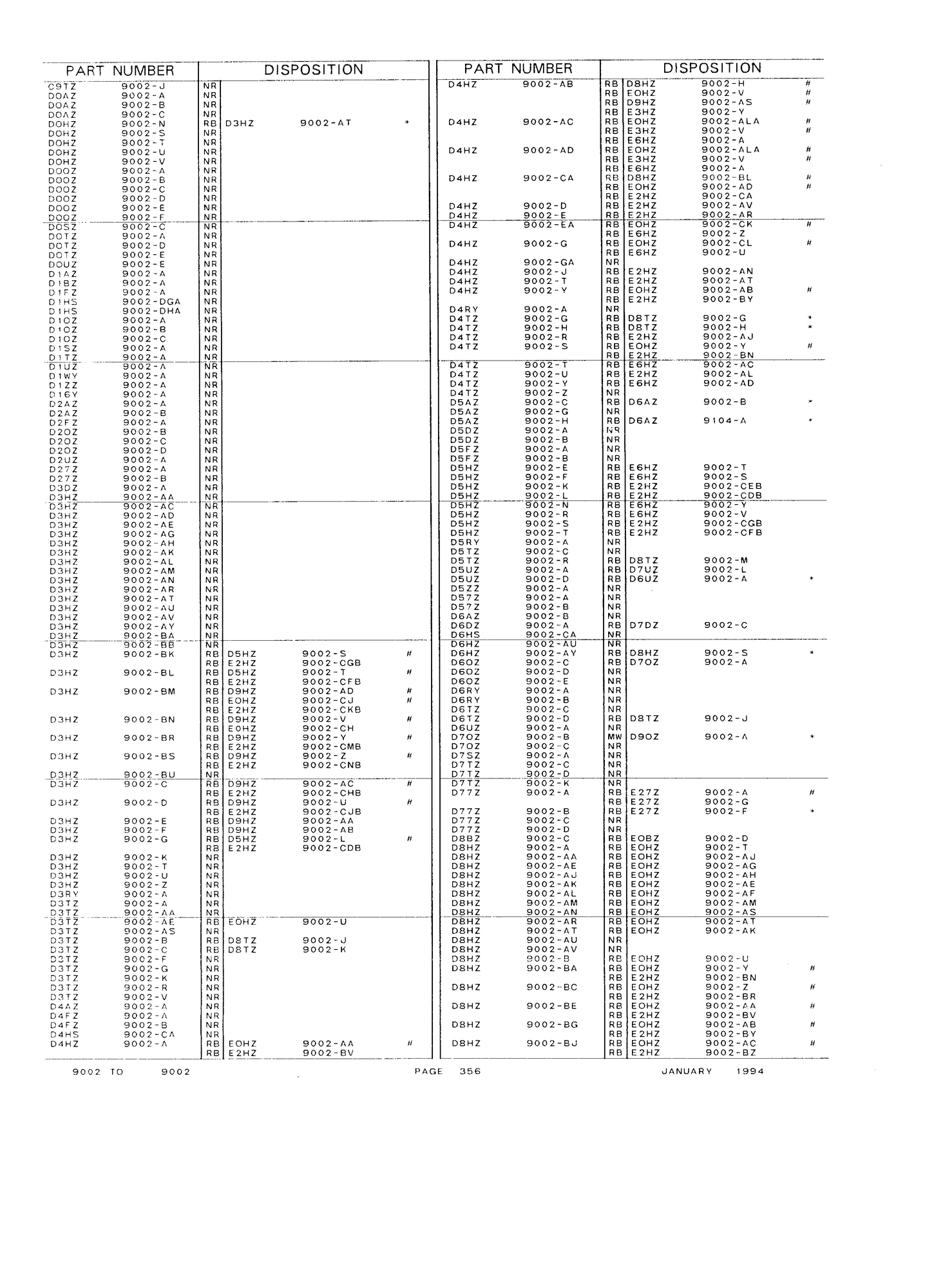

Just ran across this, may or not help. Shows original part numbers for tanks and a final part number when carried on to other models and years.

Pretty sure that 2wd reg cab (fwd of the axle) side tank is a metal tank held up with 2 straps, tank and straps reproduced. 4wd reg cab (fwd of the axle) is a plastic tank with the IMPOSSIBLE to find tank support cage that is not all rusted out. How bad you need a 4wd plastic side tank?

I think it's D8TZ-9002-G for the 78/79 F-150 supercabs. That's what I've always seen when looking for myself. I've not yet dropped my side tank but it appears to be "intact" as best I can tell.
