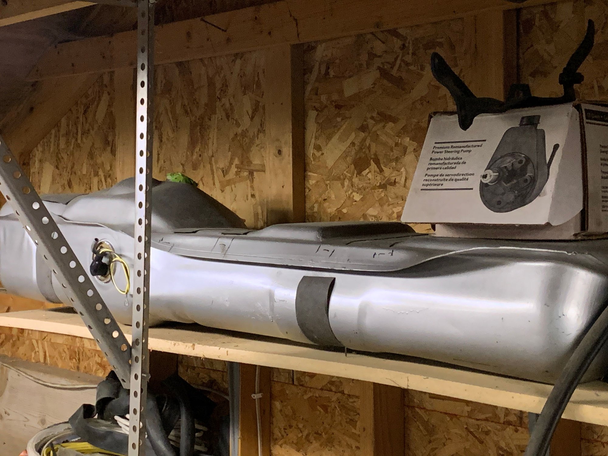

So, my thought would be that the truck originally had the midship. Even if not, it is surely capable. Do you have the dual tank bed? Since we have finally established that the supercab long beds use the same tank, it would would be worth the time to search out some junk yards in the desert and see about getting a tank. If you have yards near you, look under the 80’s and 90s supercabs. The beds mount the same so frames may be similar from cab back. They would be more likely to have a poly tank and skid plate. Definitely worth a shot. I know they used the same tank on some rigs and reassigned the parts numbers to be from the 80’s. Fingers crossed, this might be one of them.
Old Jan 7, 2020 | 09:59 PM
broktruk's Avatar
broktruk
Joined: Jan 2018
Posts: 898
Likes: 70
From: Coos Bay
If we cant find you an alternative, i will reserve my extra tank for you when I strip these trucks down in the next few months. Though I would otherwise keep it as a spare.

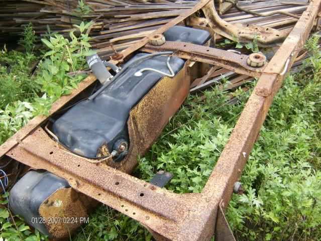

Here is what every guy needs to have in his "Ford parts lot"....oh yea that is my Ford parts lot. lol Well one side of it any way.

Hopefully someone has been down that road and can advise us. Ill still offer one of mine if theres no resolve. Long ways to ship though.
Road trip! 🧐
