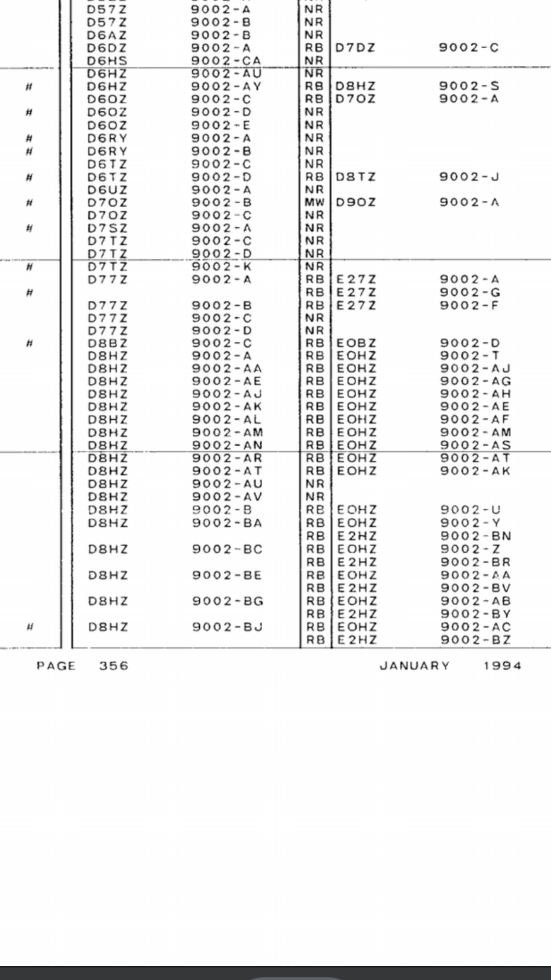

Originally Posted by fordrealdrive
Post #9 by Rich holds all the correct info...
There are two 19 gallon midship tanks for '74/'79 2wd supercab's, 1 with evap & 1 without.
& there are two 19.5 gallon midship tanks for '78/'79 4wd supercab's, 1 with evap & 1 without.
These tanks are NOT interchangeable between 2&4wd, & also the sending units are different between 2&4wd supercab midship tanks.
All supercab midship tanks are extinct & not reproduced.
Im sorry, I just don't see it. I couldn't find any of the listings that say supercab 4wd. Looks like they all say supercab The D4-G and D4-H were reassigned numerically to D8-G and D8-H. Maybe you can help with the part number because I keep looking and just do not see it. Please/Thank You

Right, thats all i saw. There’s no distinguishment between 2wd & 4wd which lends it to seem as all inclusive, esp since theres no 4wd mentioned elsewhere. If we refer to post 7, The D8 is the reassigned number for the D4 parts. Same part, new number.
Seemed to be the consensus. If im wrong, can you help me to understand please.

Crow? Theres a season on em here. Besides, our sole purpose for being in these forums is to learn. I am far from expert on anything thats why i ask about the cross-over. I will provide the exact source for that when i get to a pc. From a ford book with 80s or 90s date of update. Should have done that from the get go, sorry

Ford 100-500 MPC, pg 356 is the source. Update is apparently JAN-1994
