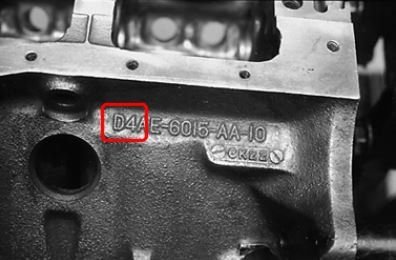

how do I find when the motor was built , numbers on block , where to find what they mean?
These letters are above the starter
More info on what the characters mean: https://www.enginelabs.com/engine-te...ers-1952-1996/
Casting codes on early 302's are located behind the starter on the right side of the block. You need to find the cast identifier/engineering number, and the date code that looks like a little tag screwed onto the side. The info in the "it still runs" link above isn't entirely accurate.
In the above photo, the engineering number starting with C5 shows the engineering was done in 1965, but the date code 7A25 shows the block was cast in 1967 January 25.
