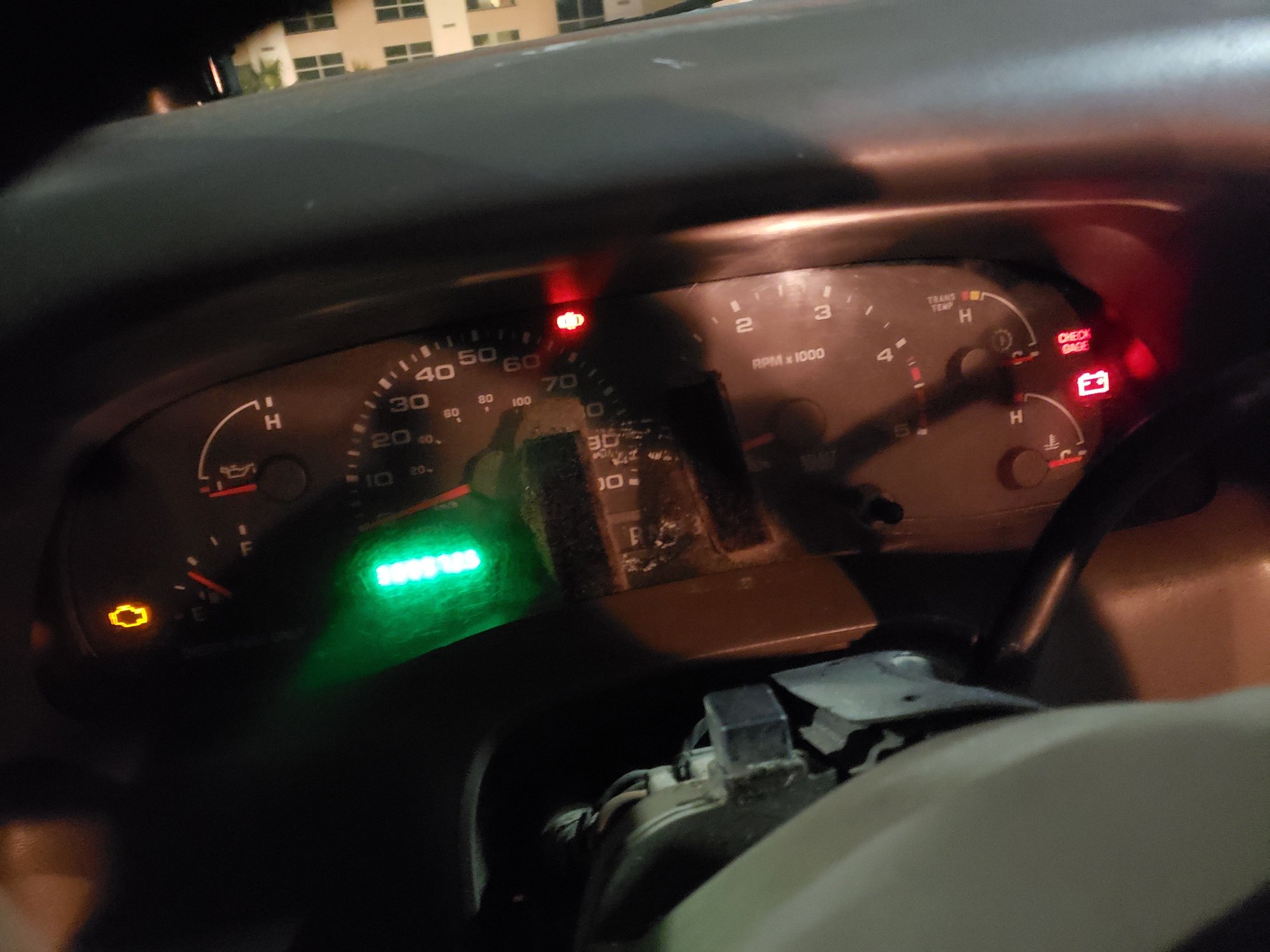

2004 F350 4x SWR 380k miles
Short story - key off and out there is some power to the dash, a few dash lights and odometer stay on but super dim. Then randomly acts as if key is in the run position, headlights on (auto position) radio comes on. Dont hear the injectors clicking or fuel pump running (I really wasnt listen for then either).
Beginning last week the door chime was coming on even with key out. A banging on the steering wheel made it go away.
I am at total loss on this one

a little update for my problem of the same kind long story short, had my alternator and both batteries replaced this week and my cluster is working like normal again.
checked the alternator and saw 17+ volts and later on the passenger side battery started to off gas from being over charged. I know you said you had a new alternator put it but you might want to check on it or the pigtail.

Sorry guys I fell like a chump for not reporting the fix.
I ended up replacing the alternator plug and all was well
.... until today but I think its related to another issue, I came back to this to see if there were more suggestions (being it came back) and realized I never reported back on the initial fix. Once I fix my other electrical problem I'll start a new thread on it if it continues.
