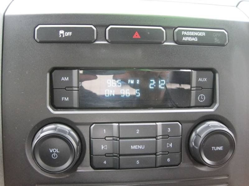

Like this?
I have seen a few XL trimmed trucks out there with no factory camera or backup screen to add one. Just the radio there. Looks odd when you see it.
