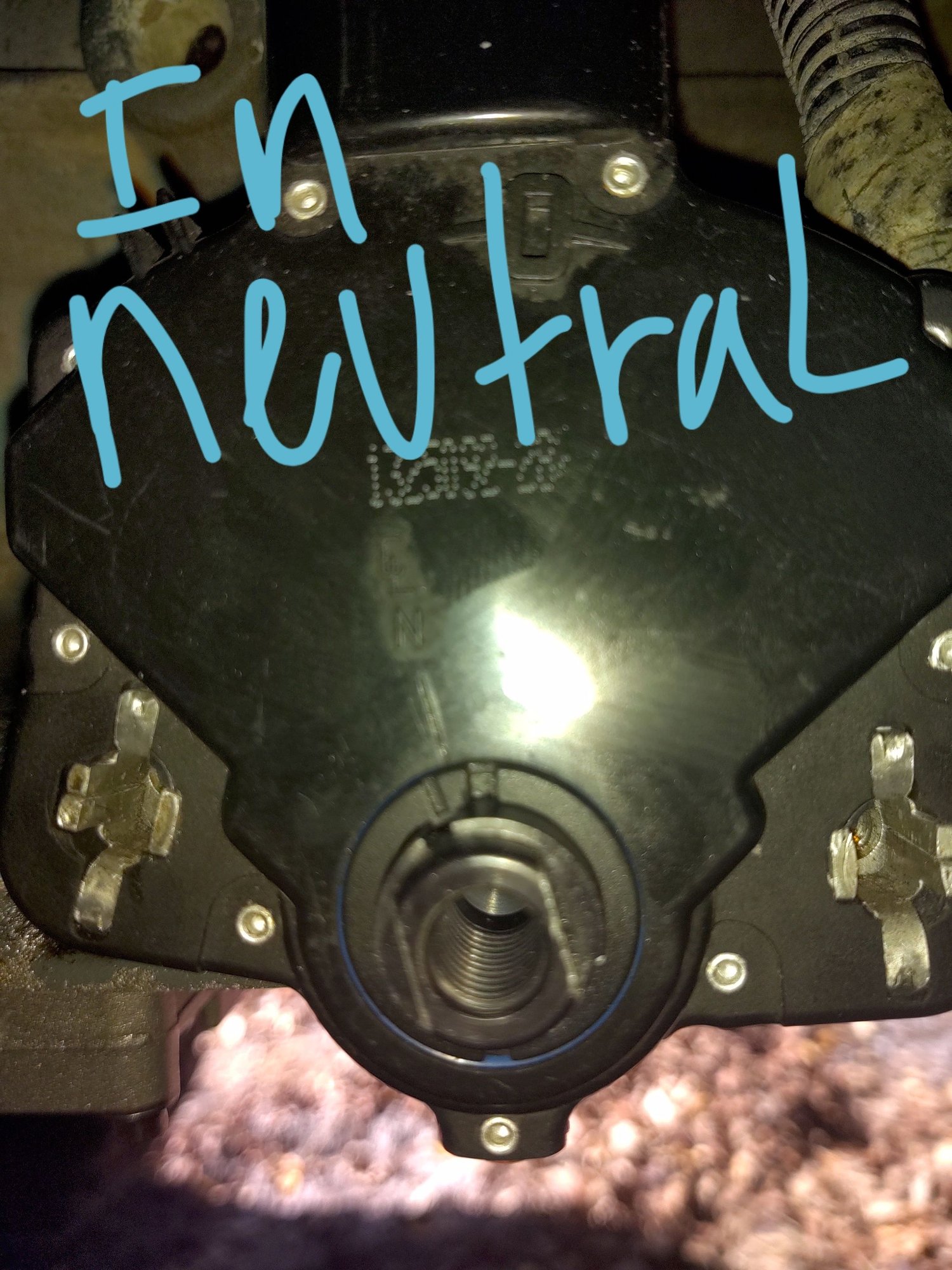

Oh I see. So maybe your just thinking the trans is in N position when it's really in R position is my guess. You can unhook everything and start over.
Unbolt the range sensor and remove it. Shift the lever into park (making sure to move the lever into the correct position, not into 1st) Hopefully you're on level ground with the wheels chocked and or at least the e-brake set.With it shifted into what you think is park,rock the truck back and forth to see if the truck can roll wit hthe e-brake off and wheel chocked moved away from wheels a bit.If your in 1 then go the other way lol.Shift the trans lever back a click from P into R then another into N.With the range sensors marks lined up,now install the sensor and bolt it down, then install your shift cable and adjust as needed to line up with your shifter.

I have already disassembled the whole thing put it back together I am in the right gear looking at it from the driver side of the truck the shift lever is point left and down slightly them P R N I have even gone all the way back to first and moved up in gears 1 2 D-overdrive N R P I don't know if this will make sense but it's like it's off a gear or something like I said I could bolt down the switch with marks lined up perfect in R but if it's in N with the marks lined up the switch isn't in right position to bolt in

This is in neutral with marks in line I'm sure this is neutral I have rolled the truck but as you can see my bolt holes are way off now say I put the bracket on for the shift linkage and shifted it into reverse the holes line up perfect.

Jarrard7 let me save u 6 moths
I have a 65f100 with a1990 460 e4od and a b&m megga and a 1990 wire harnis.
first thang first e4od combined with a mega ****er
Needs a extra b&m install kit
This kit is about $80 it includes
A bracit to mount cable
new shift slecter rod (the one that gos through the trans case and new **** lever to conect shift slecter rod at one end and cable at other end.
Will this help with your nns not lining up? No
But it will make ur detent I each gear super solid
And all linkage will fit and adgust easy.
now for the nss I had to cut the rear facing bolt hole out the bottom and tern the hole into a slot
When u cut the slot the nss will adjust but only the rear bolt will fit.
