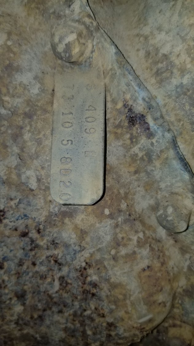

I have an E99 f250sd. Limited slip went out in rear axle. Need to buy a new diff. Recommendations? Also, need help decoding my diff tag. Pic included. Axle code is C1, 3.73 limited slip.

10.5" ring gear, 3.73, limited slip. What else do you need? Have it rebuilt.

Sterling 10.5, 3.73 limited slip
My recommendation is Detroit truetrac

This is what I plan on going for too. Truetrac's are a clutchless LSD.
