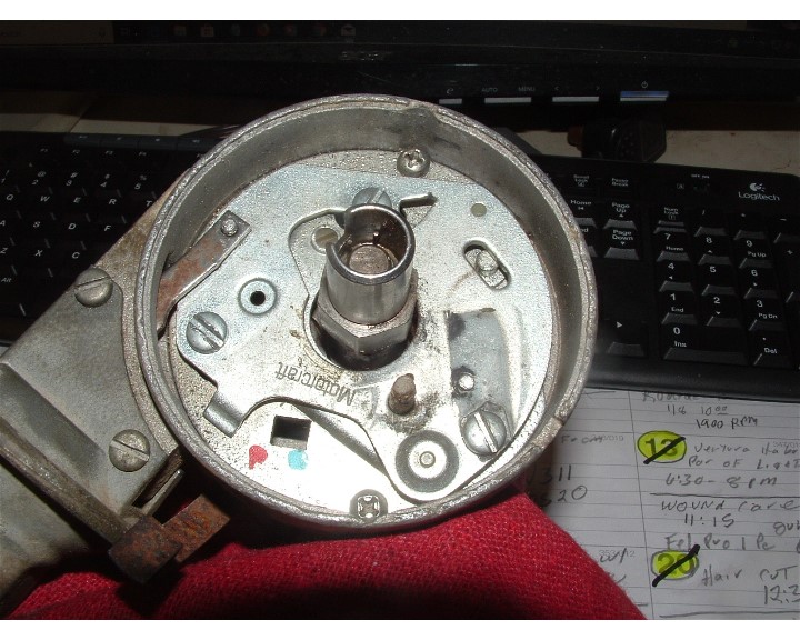

A couple pictures of the main body distributor shot & one of the inside top movable vacuum advance plate with the original single vacuum advance connected.

Notice in the pic the advance plate and slot is riding on top of the post, it won't move freely that way!

Tedster9 -- Ya I just put back the parts to take some pictures, plate was not on top pin when I took it apart. Picture is with the spare cap from my 1971 300 4.9L inline 6.
