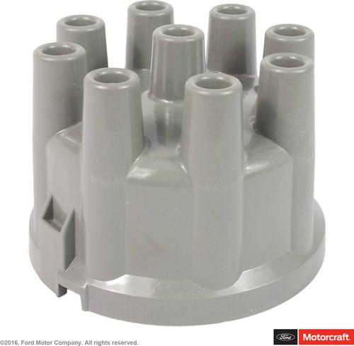

The distributor cap shown in your original photo is a D5AZ 12106-A (introduced for DURASPARK) which had greater dielectric strength than the B7A 12016-A.
If you go to the D7TZ 12106-A (which is spread terminal to prevent cross-firing...
...you will also need cap adapter E3TZ 12A217 A (DJ-8).
This cap also takes wires with different terminal types @ the cap terminals.
The cap you pictured is part number E6TZ12106A. Like this.
The D7TZ12106A (gray) replaced the D5AZ12106A (BLUE) The D7TZ12106A looks like this.

The distributor cap shown in your original photo is a D5AZ 12106-A (introduced for DURASPARK ) which had greater dielectric strength than the B7A 12016-A.
D5AZ-12106-A (replaced B7AZ-12106-A Hi-Po) .. H/D Dizzy Cap
D5AZ-12106-A is blue .. B7AZ-12106-A was brown and was used on all 1957/74 Passenger Cars with Hi-Po engines.
I sold a B7AZ several years ago to a guy w/a '66 GT350 for 500 bucks.
