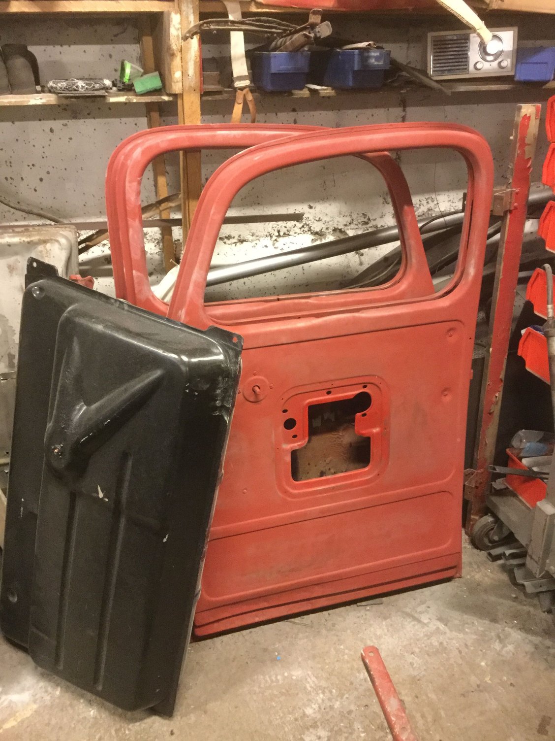

Taking off some old paint from my doors...someone have repainted them long time ago...2 layers of red paint. It Wasnt raining today...glass run and channel kit are in order from the states.

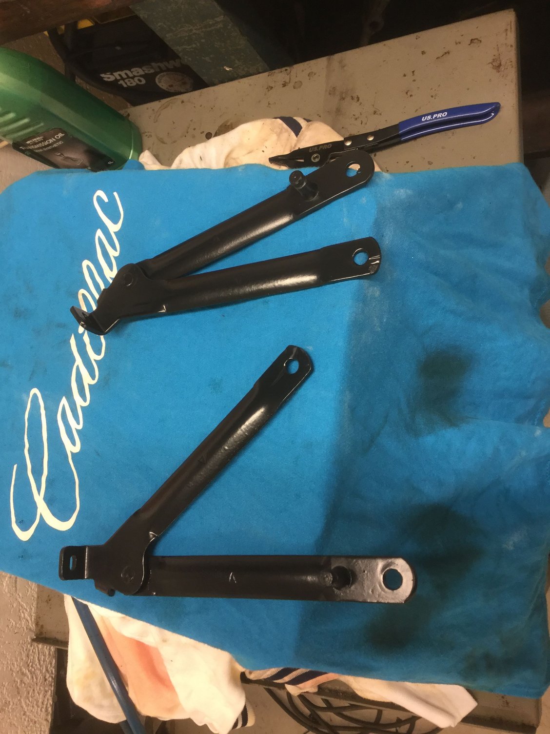

Fix and paint the hood hinges to... its nice to brake up the big jobs with some small detail jobs in between..... Waiting for parts for my cadillac trans....

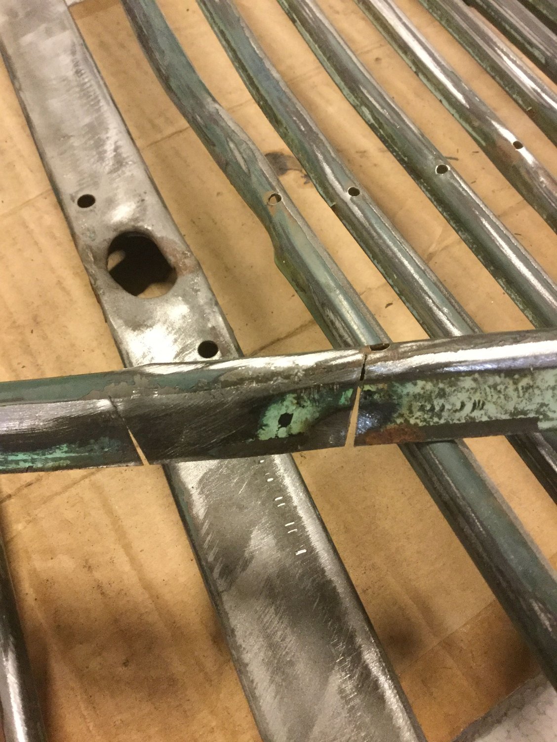

Decided to cut out some of the ribs in the grille..need some strighten and some welding in some cracks...
Fixing the ribs was harder then i first thought.....the steel had been streched...so i had to cut out some material..some welding there.....i think its not a big deal....i will never get them perfect...

Got a package today with the window running channels kit....Yes , i have doors from a 42 model....the difference is only that on the 40/41 models there are no window frame on the glass....so...but i have glass for the 40 mod doors,its possible to build back later.

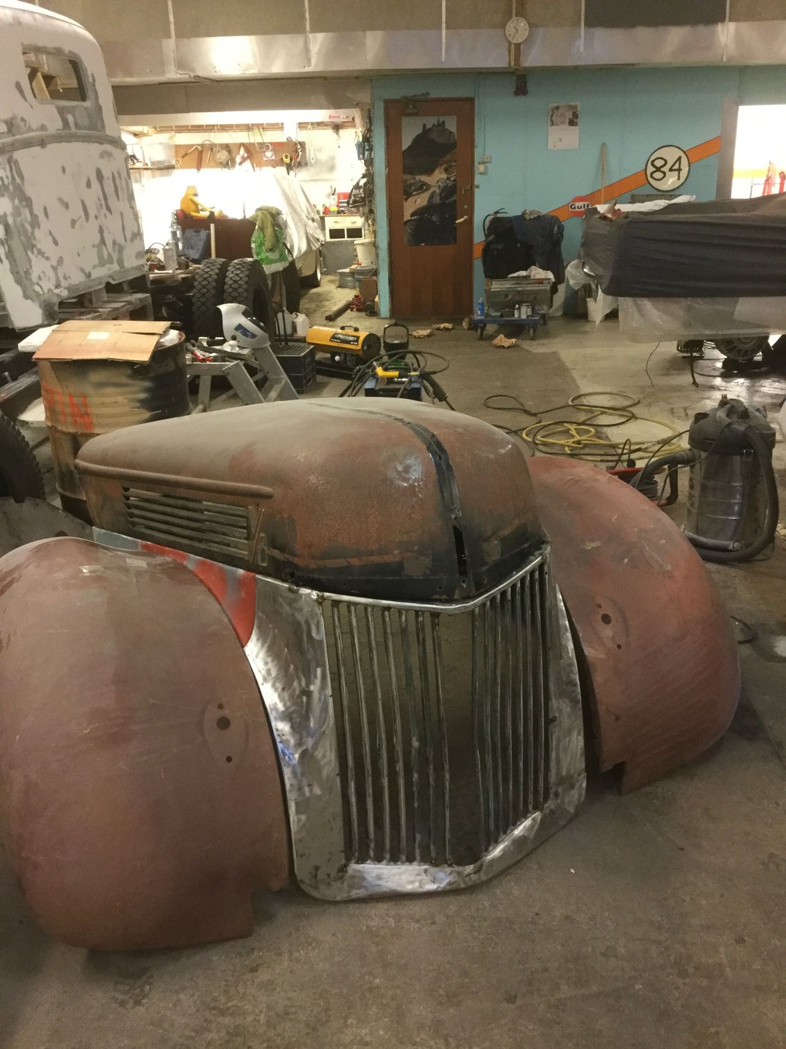

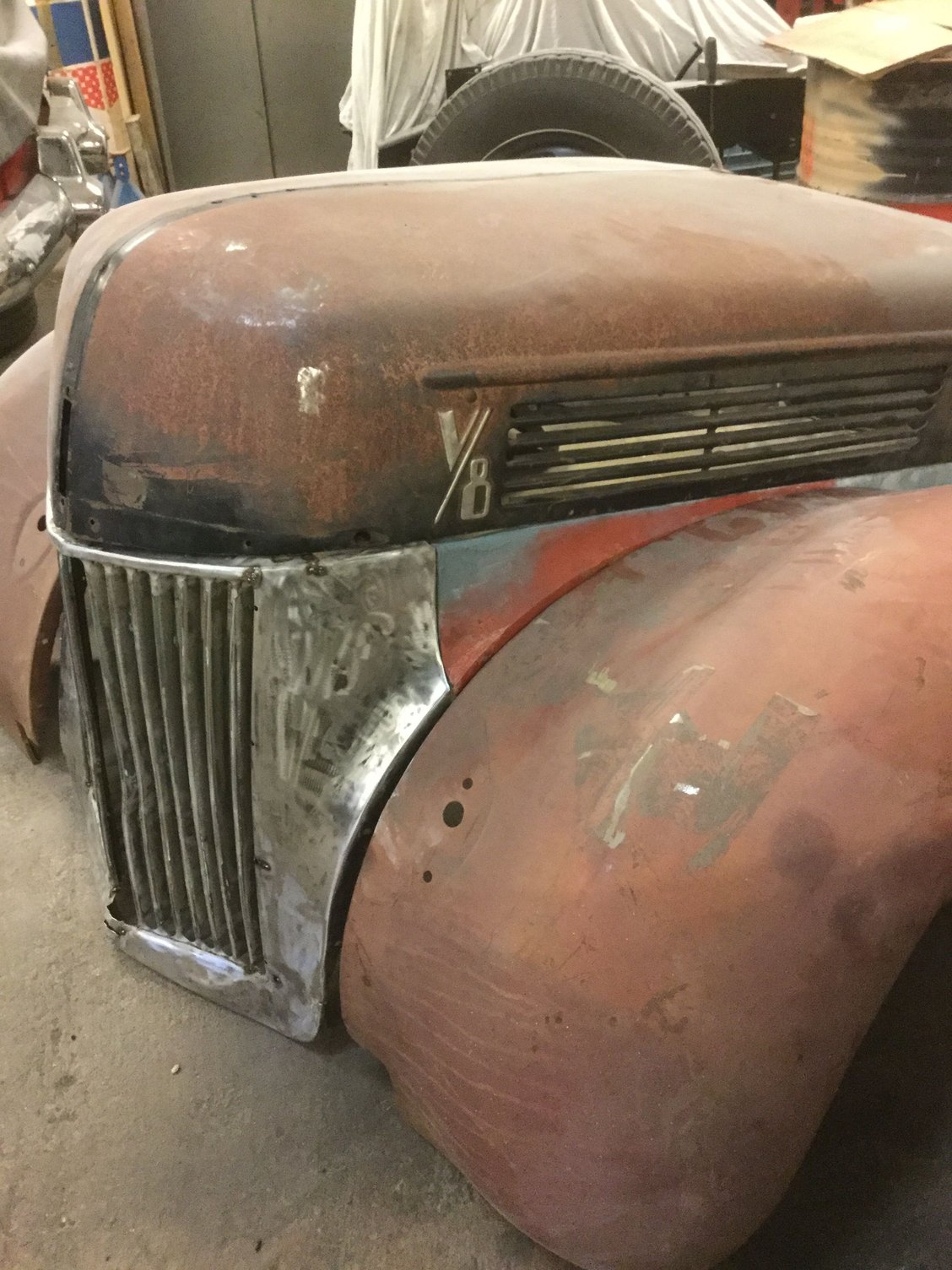

Little testing....i see that im going to need a little help when testmounting everything before painting...i need to make new holes here and there😹 the fender aprons and the fender does not align very good with the holes....
Spotwelded the 2 grillbars that i cut out few days ago and sandblasted a little....will wait with the center bar to after testmounting...noticed that im missing 2 crome trim strips too...

You have to wonder how the truck was over-run by a plane! Possibly a take-off or landing in fog?
At any rate, don't drill new alignment holes in your fenders and grille before doing a mock-up for fitment issues
upon FINAL assembly. LOOSELY assemble the pieces, with the aid of a friend, and if possible, only elongate
(lengthen) the existing holes if needed. These sheetmetal front pieces can be difficult to align, especially the
mid-thirties cars with their 4 piece hoods!
Good luck!

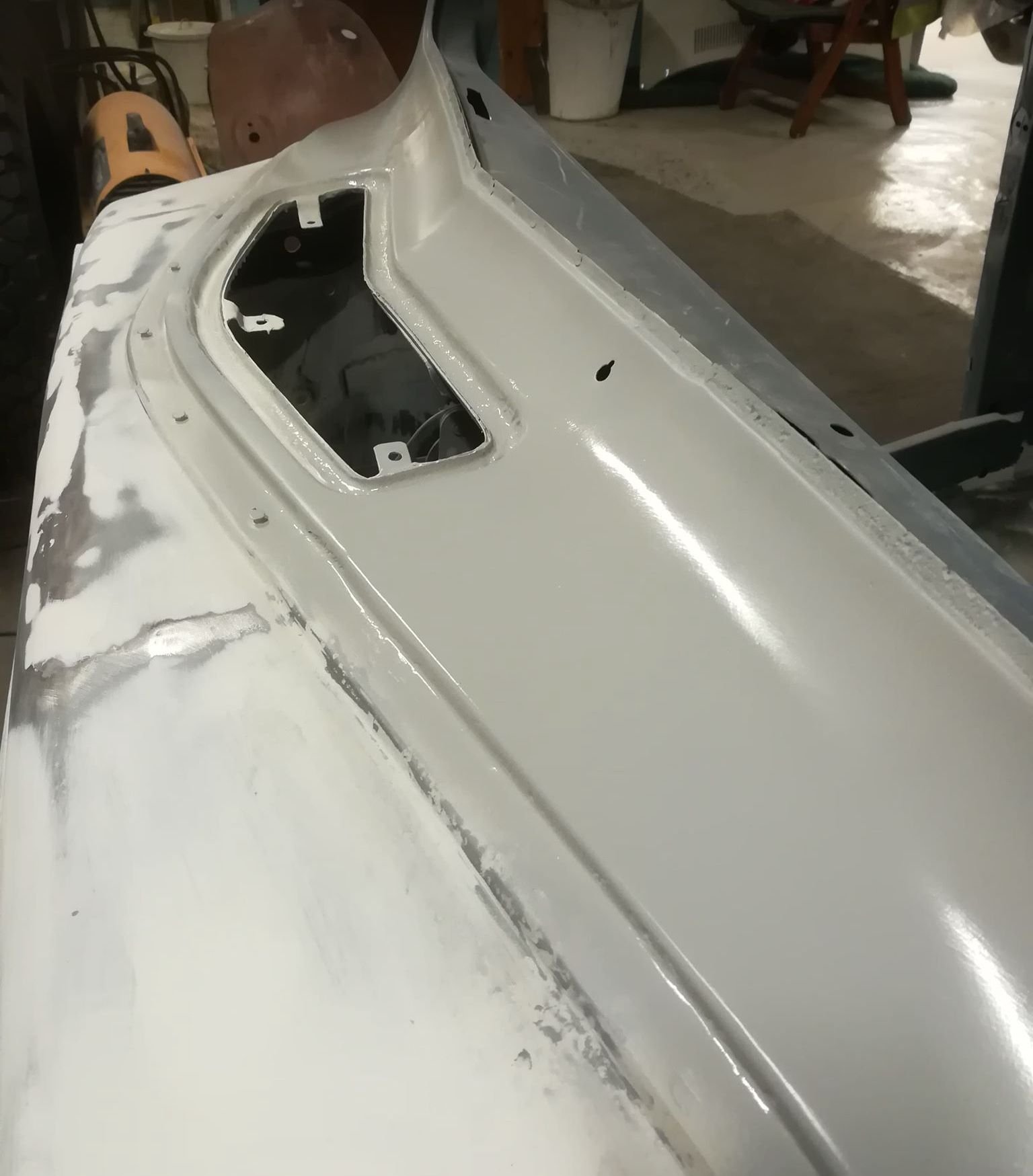

Put the cab down on the floor on a pallet, easier access to the rooftop.
The vent was rusted away, so i cut this one out of my donor cab, and welded it in...ended up quite good.
