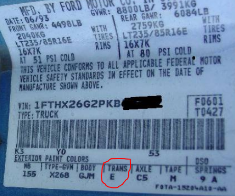

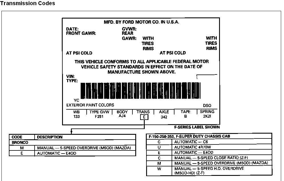

check driver door jamb sticker
pic courtesy of subford
pic courtesy of rla2005

Trans Code U is a 4R70W
1995 F-Series Transmission Codes

Cool. I have a trans U
