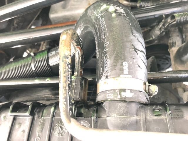

My brothers 6.0 has been overheating almost every day lately and pissing out coolant
truck has the following done
egr delete
head studs and gaskets
new radiator
new degas bottle
water pump stress test was fine
while cruising at 70 on the interstate the truck will be fine and then coolant will jump from 194 to over 200 and oil will jump from 198-202 to 300+ within 30 seconds and my brother has to race to shut the truck down
ford dealership wants to put a new engine in rather than try to fix the problem
when the truck gets hot, it’s pissing coolant out the bottom of the radiator by the time he gets to a stop
photo if bottom passenger side of the radiator, there is a small high pressure stream of coolant coming out from between the metal tube and the radiator hose

Looks like a pinhole in the plastic tank. I'd replace the radiator first, and while you're at it, replace the thermostat as well. Might also want to verify the electronic fan clutch is operating correctly to engage the fan when needed. I had a very slight leak out the side seam of mine that was also causing an overheat condition, though nowhere as severe as what you're seeing. I went with an aftermarket aluminum radiator rather than a factory one with the plastic end tanks, but did have to modify the trans cooler fittings to make it work.

That radiator needs replacing from the pic you posted (is it the old one or the new one that is squirting coolant?). Also, remove the oil filter and check the standpipe for deformation as Rick is suggesting (melting or softening plastic).

Just for giggles, make sure the radiator hose isn't collapsing.

Is that green coolant I see or are my eyes playing tricks?

Are we looking at green coolant or is that a photo issue?
