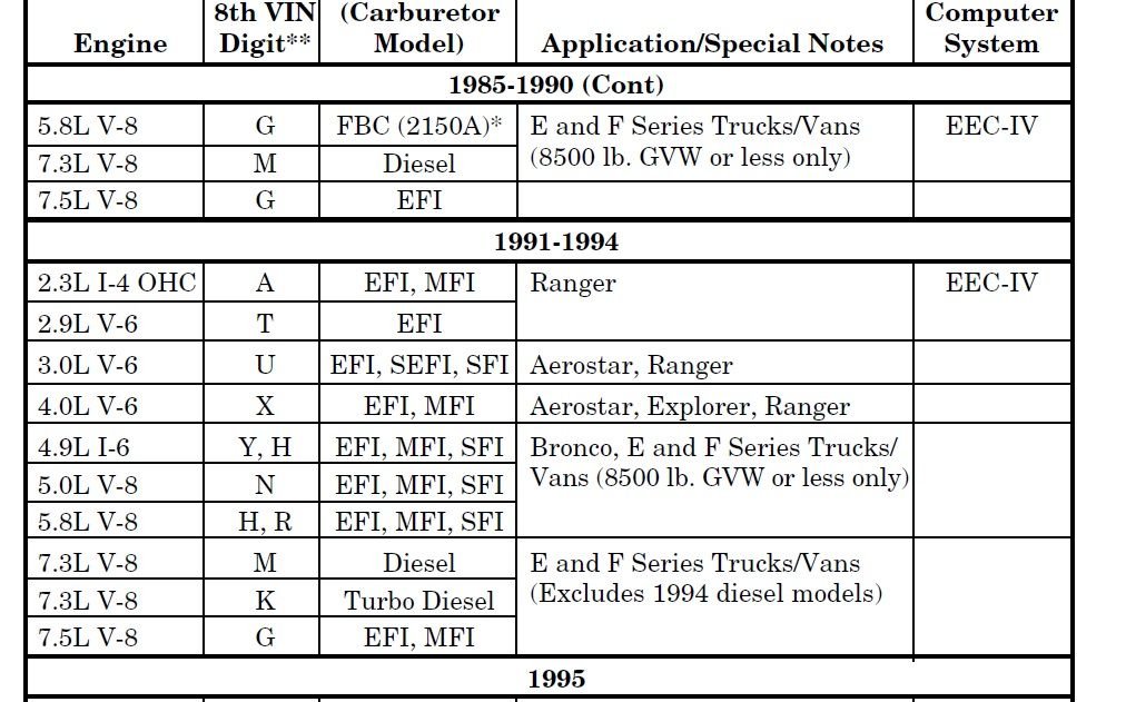

Personally I use the MT2500 ... BUT the Innova 3145 works just fine too and is tested on our trucks.. runs around 20 bux.
Many of the other ODB-1 Scanners will not read Transmission codes from our trucks.
or you can just use the manual method for Free as linked by others in this Thread.
EDIT: ... you can get the Innova Manual here, IF you want to check it before deciding ===>> https://www.slideshare.net/TimMiller...nova-3145-ford

Good manuals
hey there no where in that manual was i able to find my truck. The 8th charecter in my vin is a k. I found my truck but it says all diesels except for 1994.. was this a bad year to have.. thanks for the help. I still cant find my eec and not sure whats goung on with this.

the Manual does in fact List "K" Remember that only the First Half of 94 was IDI the 2nd Half was PSD and it was OBD2
1994.5 should be Excluded as it is PSD and No Longer IDI but your IDI is supported.

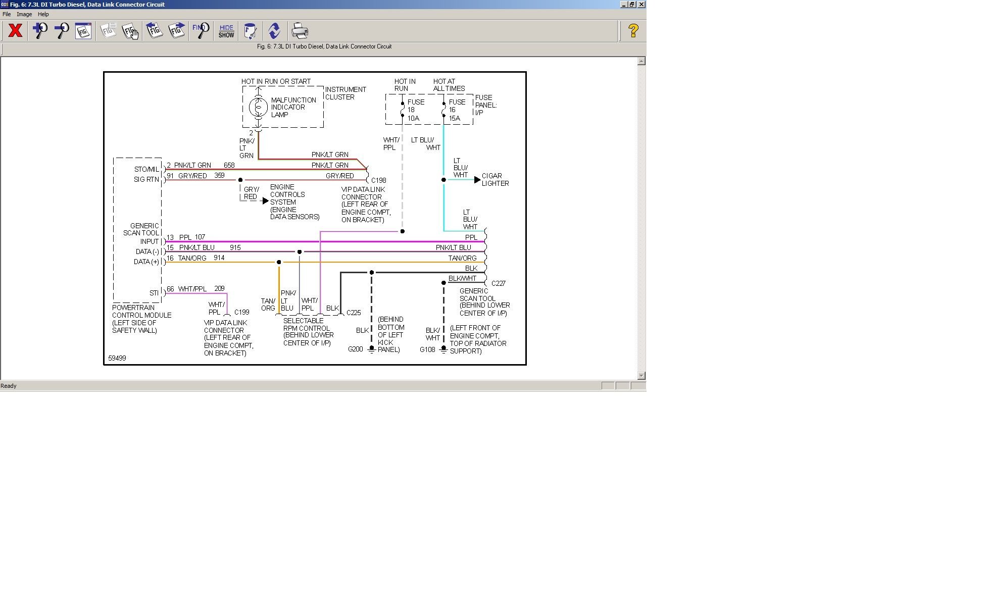

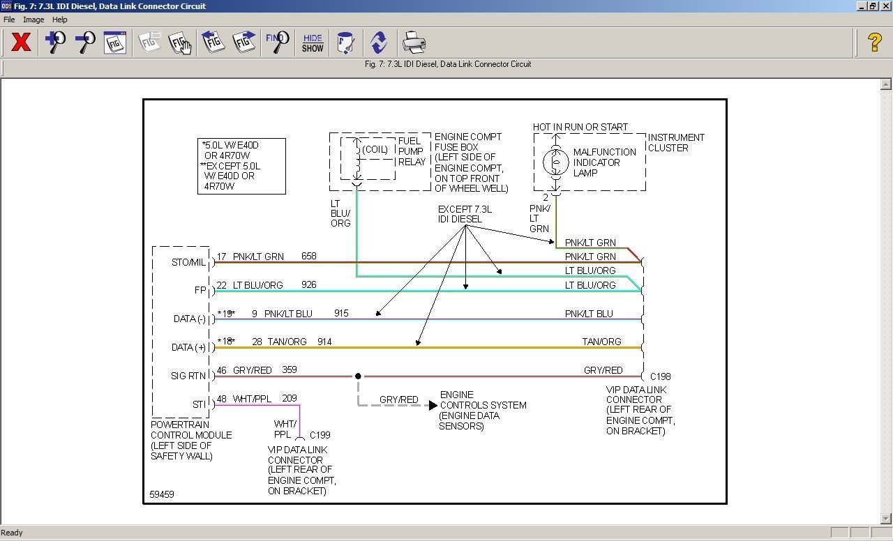

these are the 2 Configurations for the Test Connectors in the 1994 7.3 Diesel
The First is IDI the 2nd Image is the DI

I'm no good at reading those. Like before this truck all I did was oil changes and brakes. I used to pay someone always. Since October 1st I've been a single dad my daughters mom was killedby some dick.. anyways i cant afford that route anymore with daycare. So im trying to learn how to do my self. Half those parts i dont have a clue what they are. But it sounds like your thinking i need a new transmission i guess I'm ****ed.. thanks anyways I eeally do appreciate the help.

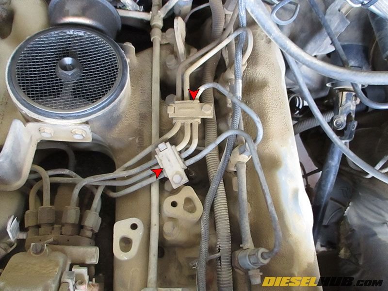

the IDI engine looks like this...
it has the Fuel injection Pump up front with 8 injector lines coming from it going to the Injectors.. the DI engine will not have that Pump and all those Lines going to the injectors...
the Top of the DI aka PSD looks like this image..
