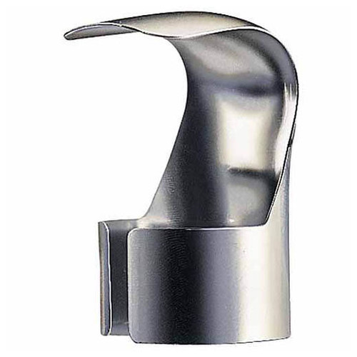

I use a industrial type heat gun with this attachment , keeps heat contained and lets it heat smaller area so solder melts and yes you do have to get the heat up high for solder to melt , but any way you do it will work , the heat shrink is always good either which way you do it

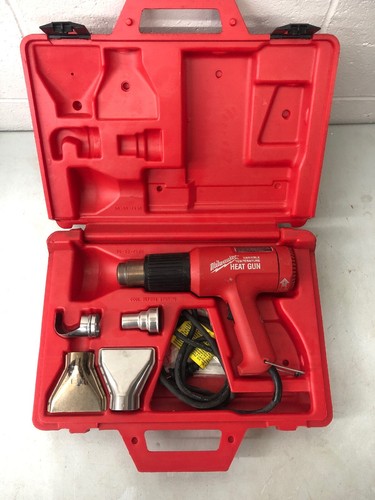

No I wouldn't use a torch either in that area , but a real good heat gun will melt the solder , I bought one of these off ebay, its Milwaukee 8977 Variable Temperature Heat Gun , for like $45 used,,, and its paid for itself several times over on my project , and comes with attachments ,,I love this thing ,
