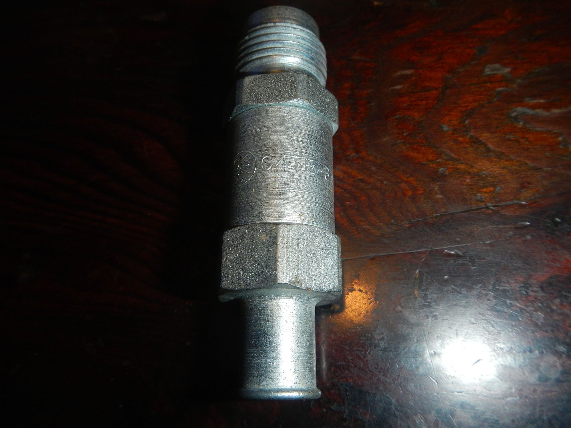

Just got this one off Ebay NOS C4TE-6A666-A . The old one was just a free flowing hose connection and not serviceable. I was getting 15 inches on the vacuum gauge, this new one is pulling a steady 20. Motor is a 1963 260 V8.

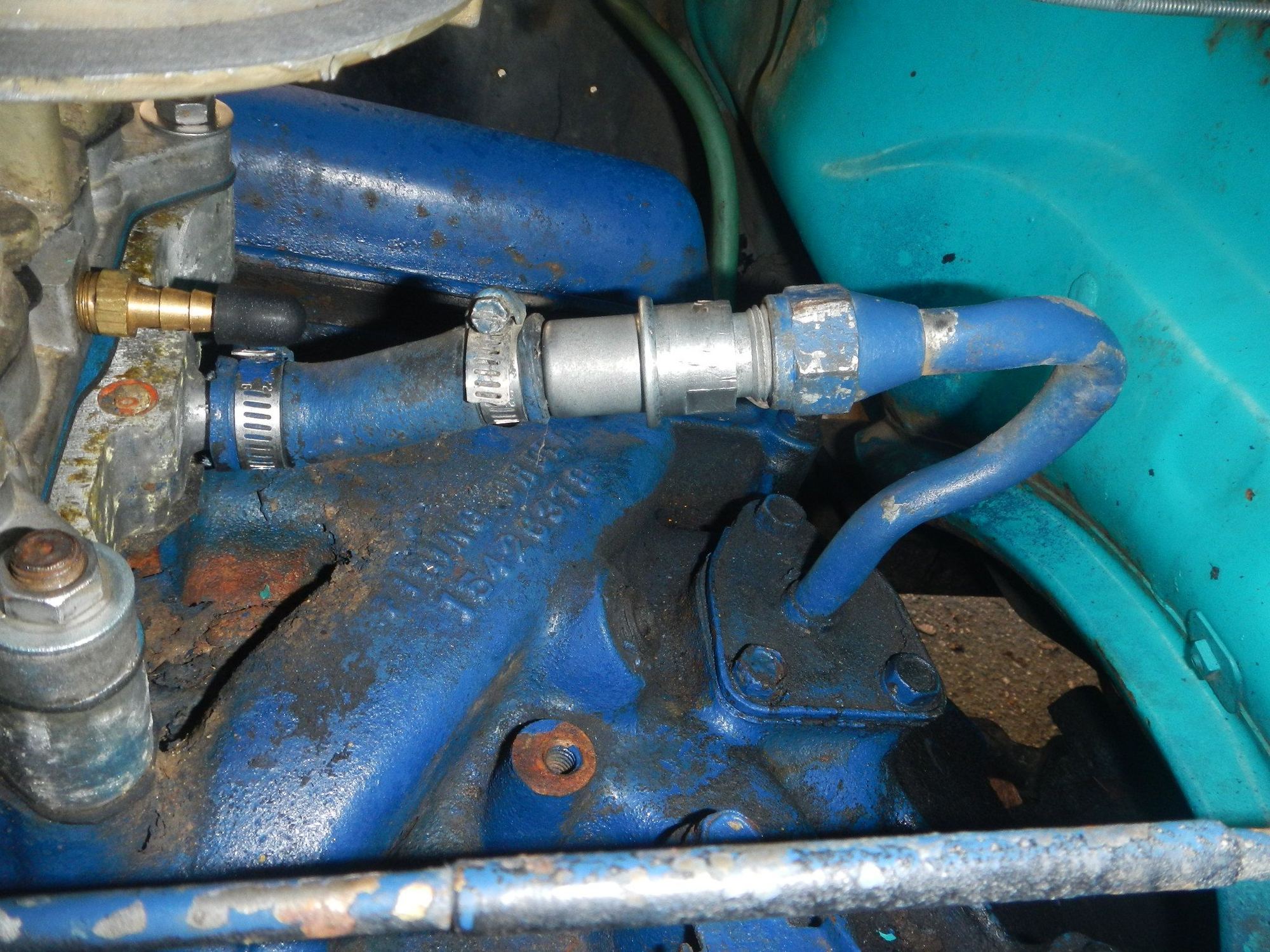

Originally Posted by LVExp
Finally coming back to the PCV valve after working on rebuilding the heater box.
None of the part numbers suggested in this thread or suggested for the 1965 F100 300 in the "Ford Truck Parts" book match the PCV currently installed, specifically the bolt section of the PCV in the picture above below the hose.
Next how do i remove the above PCV? I've tried unscrewing it and lifting up on it but nothing will get it to budge so i can check it for part numbers or if it is rebuildable.
The grommet in the valve cover has turned to stone. Easiest way is to take the valve cover off and cut it out. You can get new ones at any parts house or Dennis Carpenter, NPD, etc. You can clean up the old PCV or replace it your call.
