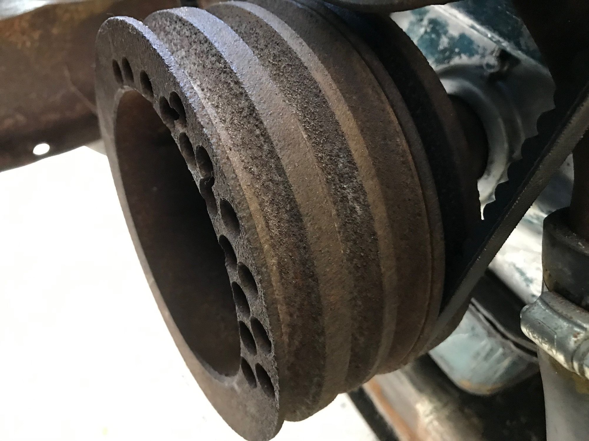

Just a note: Sent back the CompCams timing set and the dowel still acted like the first set if anyone was wondering.
66v8baby: Below are the pics of the pulley I have.
