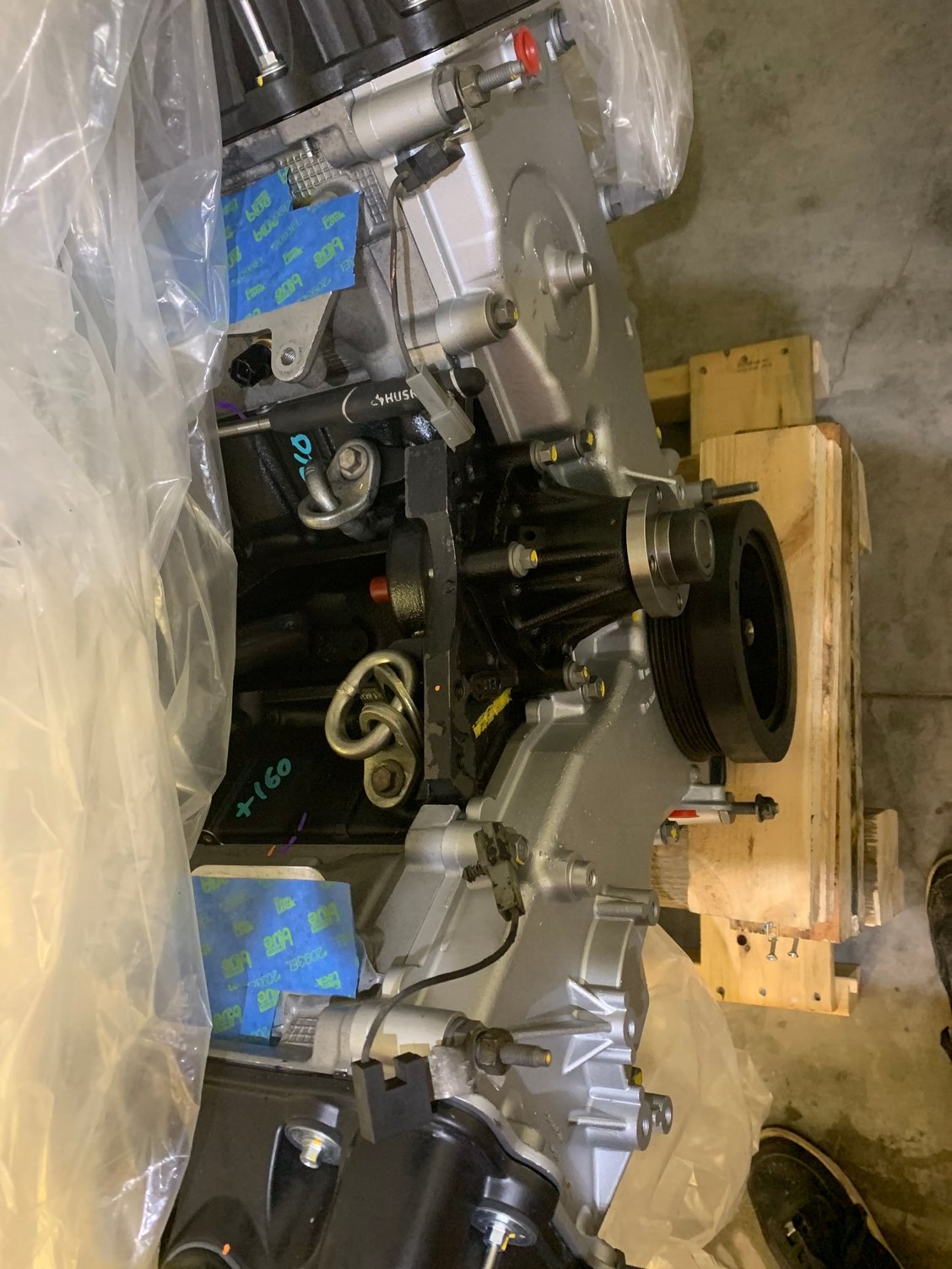

2 sensors look the same 1 wire connection there is continuity through the harness and they both go to the same pin at the connector on the end pigtail. The reason I am asking is the harness I got off of eBay has only one sensor connection versus 2 on the old one. I can wire in the second sensor if needed they appear to be in series. What are they? Why 2 versus one? Thanks

I don't think those are sensors, I think they are to reduce Electromagnet Interference (EMI), so you don't get static from the COPs on the radio
They are probably just a capacitor.
I wonder if they connect to the +12V supply side of the COP wiring?

I believe you are correct. It is a red with green stripe wire which apon closer inspection of the harness also goes to each of the coil pack connectors. So it must reduce or dampen something electrical. I need to find a wiring diagram or open the old harness to mimic the new harness to the old. And verify if it is ground or battery positive. Thanks for the info

Those are exactly what Krewat said they are. They connect to the +switched battery voltage that feeds the COPs.
