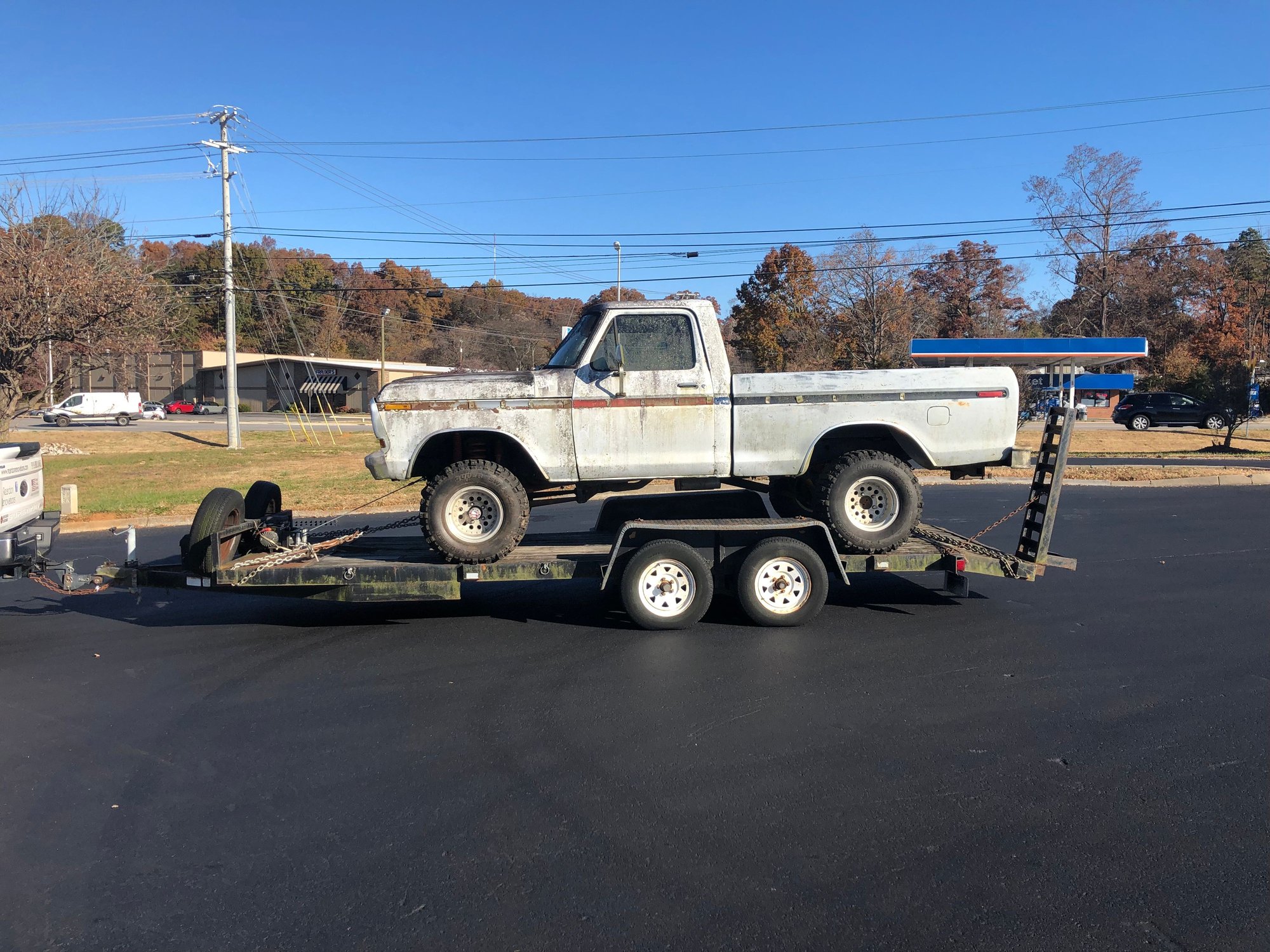

Hey Y’all,
i just picked up a 1978 F150 and was a bit confused about a few things. I used the link for looking up VIN from an older thread but still am confused. My VIN is F14SNAE8119.
the F14 means F150
S is 400ci motor
N- Norfolk (?)
AE8119??
any ideas?
Joe
