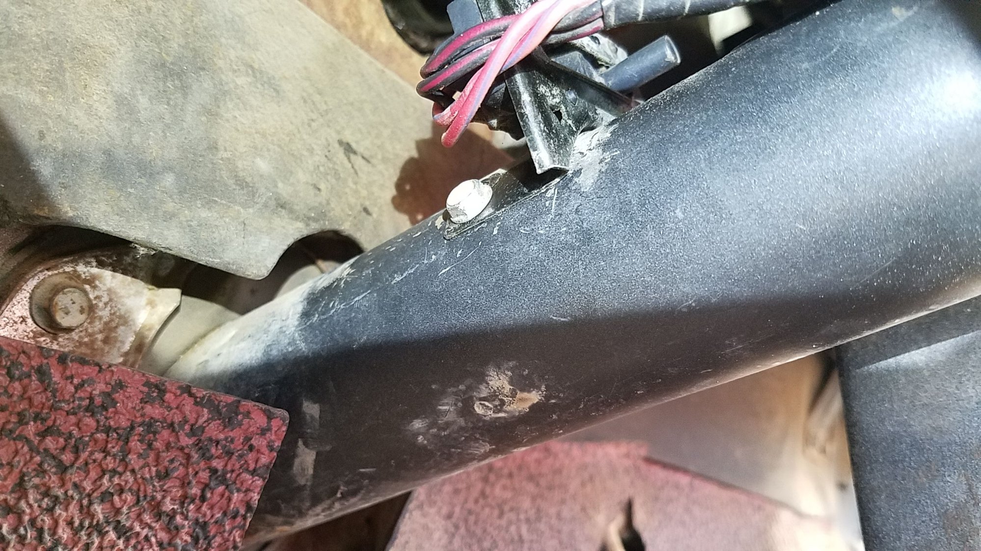

1) My NSS was not hooked up, found the connector under the dash with a jumper my dad made, removed the jumper and plugged the NSS in and it did not work! Figured that's why my pops made the jumper. Upon further testing, I can move the button on the NSS and the truck will start. How is the switch suppose to move to the correct contact position? Is there a piece missing in my puzzle. There is a hole in the column bu the switch but I don't see how to make it work. Pictured added of actal switch on the column.

NSS switch. What moves the ****?

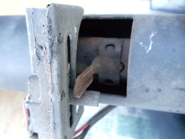

Regulator wires.

NSS shown as 7A247 in pic. The NSS selector lever is shown as 7B097
This snaps onto the shift tube thru a hole in the steering column shroud, has a knife blade end that fits into the NSS
The knife blade end is notorious for snapping off.

Like Bill said, there's a selector lever that clips to the shift tube that actuates the neutral start switch.
The part number you need is D0TZ-7B097-B Lever, transmission control selector neutral

The first thing to check for the charging system is, with the engine running, what is the voltage at the battery?
If it's 13.5v to 14.5v your alternator is working, and it may have been replaced with a later model internally regulated alternator. Or even perhaps a "1-wire" alternator that needs only the one connection to the battery.
Post up a pic of the alternator and we may be able to tell just from looking at it what it is.

Oh, and while you're testing wires with your volt-meter, check that Yellow wire that's loose next to the regulator connector. If it's still connected at the other end it's hot all the time and could short out on the metal it looks like it might touch.
If it's touching and has not sparked already, there's a good chance it was disconnected at the other end. But it's still worth checking!

Upon further testing with the multi meter today, the battery was at 12.2v and when started dropped to 11.7. Put the wire into the harness and plugged it into the regulator and started it again. Now 13.9v going to the battery. All is good now with that. As for the NSS, I got the piece off of the shift linkage and need to order a replacement part.
