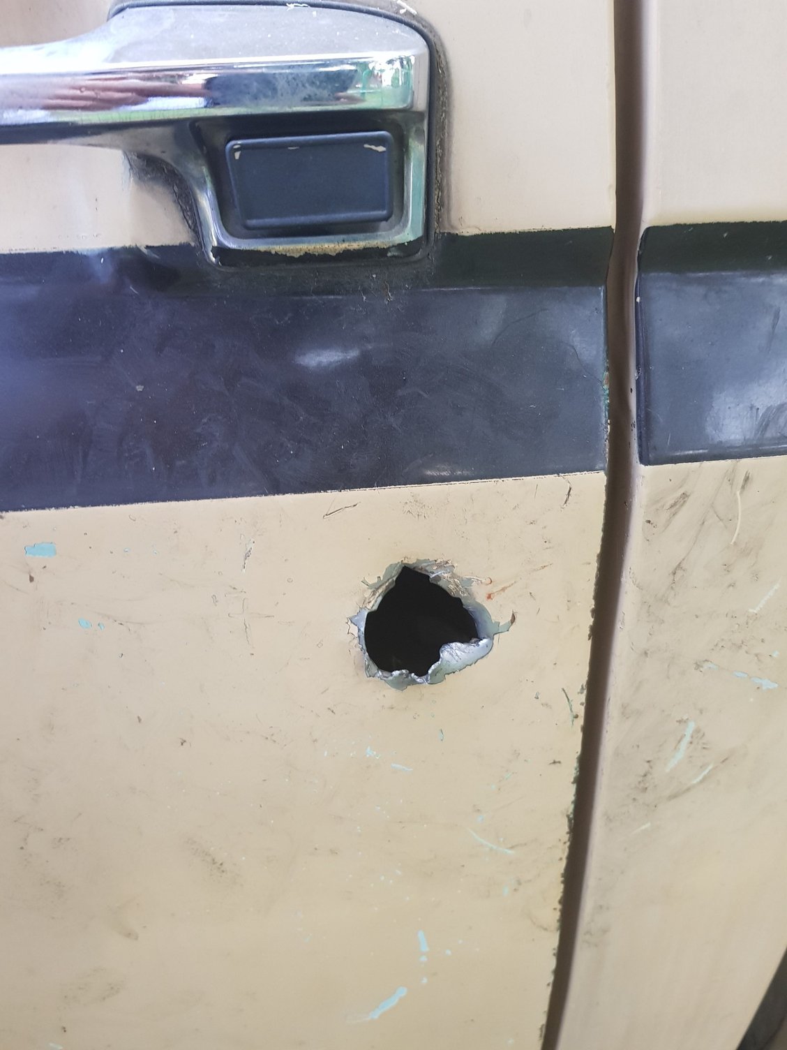

Everything is going great, until a damn criminal wants to steal your battery and makes a mess.
Please be careful where you park your truck!

Well, that's a rip. Do you have insurance?
I wonder if you could get the sheet metal close enough to original with a little hammer and dolly work. Maybe a large thin nylon washer could help hide the damage.
Is the lock cylinder missing? Here's a guide to replacement. A new lock cylinder wasn't expensive at all, and is easily rekeyed to match the ignition key:
https://www.ford-trucks.com/forums/1...-same-key.html

Hey Karl, this truck has a basic insurance, so don’t cover the mess that person had done…
When I have some free time (work and family first &#128522, I’m going to try to made some sheet metal work trying to return it their original place, by the way, thanks for the links, they will work fantastic for me at this moment.
Update. - Yesterday I found in the bottom of the door the lock cylinder and put it back on the door, looks so bad, but well that’s a first step in the way to put it back in a good looking and working lock.

Check on line for lock repair patch panels.
you cut the messed one out weld in this patch, finish it off and good as new.
Or find a door the is bad, dent or rust and cut the lock area out for a patch.

I don’t know why I don´t thought on a new panel patch thanks for the advice; maybe the frustration and anger made me lose that good solution.
