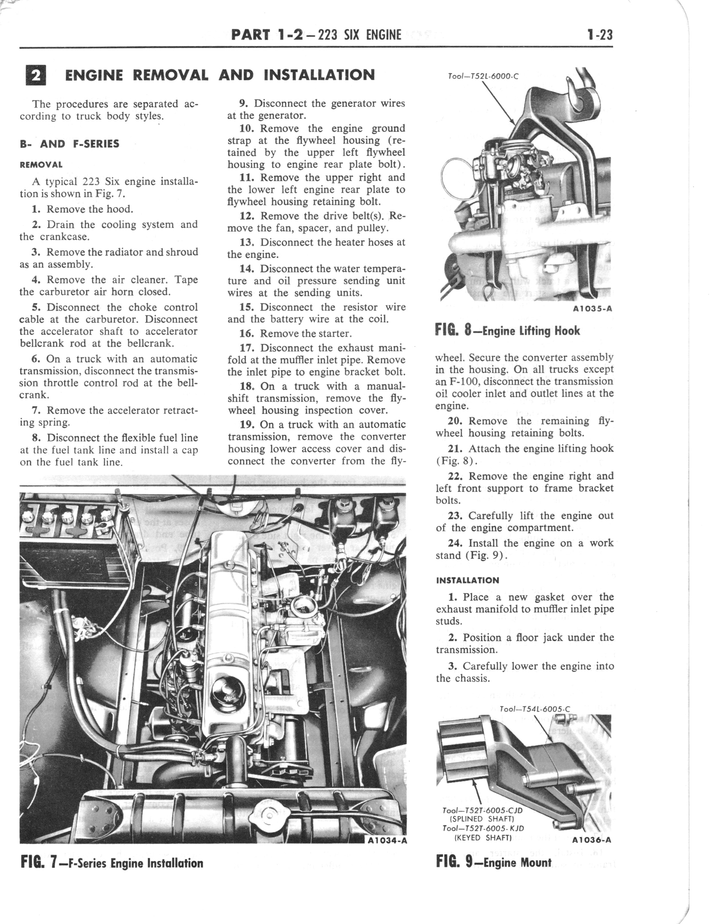

This site is going to be your best friend...
SHOP MANUAL PAGE for 223 Removal
I doubt you will find the special tool listed as Tool-T52L6000-C, but you may be able to fab one.
Good luck!

Welp, that tool would have come in handy. Ha. Thanks for the link.
