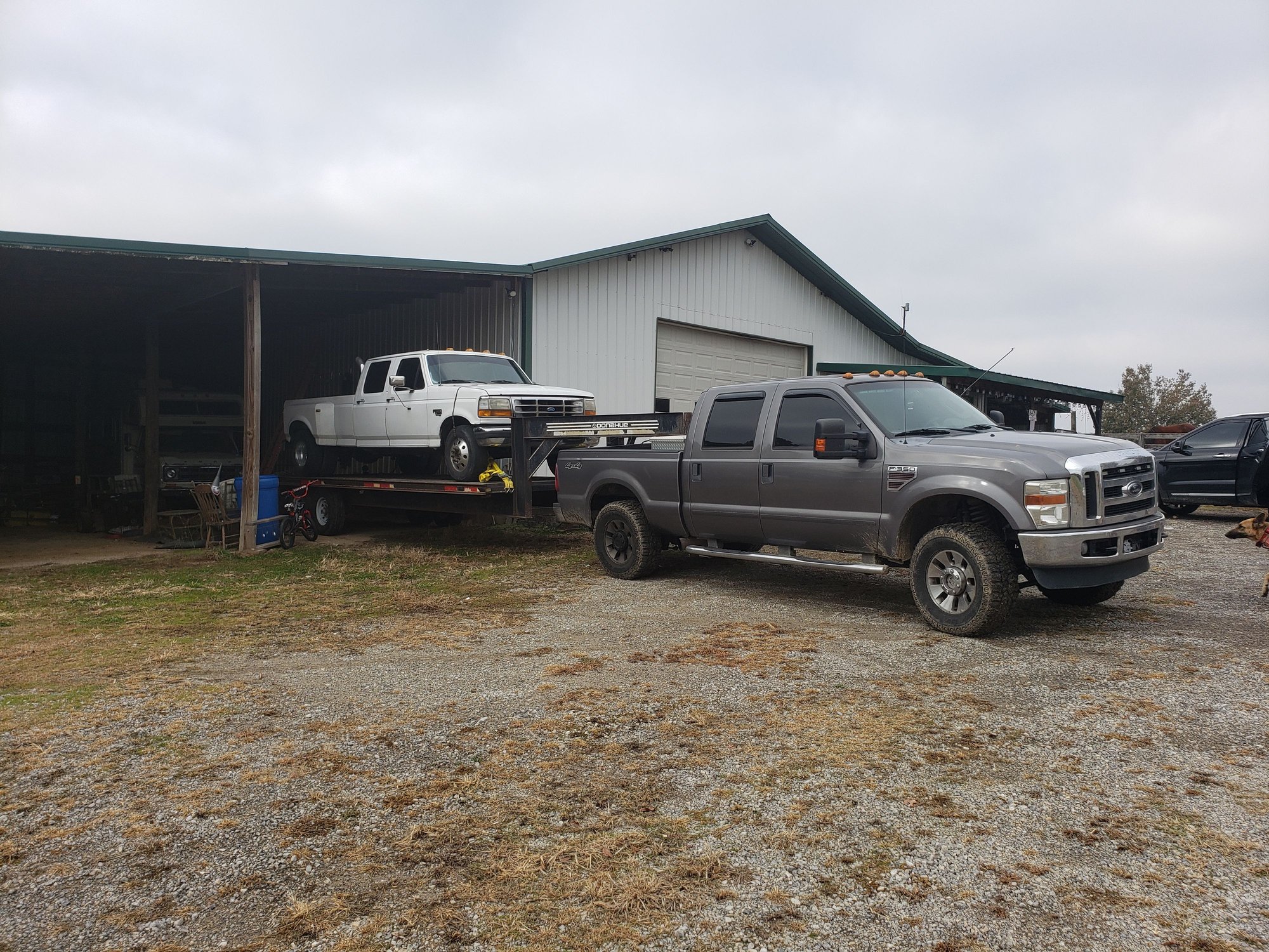

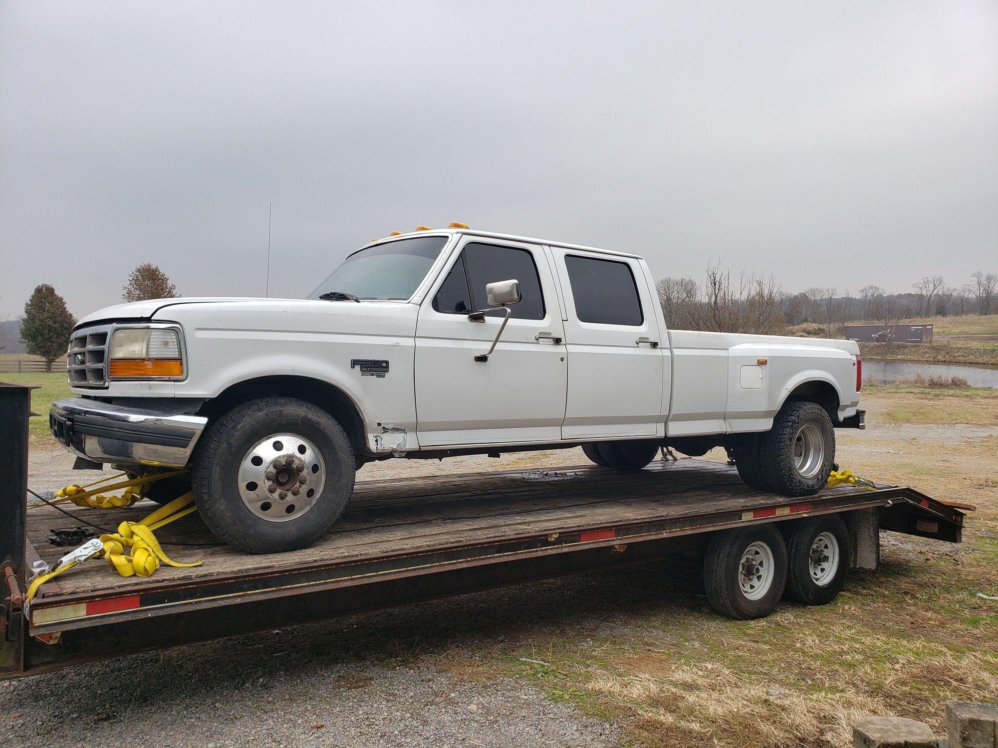

Got her off the trailer today and parts have started coming in! Took some better pictures before I got her off the trailer.

Ewwww, a stack LOL

Yeah, not quite sure how I feel about that one yet. I would never put one in, but since it's already there I may leave it alone.

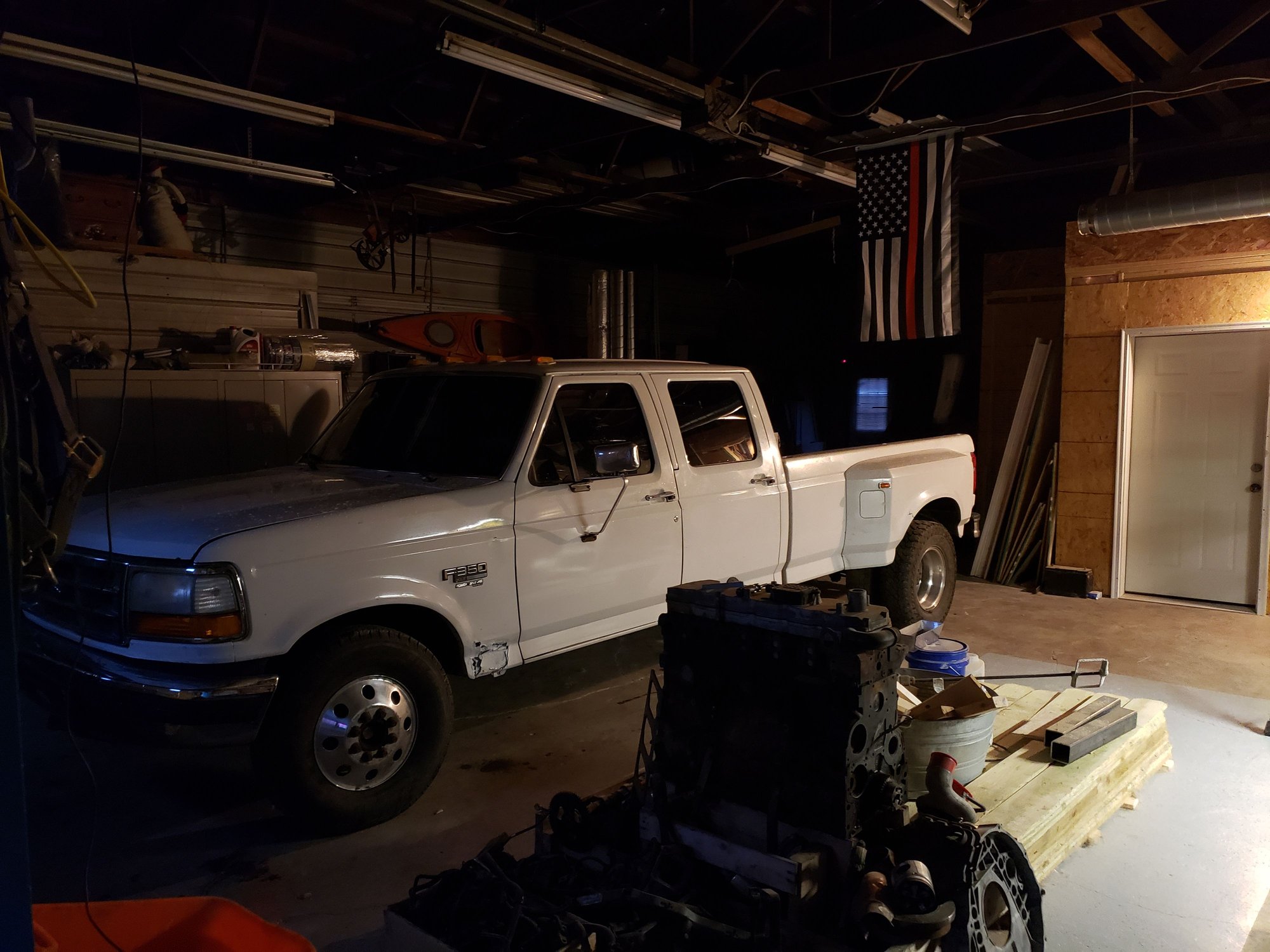

Got her pushed in the garage today. Going to start cleaning up under the hood in preparation for the arrival of my riff raff box

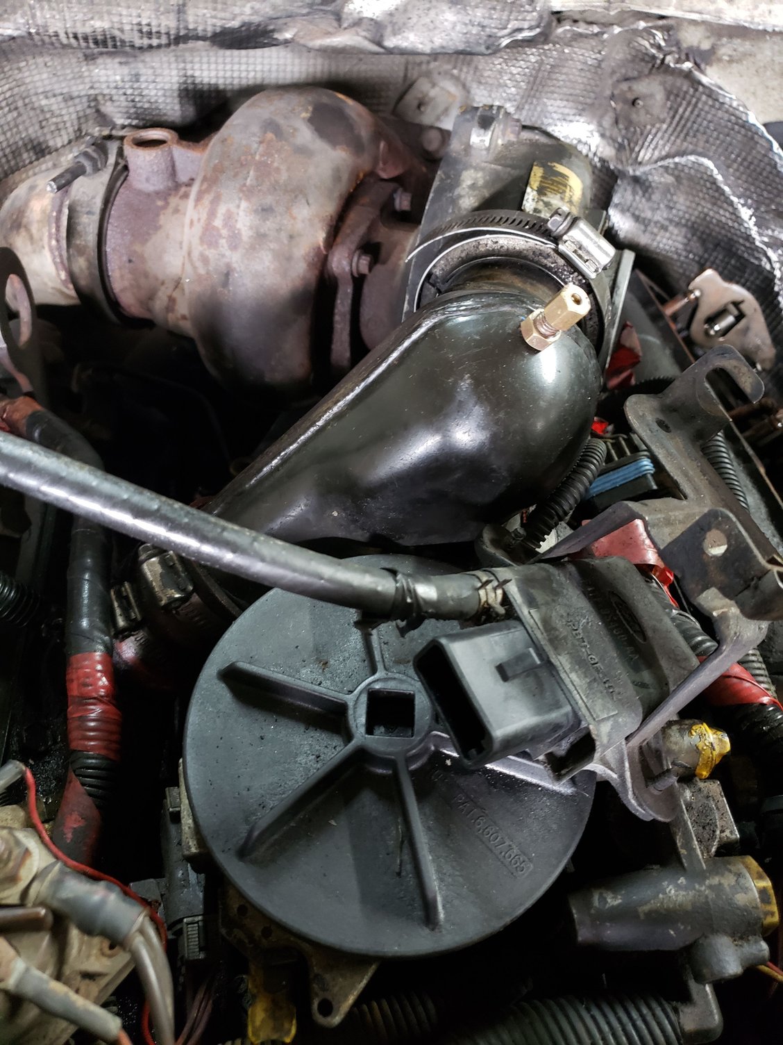

Started working on her today. Took an inventory of the parts that came with it and tried to get a handle on where I'm at, and where to go. I got the valve covers off and cleaned up the injector cup holes. all the old sealant is out and the drivers side is read . Just have to do the passenger.
found a wiring nightmare from some aftermarket electric fans that needs to be sorted out, as well as a yellow wire that runs to the valve cover harness. Not sure why it's there, but I dont like it. It's missing 1 injector oil spout bolt but I already ordered a new on .

Only things I'm not real sure about are the few metal brackets that I found with everything. I'm assuming they co on valve cover studs somewhere just not sure where
