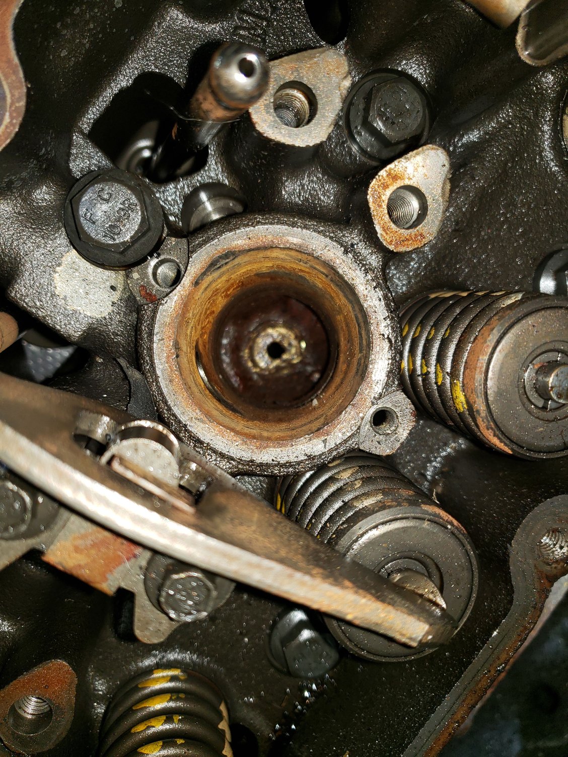

Unfortunately I'm dead in the water until I get another head. Turns out the guy screwed up the cup job on the passenger side and the bottom piece of the cup stayed in the hole. Instead of removing it carefully he went for bull in China shop approach. It looks like the head is deformed where the cup sits along the edge. Even if I can get the cup piece out, I dont think a new one will seal. Anyone have any extra heads sitting around? Lol. Not exactly the news I was hoping for.

Well I started tearing into her. 2 hours to get the head off. Not too bad in my book. I had to make a tool to get the rear fuel line off, but other than that pretty easy.

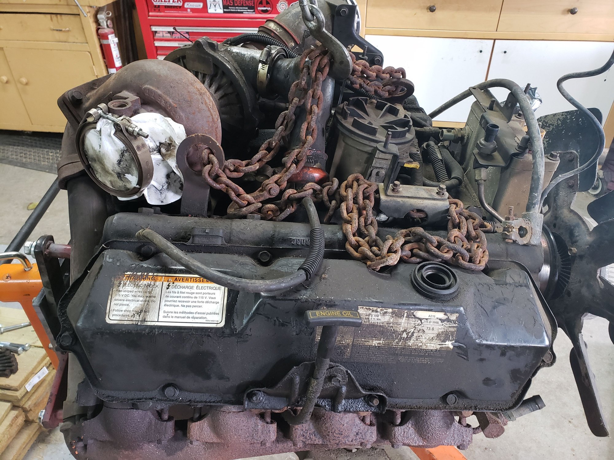

Well I acquired a drop in replacement for my 7.3. I'm told it was running, has 255000 miles on it, and it was pulled because the truck rusted around it and he used the axles for another project. It's been sitting inside since pulled.
next step is to pull my engine and get this one ready to go in. I ordered a bunch of parts to replace common leaks while it's out so once that box gets here I'll start rolling on it. My biggest dilemma is whether or not to do cups since I have them and the motor is out. I've heard that these rarely need cups though, so not sure it's worth the time. I am going to replace the pedestal o rings because there appears to be oil seepage there. Oil pan is getting re sealed while I have it out, and fuel bowl rebuild with new hoses. Plus the new glow plugs I ordered. I think I'll save the new pushrods for the new build
Any input on whether or not to do cups? Any other big ticket items before i drop it in? my other is going to get a full rebuild, so I'm not gonna go too crazy with this one.

I'd leave cups alone if it were me and fix all the common leaks....maybe, MAYBE do uppies since it is out just because it is so much easier and they always leak. Great find man!!! Anxious to see how this goes.

Leave cups alone.
New injector o-rings would be smart. Reseal the pan, they always leak and use the rest of the tube to reseal the plenums. Slap on a Melling LPOP too. Do new ZD11s and that Stancor GP relay. Do uppipes, Riffraff ones are great. Do a delete pedestal. Turbo rebuild is a cheap DIY, $65 I think only. New vacuum pump. New idlers. New water pump. Reseal oil cooler too.
All that stuff will swap right back to the other engine once it is prepped, so you will not lose money on it all.
Also, run a compression test on the one you just bought before doing anything. It still has the early CCV boot which are notorious for splitting and the turbocharger could be chewed up, dusting the bottom end.

Sounds like you are on the right track. I'll echo the guys, leave the cups alone. If you can swing it, get the bellowed uppies from Clay at Riff Raff. If they weren't leaking in the truck it came out of, it could be after you install it, due to maybe being hit in removal or install.

Well its settled. I'll leave the cups alone. I'll save them for the build when I strip the heads and re do everything. I went to harbor freight and got their 2000 lb engine stand. Mine wasnt up to the task. Tomorrow I should be able to start working on things and see what happens. I did get all the stuff to fix the common leaks and I'm gonna degrease everything real good so I can find any future leaks easier.
