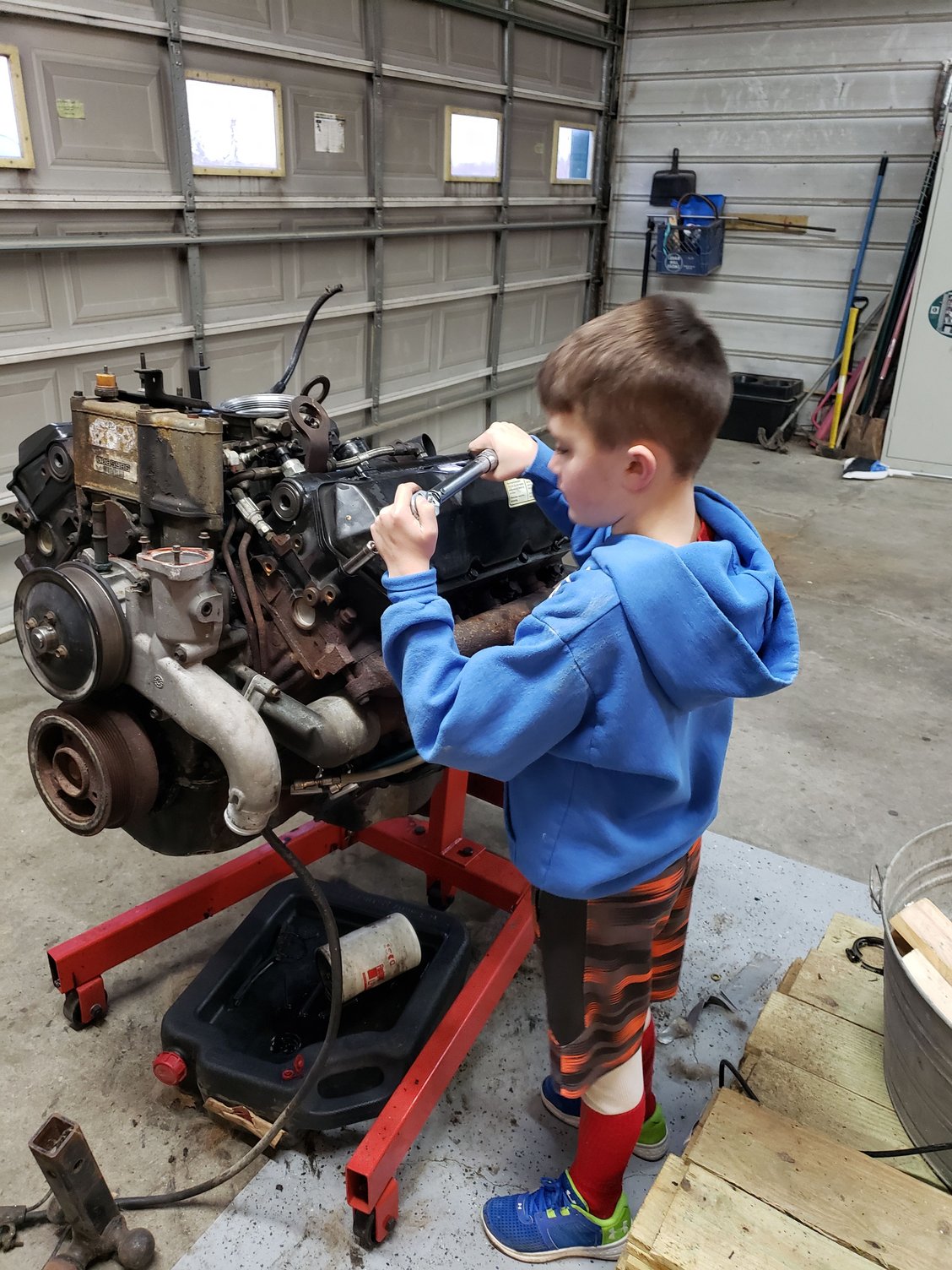

New engine stand. I started cleaning the motor up today. Lots of oil and grime on everything! Couple cans of degreaser should help. I taped off all of the entry points into the engine and soaked her in degreaser.
so far I have removed the turbo. That is all. Trying to get the grease and grime removed before I open anything up. The valley is full of schmutz, dont want to get it anywhere. In 250000 miles this thing sure leaked a lot

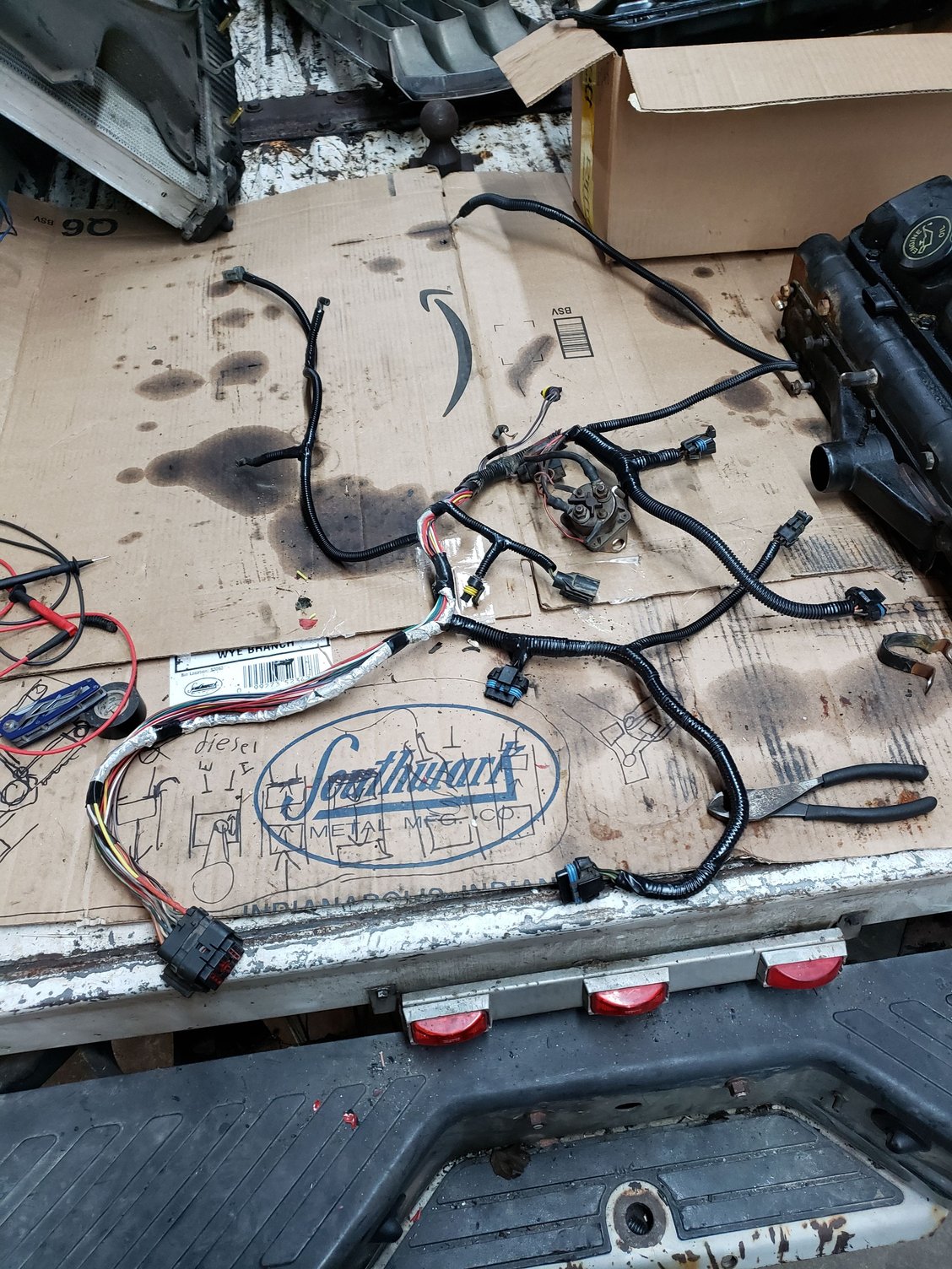

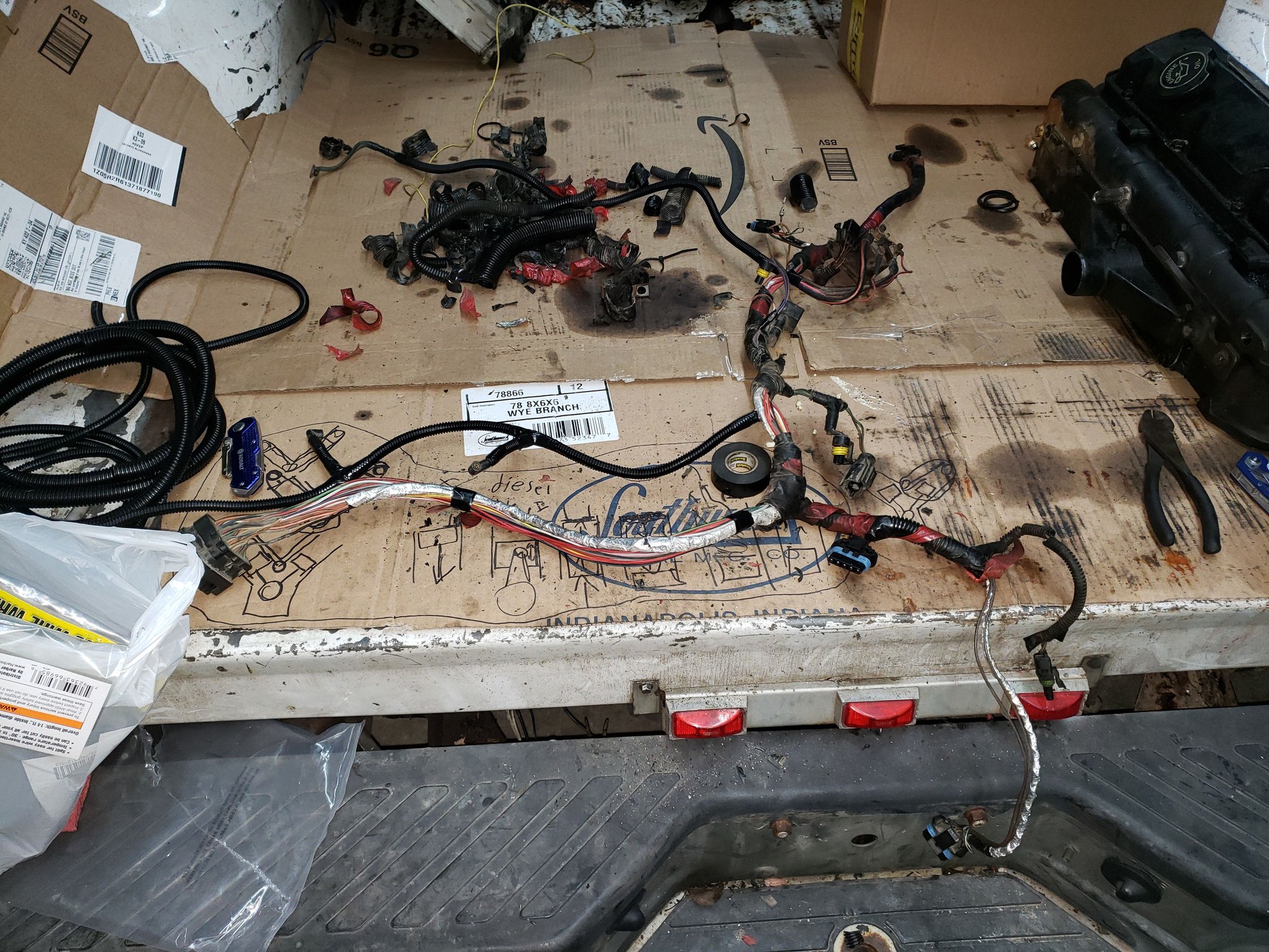

Putting some work in today. Got the motor almost all the way out after a lot of cussing and yelling. Started recovering the wiring harness as well. There was a broken wire for injector 1, so I am digging in to find out where it's broken. I'm also going to run a GPR led mod wire through the harness so it doesnt stick out.

Thanks to the creative enthusiasm of my 7 year old, the broken wire in the harness is fixed and the injector should work without random extra wires in the engine bay now

Thanks! It looks so much better without the jacket falling off of the wiring harness. It looks almost new again. Got the rebuilt fuel bowl and fuel pump on the new motor. Got some other little items taken care of. It's getting there. Slowly but surely

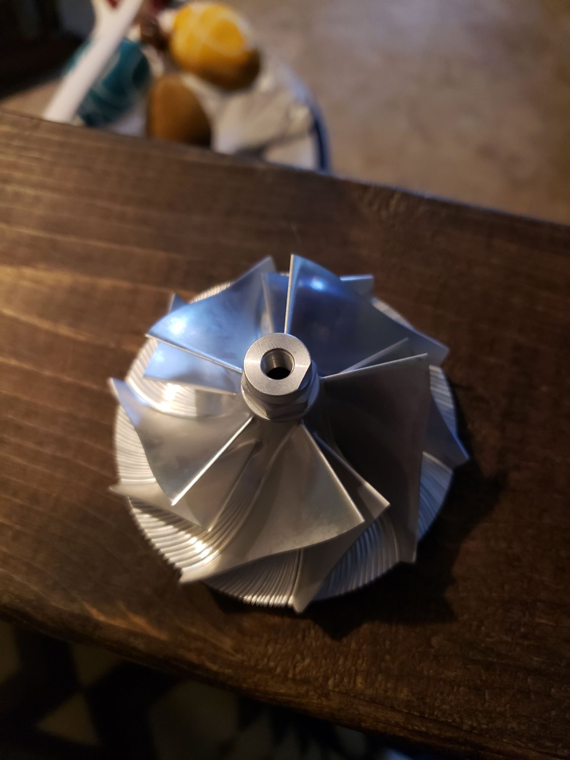

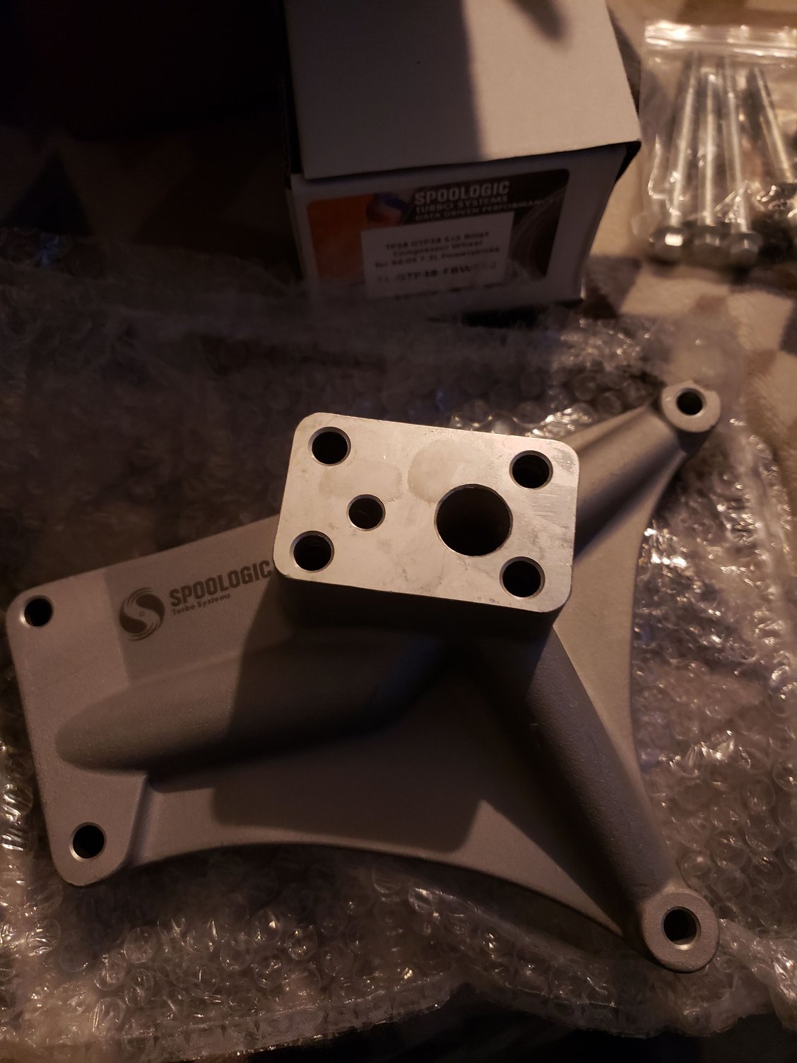

Found a christmas deal on a deleted EBPV pedestal with a deleted housing and all the hardware. They also had a deal on billet turbo wheels...$59, I couldn't pass it up!
Now just have to wait for my riff raff box with my turbo rebuild kit and the rest of my seals and orings and this motor can go in!

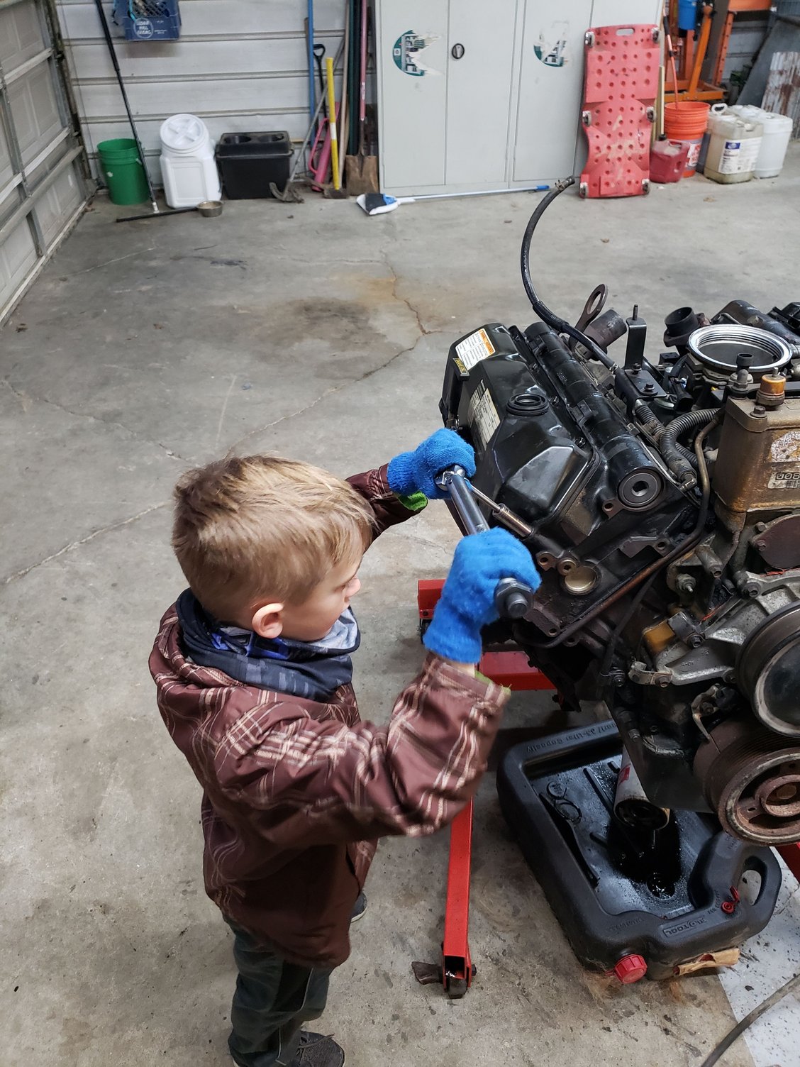

Got some work in on the old girl the last couple days after my box from Clay came in! Some eager young diesel mechanics wanted to work, so we got the motor buttoned up and the turbo rebuilt. Now to finish the wiring harness and drop her back in!
