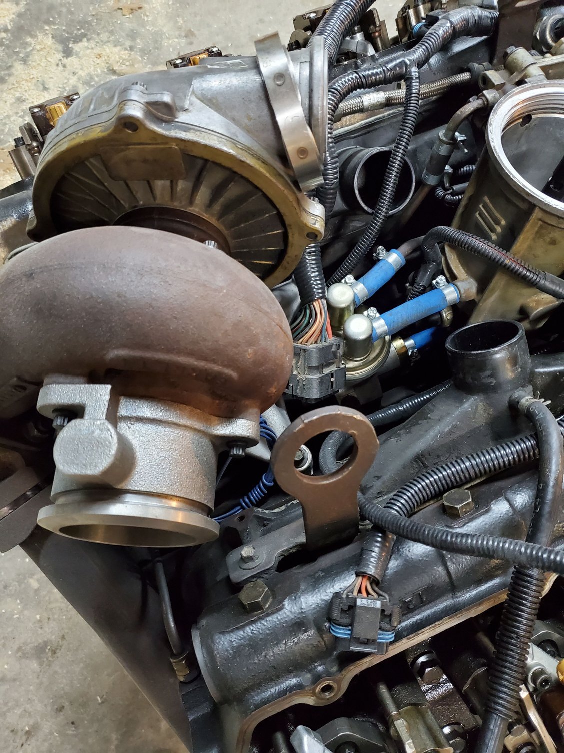

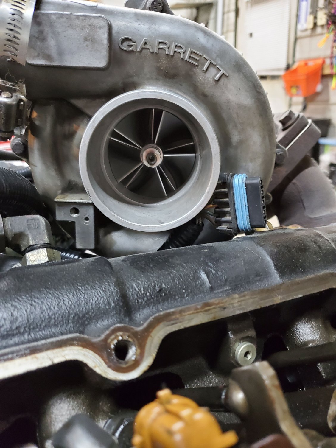

Not sure if you've ever rebuilt a turbo before (I hadnt) bit it was super easy. It took longer to clean it up and get the old RTV that someone put on it instead of an o ring off of the housing. Then I had to pull all of the brass bristles out of my arm that came out of the wheel haha. I soaked the new parts in oil overnight so it could work into the holes. All in all it was super easy, and mine was definitely worse out.

After a lot of work and a bunch of parts, shes ready to go back in! Got it off the stand today to put the flexplate on, and my neighbor is coming tomorrow with his bobcat to drop it i .
FWIW, OBS TP38 turbos never came with a housing gasket, the factory use sealant.
Old Feb 16, 2020 | 08:21 PM
  #75
afmedic's Avatar
afmedic
Joined: May 2015
Posts: 1,029
Well I guess it was probably the factory build then! It has an oring now!
