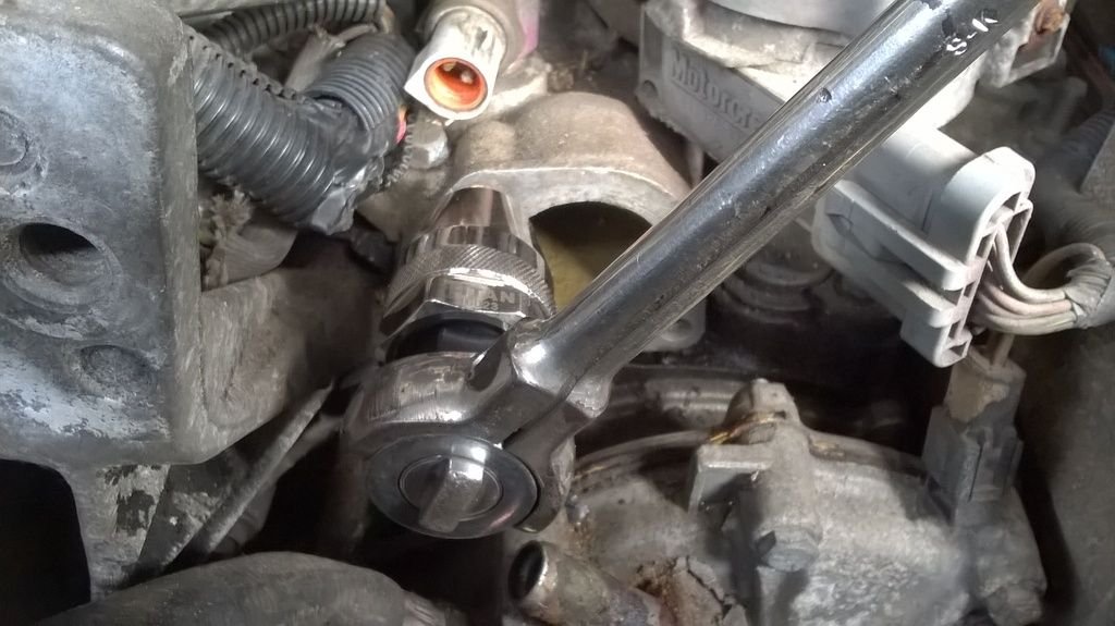

Well, here are my photos of shame.

I spoke with the extractor fellow today on the phone and he did not recommend welding on the stud. He said he has seen this before and the aluminum boss is so small that it tends to melt/disintegrate if welded against.
My dad, a mechanical engineer, thinks that there is plenty of stud there for welding a nut to, and that the aluminum should dissipate the heat for just a few seconds of welding.
Another possibility is if they "clear the deck" and remove the distributor and the rest of the mess on top of the manifold that you might get a vice grip on it and be able to turn it out.
Worst case they will have to pull the manifold and that is going to be about an $800 mistake.
I've had the RV towed to my usual shop.
What an f-up!
Steve

Good news, my shop had the stud man come out and he was able to extract the stud. Wish he had come to my house to figure that out but anyway, it's out and the shop is going to button everything up for me.

I don't know what else to add that might help with your problem but,, the next time you break off a bolt and a little is still sticking up, you might try this tool.
It works like a drill chuck except it has some really sharp jaws that lock down on the bolt and has left handed threads so that it tightens down as you turn it to loosen the bold you are trying to extract.
I broke a thermostat housing bolt off when changing my thermostat. Less than a 1/4" of the bolt was left sticking out but it was eno9ugh for the tool to grab hold of and it came tight out.

Yes, I tried a stud extractor, but they only work down to 1/4" studs, and this is a 1/4-20 stud. It ripped the threads off and then the stud was too small to be gripped anymore.

Got it back. $330 to remove bolt and put everything back together.
