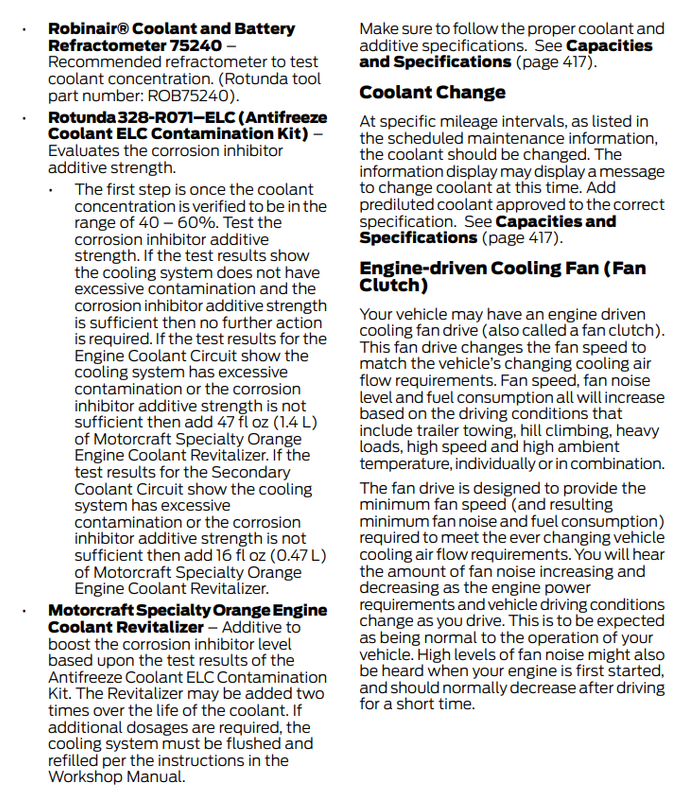

Gotta love how Ford doesn't update their documentation. This is from the 2019 6.7l owners manual. Other on this forum have reported the newer 6.7l use yellow coolant.
Yellow coolant launched in 2018, info at 1:40

it lists the coolant for the gas engines only. It does show fluid capacities for the 6.7 diesel but not coolant type. Says to use the Orange one for gassers. Frustrating.

Looks like it was somewhat of a mid year build switch, which is why it may not be updated to reflect in the owners manual. I remember years ago when the 6.7 was still fairly new the local Ford house put on a class for the new engines for local mechanic shops and it was stated that the new orange coolant is the best thing since sliced bread, so I can only imagine how amazing the new yellow stuff is

When we picked up our 2019 F-350 (In October 2018) the documentation included an updated card that called out the new coolant (Yellow). The printed owners manual still showed the old spec for coolant (Orange).
