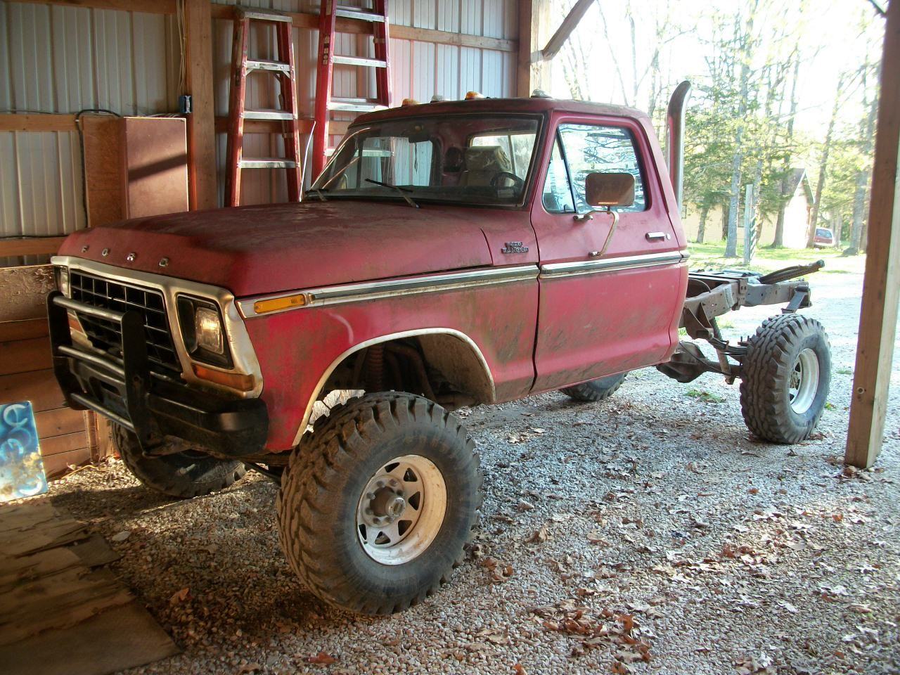

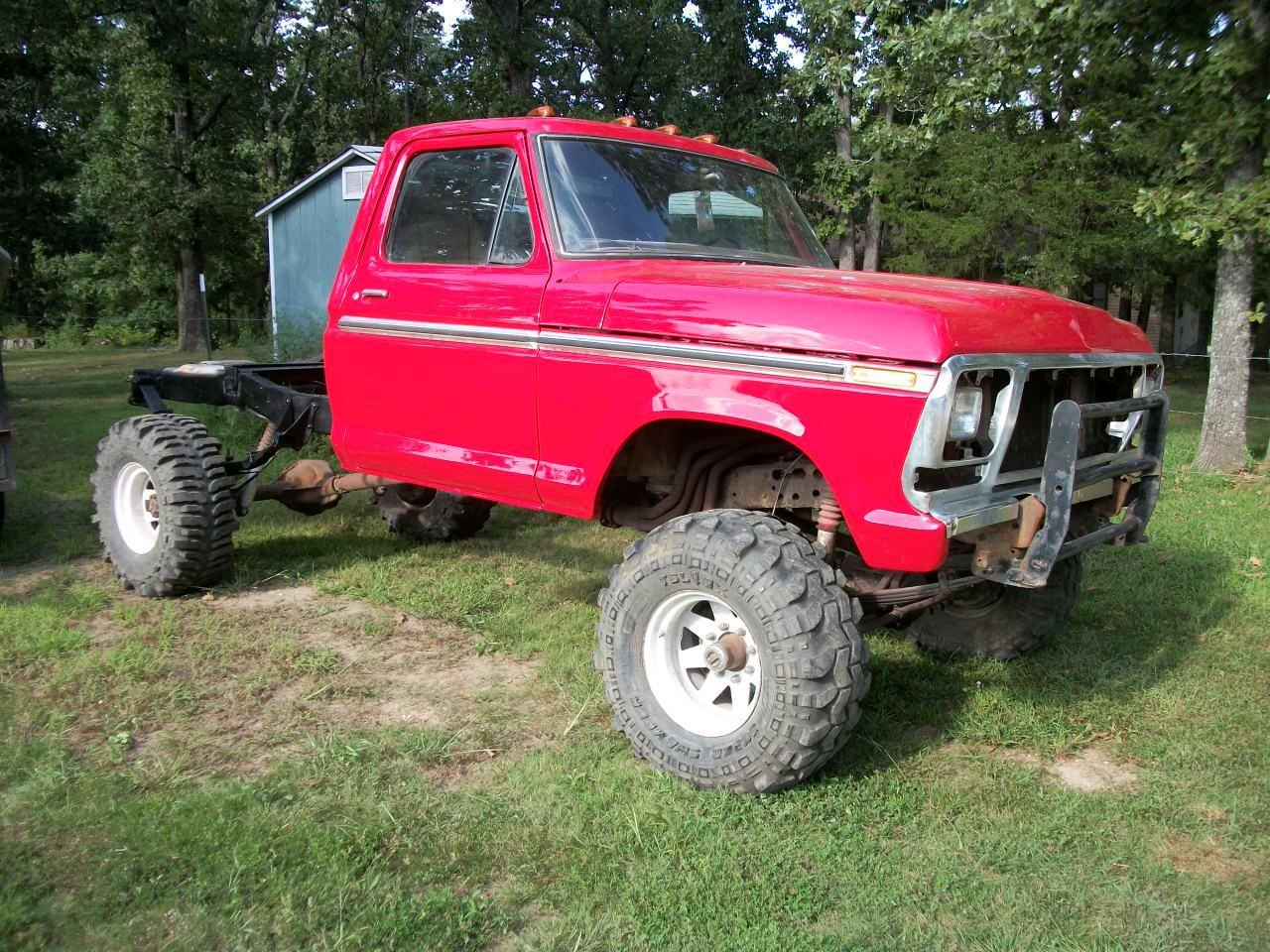

Let me reiterate...sharpie mark around the hinges where they bolt to the hood (to help with re-installation) and REMOVE THE HOOD! Makes for a way lighter front clip. Yes my ol red mud truck has the hood flipped back on the roof...I took it off by hand, by myself, besides its a mud truck. Well it was....bottom pic is it now days. It's getting there.

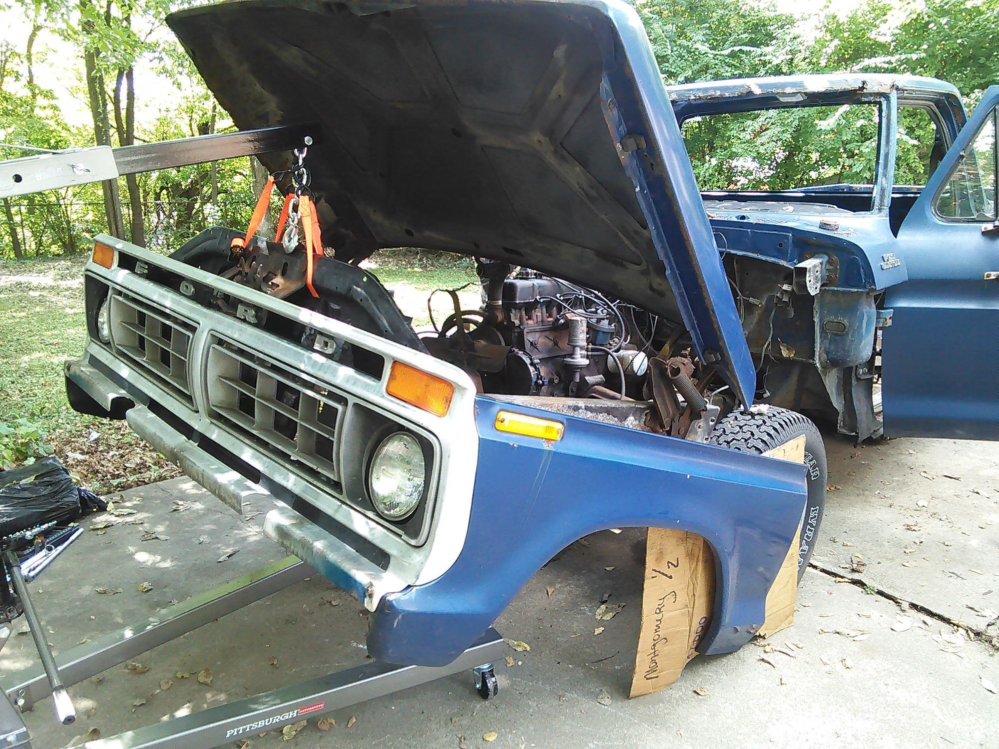

My process:
Start my draining coolant and radiator unless you want to take the radiator off the core support and leave it with the engine, Disconnect upper and lower hoses, remove battery, label and disconnect all wiring coming from center cab to engine, disconnect wiper resivoir, remove engine ground (if not grounded to chassis)
1. Mark hinge locations on hood and remove hood.
2. Mark location of inner fender mounting brackets on cab. Remove 3x bolts per side.
3. Detach rubber straps attaching inner fenders to firewall (in wheel well if you still have them)
4. Unscrew lower fender bolts attaching fenders to rocker panel (collect any shims that fall out and keep)
5. ATTEMPT to use every extension you have to loosen radiator core support mount bolts
6. Get frustrated and use sawzall to cut radiator core support mount bolts.
7. Find friends or engine hoist to lift off front end.
8. Sit on a bucket and marvel at the days accomplishment while drinking a beer.
9order new core support bolts and bushings.

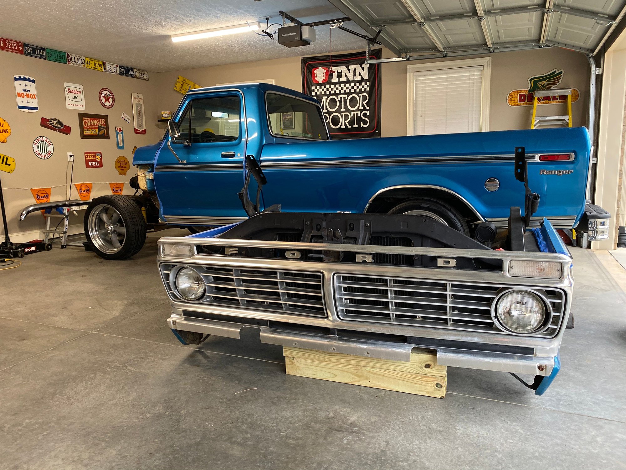

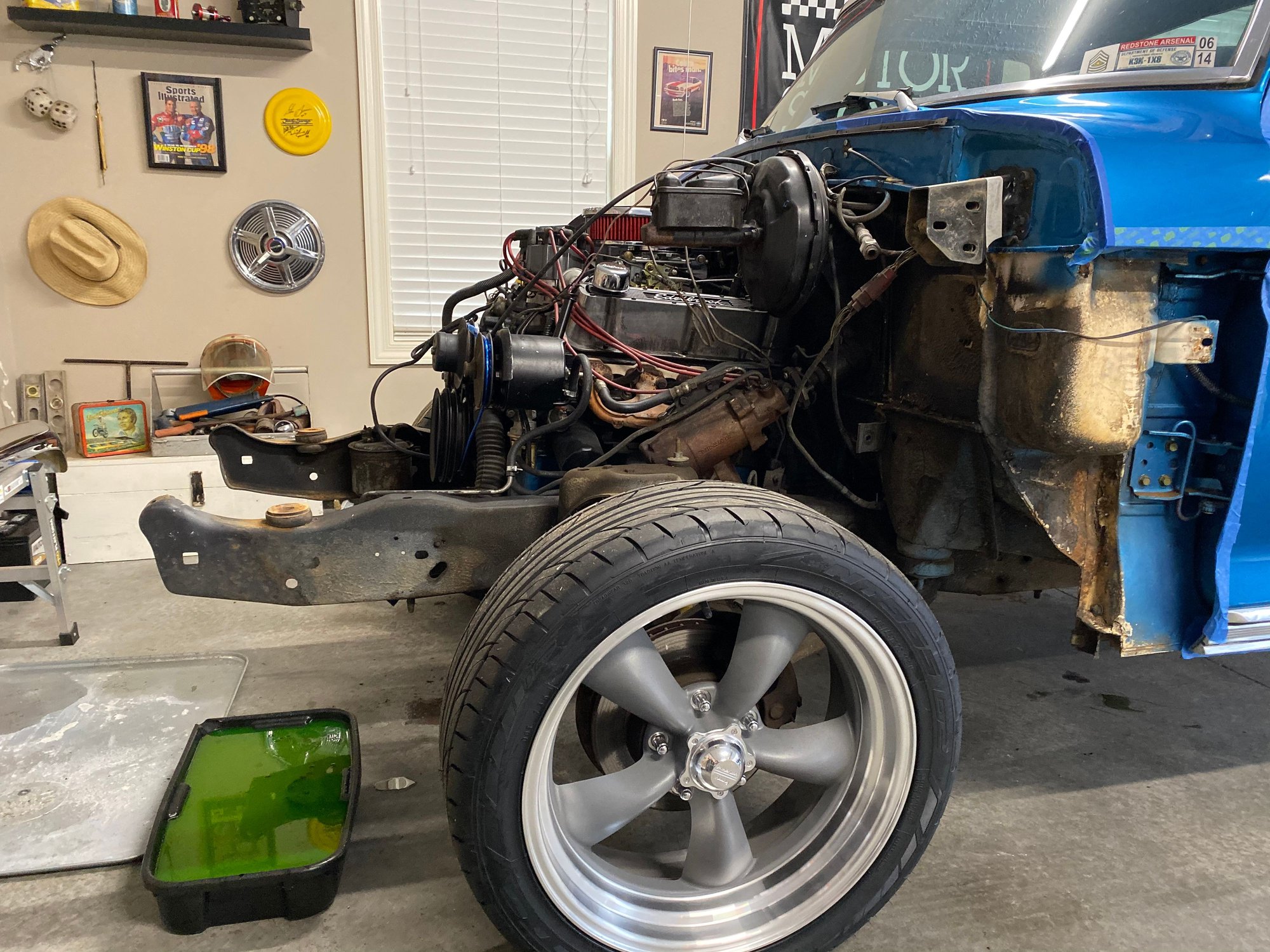

Here you go
FTE LAW:
LOL
Old Nov 12, 2019 | 03:41 PM
77&79F250's Avatar
77&79F250
Moderator & parts slinger
Posts: 50,186
Likes: 5,792
I would of left the brackets on the ends of the inner fender wells and sharpie marked around the fire wall and removed them there. None the less, its off in one piece. Now is a great time to get in there and do what ever you need to do that warranted the removal of the front clip, and then detail the motor and the inner fenderwells. Nice looking truck.

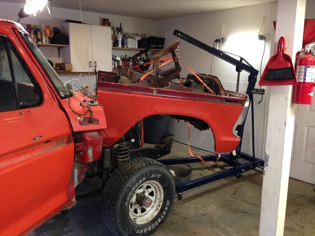

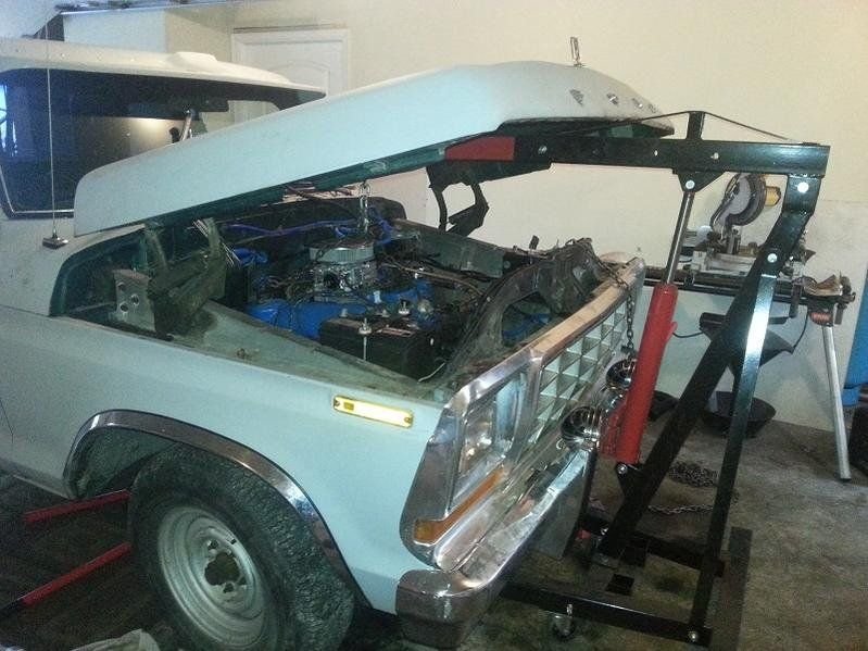

A trick a fellow FTE member uses.
KenEdwards
Sep 6, 2019 03:15 AM
sean9049
Mar 21, 2016 03:02 PM
BigB9000
Apr 3, 2015 10:24 AM
BACAGrizz
228
Feb 20, 2013 05:33 PM
danorules
2004 - 2008 F150
Feb 18, 2013 11:34 AM
