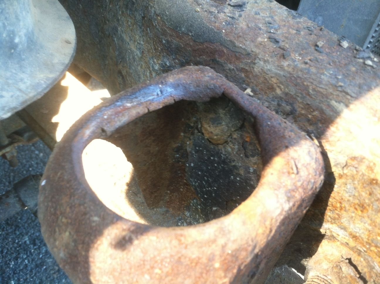

todays progress
got the core off in about 4 hours, a very rusty fustrating 4 hours.
i guess this is why my drivers door was hitting the fender lol
needless to say i ordered new ones..
are these the shims or parts of the dead bushing ?
Old Mar 21, 2016 | 03:02 PM
mcali2's Avatar
mcali2
Joined: Aug 2013
Posts: 1,691
From: Fallon NV
Wow, did to hold together ? Mine has rust but I hope like heck its not that bad on the frame bracket. I feel a little better but not much..
